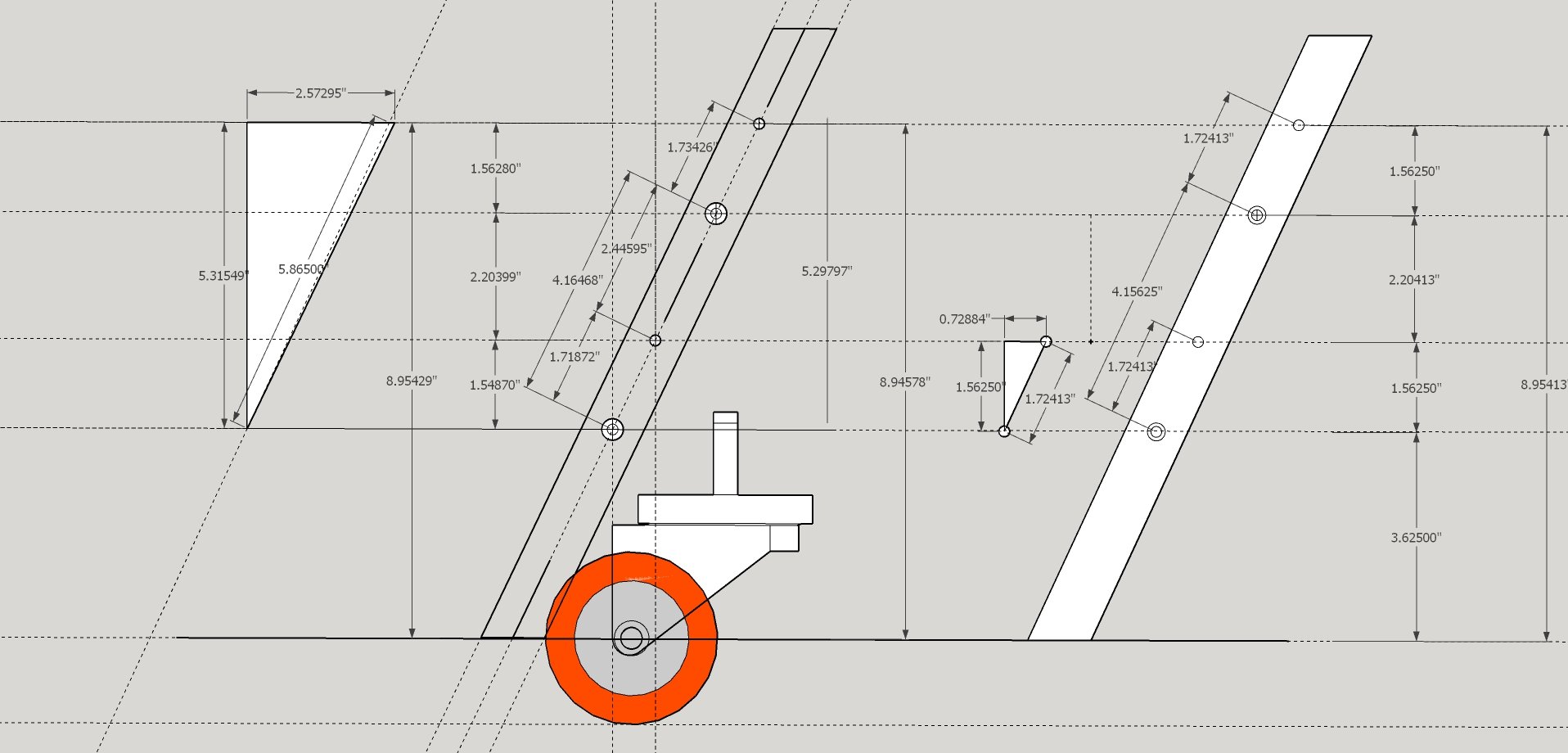

RFGuy wrote: Thu Jan 12, 2023 1:57 pm
dusty wrote: Thu Jan 12, 2023 12:50 pm I agree wholeheartedly that when the wheels are up the machine must rest FIRMLY on the ground. Obviously, to far up voids the lift and thus the purpose of thr wheels. Strike a happy midground..
Dusty,
Just an fyi...but the SS premium casters have quite a bit of play in them. For example when I checked mine yesterday, yes mine are firmly resting on the ground BUT there is no weight on them. I could easily push on the wheel to "cant" them inwards because the swivel mechanism allows this. I am just pointing this out that straight vertical measurements here will only get you so far because the casters when not bearing a load can deviate off of the vertical axis quite a bit. In other words, this may or may to be accounted for in your measurements/drawing. Until there is some preload on the casters, the casters have quite a bit of side-to-side play but can still be firmly on the ground, yet not bearing any of the Mark V load.
Yes, if there is no weight on the casters/caster assembly there can be a deal of movement.That free movement dissipates immediately as soon as the wheels begin to bare a load.
I have a leg with caster assembly and 3" wheels setting here on my work table. This was where I gathered the dimensions. I had hand pressure on the wheels when the measurements were taken.
Had to do it this way. I can no longer count on getting up off the floor if I got down close enough to take those fractional measurements.
2" caster installed without redrilling the leg
Caster 3 inch.jpg (80.45 KiB) Viewed 3390 times
The legs are part of of the iitems going to sand blasting and powder coat soon to become a new Shorty.
Caster Template (NEW) 1.12.jpg (127.71 KiB) Viewed 3385 times

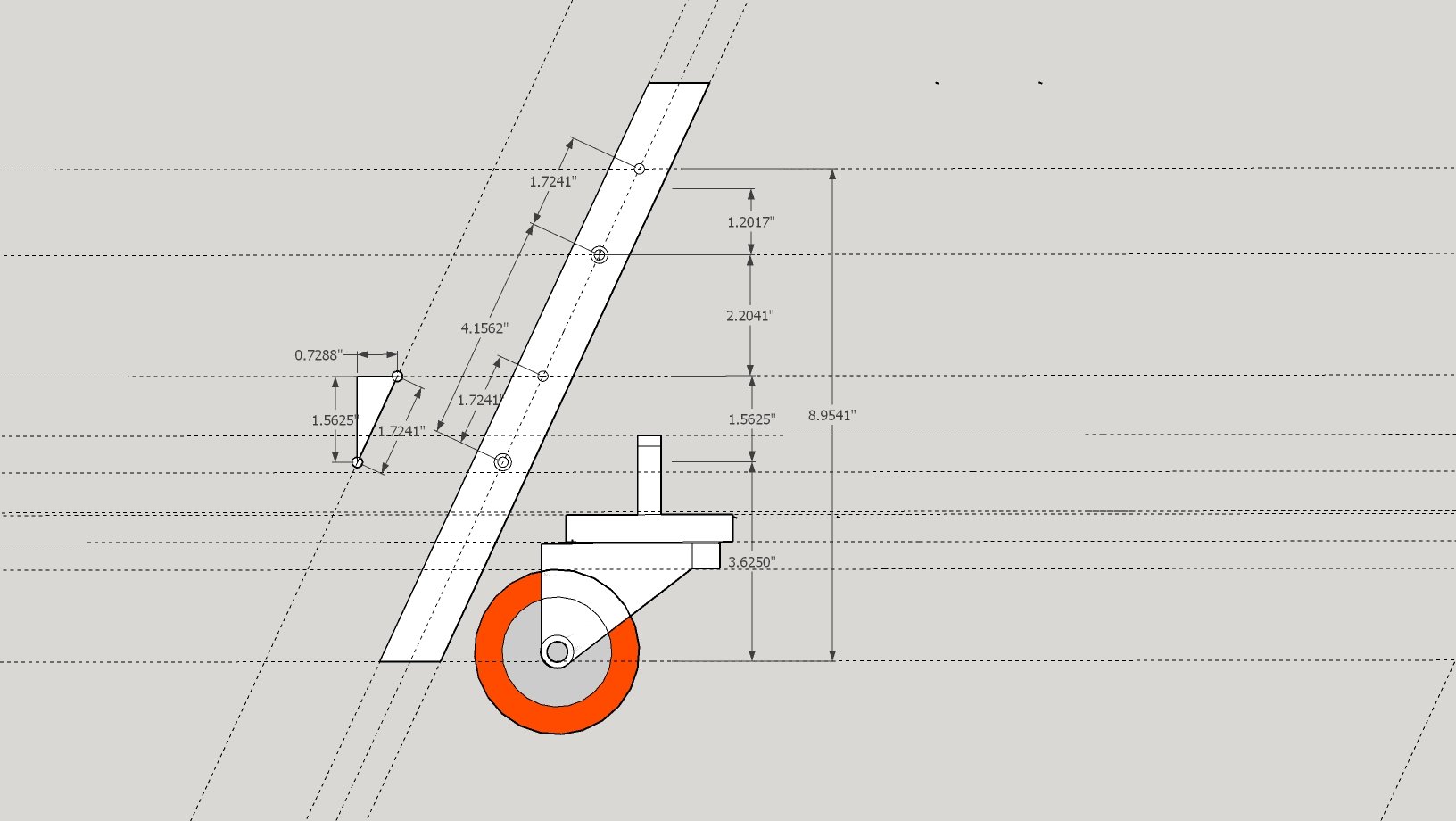

Re: 3" caster upgrade
I made some changes (very minor) and changed to fractional notations. I create these sketches using decimal measurements and forgot to change to fractional before I posted.
Caster Template (fractional).jpg (153.58 KiB) Viewed 3371 times
