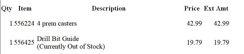

dusty wrote: Sun Mar 05, 2023 6:36 am What was the part number.
I dug through my emails and found it. I ordered the 3" premium upgrade casters at the end of 2018 and below is a copy of my invoice. The template jig is called "Drill Bit Guide" and the part number was 556425. I strongly recommend anyone interested in the upgraded casters from Shopsmith to call them and ask specifically for this part number and see if it can be resurrected. IMHO it was well worth the $20 for it.
📶RF Guy
