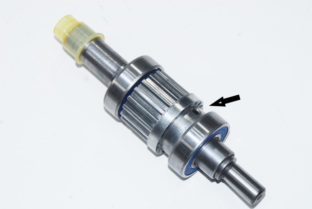

The 2 bearing Quill is for the Poly V Drive Quill. The Quills are not interchangeable. To have a 2 bearing Gilmer Drive Quill requires machining one. David mentioned a part that was added to later Gilmer Drive Sleeve Assemblies. A nylon collar was added to the Quill side of the Drive Sleeve Assembly as first shown in the 10-56 6th edition of the Owner's Guide. You can see that nylon collar on the Drive Sleeve Assembly in the picture below. This Drive Sleeve Assembly is the later clutch version which may be different than yours if you still have the original non-clutched Drive Sleeve Assembly that came in your 1954 Mark 5 from the factory. The arrow shows where the set screw is on the clutched version and the set screw on the non-clutched version is in the gear teeth.
_ .
The clutch was added to the Gilmer Drive Sleeve Assembly to allow slippage in the drive system to help avoid breaking belts.
