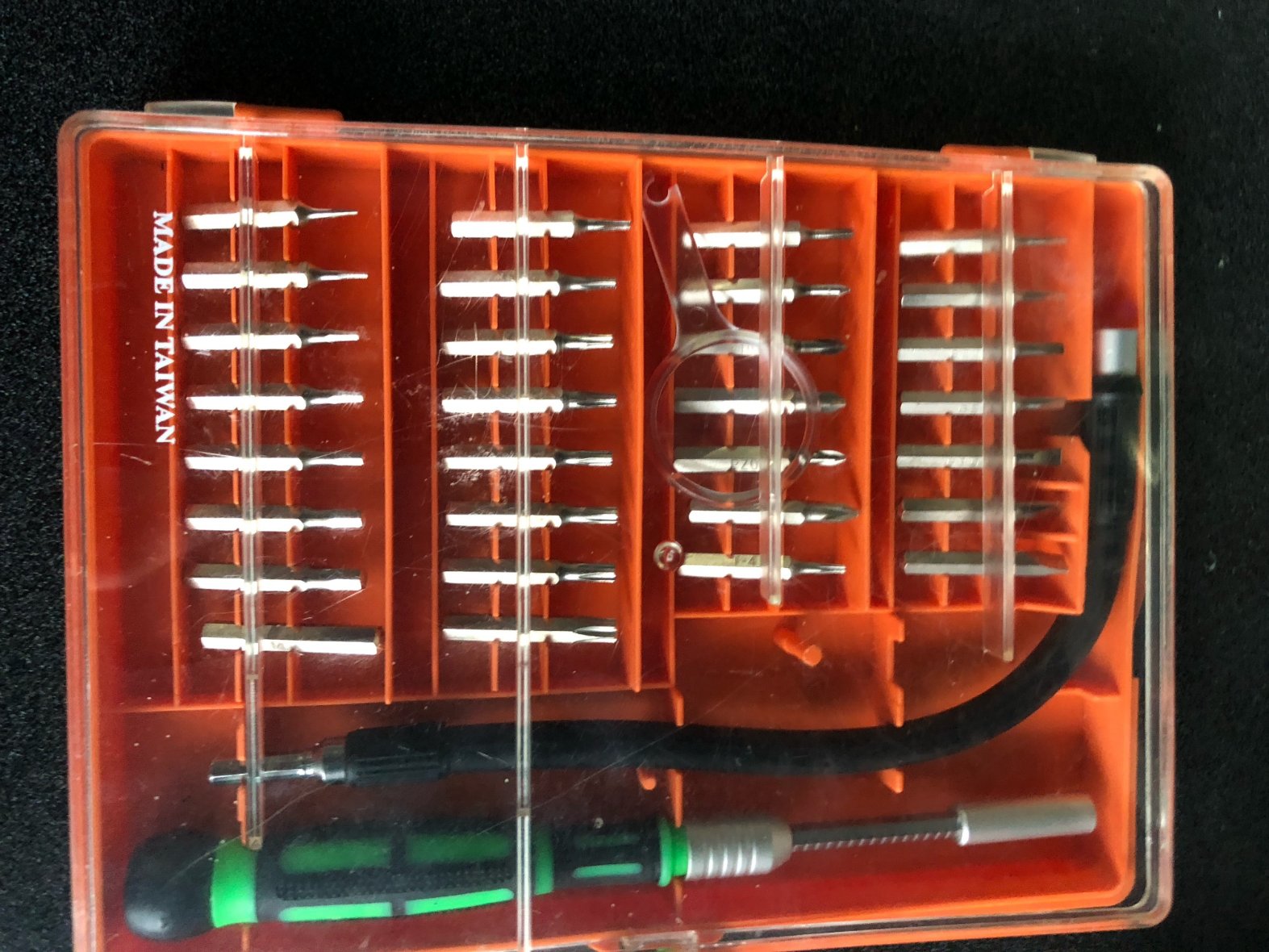

Just a heads up folks. I bought a Mark V shopsmith in 1984. I've done various upgrades thru the years. Long story short, I currently run a Mark 7 and upgaded to the power pro headstock. I save all the old Mark V parts and bought the Shopsmith Shop Deputy kit. I've finally got around to the build of the deputy and discovered that I removed the set screws from the casting base (why I did that is still a mystery to me :-( ) page 6 of the install guide tells you to insert the shorty way tube and tighten the set screws. The problem is the pivot rod does not allow you to get a straight shot at the set screw hole. If you try to force it, you will strip out the hole threads because it will cross thread. If that happens you pass go, don't collect $200 and proceed to shopsmith jail (shopsmith hell ... your choice). Good luck trying to find a 40 year old replacement casting. I won't bore you with the gory details, but the 5/32" allen wrenches are fine once the screw is set. The way I got around this is with a tool kit I bought a million years ago. It has a 5/32 allen attachment and flexible tube that you can turn left or right by turning the base of the driver. I was able get the flexible shaft under the pivot rod and get the set screws to thread. Note to self, do not remove set screws if only loosening them gets the job done. The required set screw are 5/16" x 18 x 3/8 . You can use longer set screws but I wouldn't go shorter. Adding a photo of the toolkit. I don't remember where I bought it and the only words on the thing says it was made in Taiwan.

I do have a tap and die kit, but this flexi attachment let me use the original set screw holes so I'll go with that. I'm pretty sure I'll never pull the way tubes out of the shop deputy and even I do, I'll just loosen them. I will view your link as I am intrigued with how you skinned this cat. Thanks for the info!
