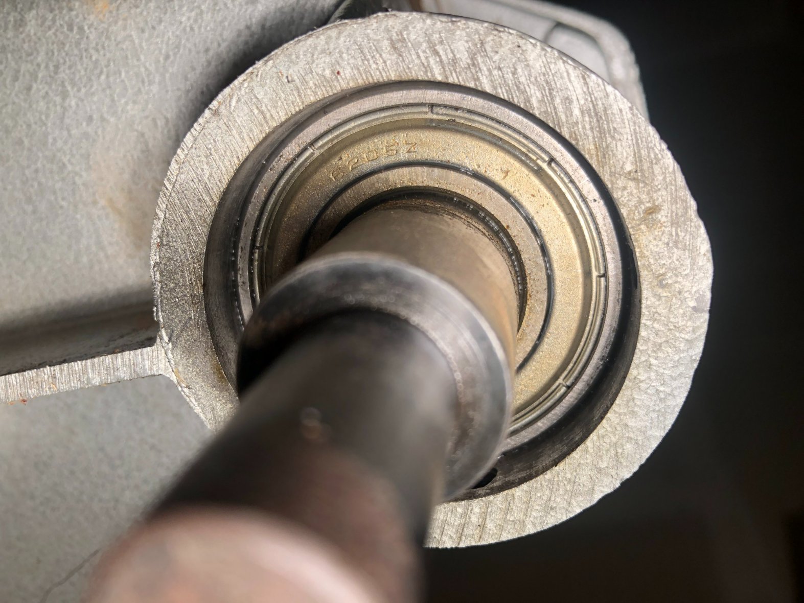

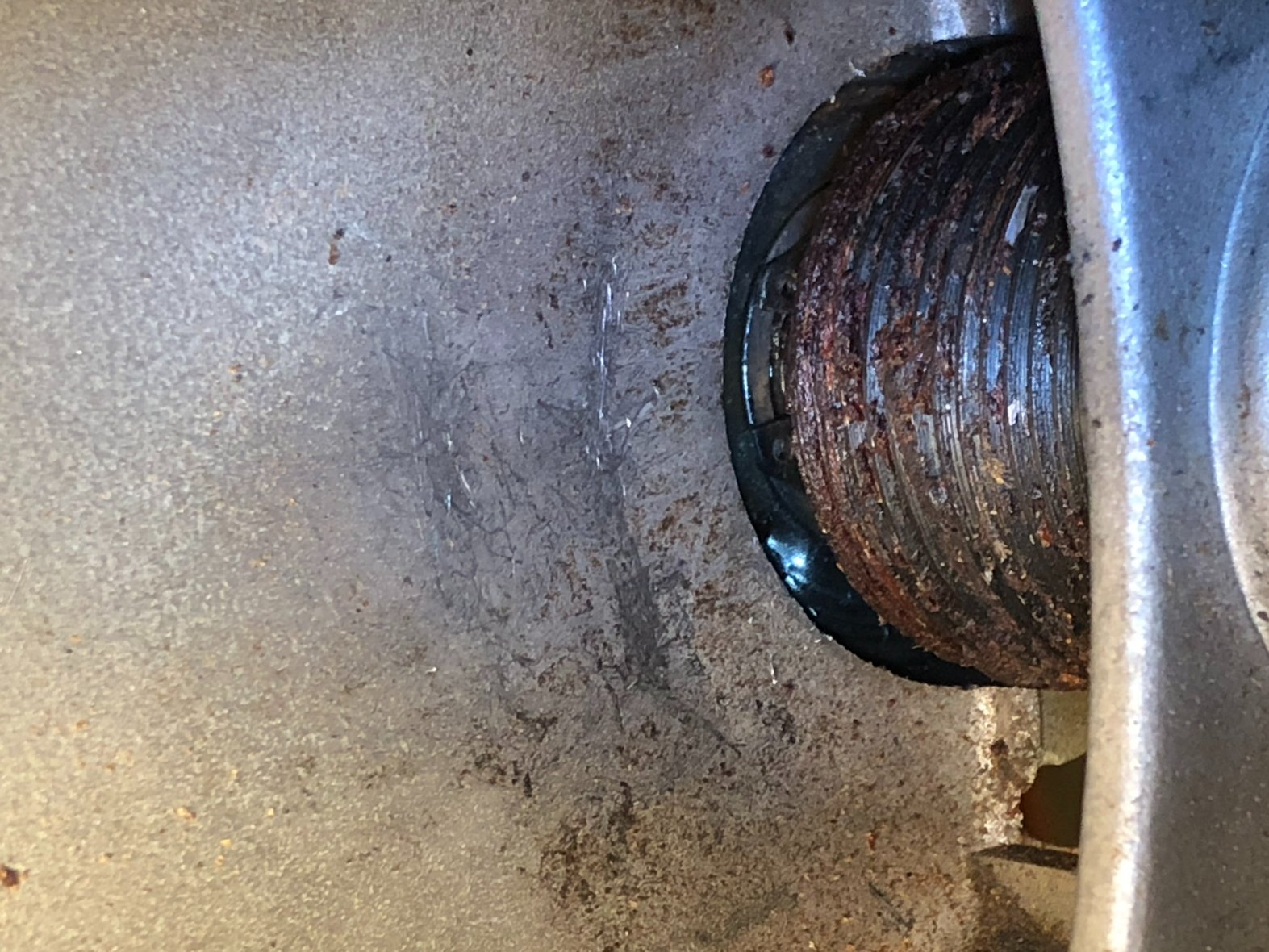

What does the interior end of the drive sleeve look like>?

I removed two locking rings on the other side. They were not in easy customer friendly places which makes me doubt i was suppose to do that.

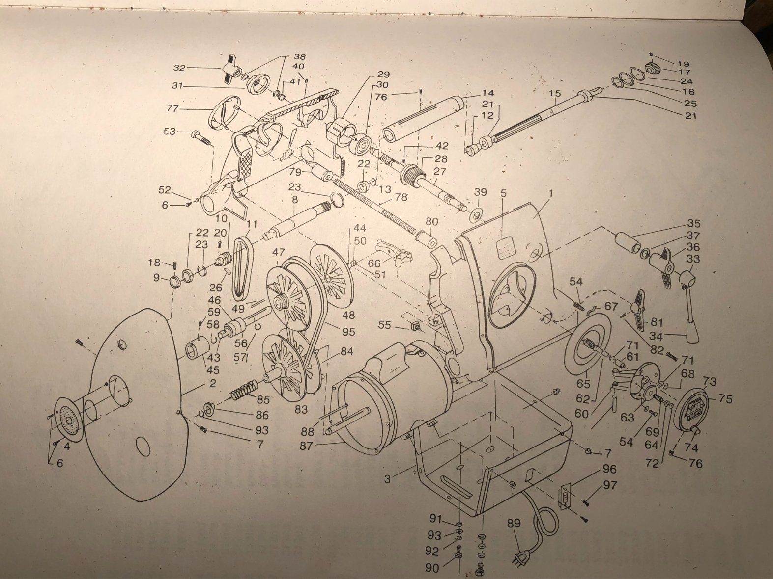

I'm pretty sure it has to come out in one unit like the shopsmith. Looking at the schematic, the shaft changes diameter in a few places that would prevent it from being seperated from the bearings unless they are all out of the head stock together.
The unit is from the 80s, i dont know how many different models of total shops where made. Based on the schematics i took a picture of i have removed everything that i can.

Does it look like part numbers 18, 20 and 76 are set screws on the top side of the quill through the casing? If so these would prevent the quill from moving. I know the SS has one in about the same area as the part number 76 is located to keep the quill from extending too far. The same period SS head stocks had that set screw covered so they could not be removed or adjusted by accident.

The two part # 23 COMPLETELY removed? Looks like no in the pix.

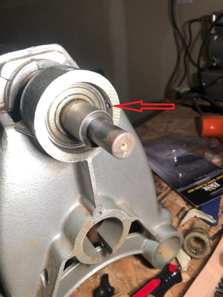

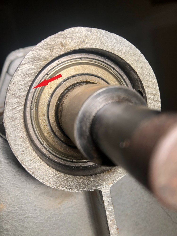

Was there something in the hole indicated by the arrow in the copy of your picture below? It looks like there is another hole at the top of the Headstock casting too.
_ .
I cannot tell from your pictures but is the ring indicated by the arrow in your second picture below part of the bearing or is it a retaining ring? If it is part of the bearing's outer sleeve, which I suspect it is, then something else holds the Drive Sleeve Assembly in place. The Headstock casting itself keeps the Drive Sleeve Assembly from going further into the Headstock as shown in the pictures of your second post.
_ .

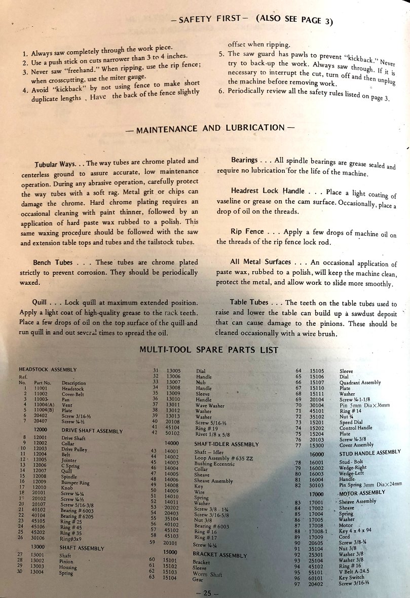

Sorry if this doesn't help but I have never owned one of the Shopsmith clones. The picture of the exploded parts drawing you posted is not very clear for the Drive Sleeve Assembly and what holds it in place. The parts list may help in identifying the parts we are looking at. Comparing the Total Shop drawing to a Mark 5 exploded parts drawing from the mid-seventies these Drive Sleeve Assemblies and related parts look different.
_ .
_ .

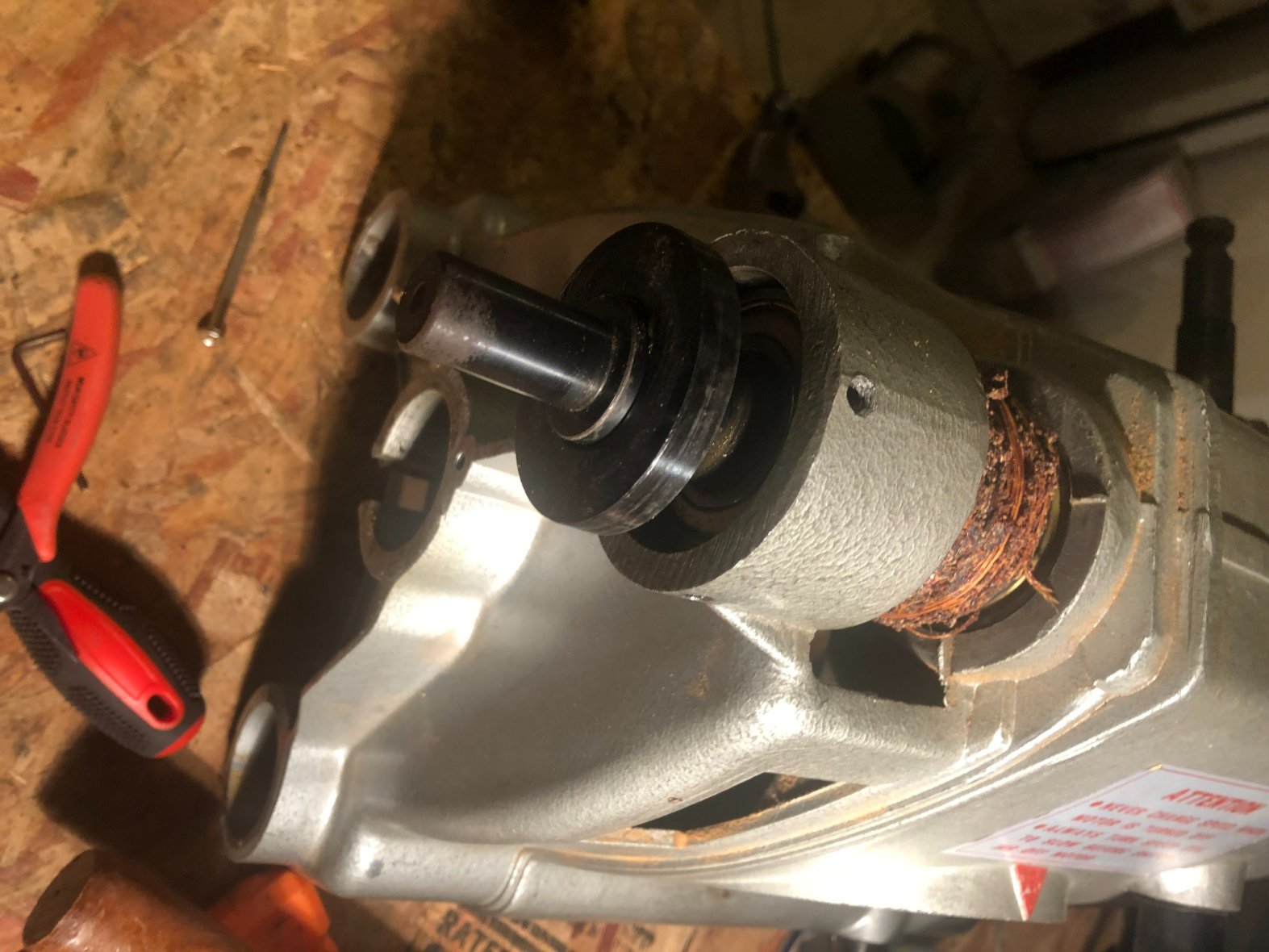

18 was taken off, that was securing 9 (a collar) that was flush with the headstock. it might be the origonal peice holding
the drive shaft bearings and drive shaft assembly in place, i fear everyhing is just stuck with age now.
(i have included a picture of 9 below)
i have not seen 20, it may be covered in grime and gunk. though it doesnt look like it would be holding the drive shaft assembly
in place. i look like it would be holding just the belt pully in place.

your second arrow is indeed pointing to the bearings outer sleeve

76 was removed very easliy early on and was nessesary for keeping 14 and 15 in the machine.thunderbirdbat wrote: Sun Mar 26, 2023 12:36 am Does it look like part numbers 18, 20 and 76 are set screws on the top side of the quill through the casing? If so these would prevent the quill from moving. I know the SS has one in about the same area as the part number 76 is located to keep the quill from extending too far. The same period SS head stocks had that set screw covered so they could not be removed or adjusted by accident.
in the picture no, but it is snapped up now and no longer locking anything in
there was a piece that was in place and flush with the face of the machine (see picture below). It might be the original piece holdingchapmanruss wrote: Sun Mar 26, 2023 1:29 pm tuxedokman,

- part #9
- IMG_2885.JPG (234.7 KiB) Viewed 9754 times
- Part #9
- IMG_2942.JPG (222.48 KiB) Viewed 9754 times

- other side of manual
- IMG_3012.JPG (248.74 KiB) Viewed 9754 times

On the 2nd photo of the top of the casting, there are a couple of flat spots along the seam just to the right of the belt cutout. These flat spots remind me of the set screw on top of the SS when it was filled with putty and painted over. Is it possible that a set screw is hiding in one of them?
