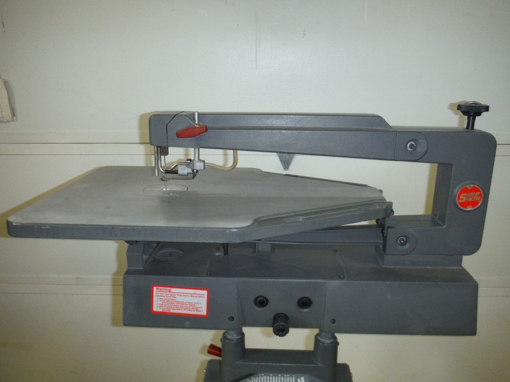

The picture below show a gray Scroll Saw with its original parts.
_ .

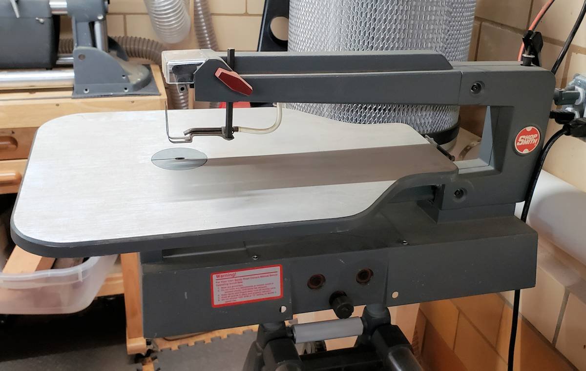

Below is a gray Scroll Saw with the Upgrade Kit installed
_ .
The picture below shows the upgrade upper Blade Block installed.
_ .
