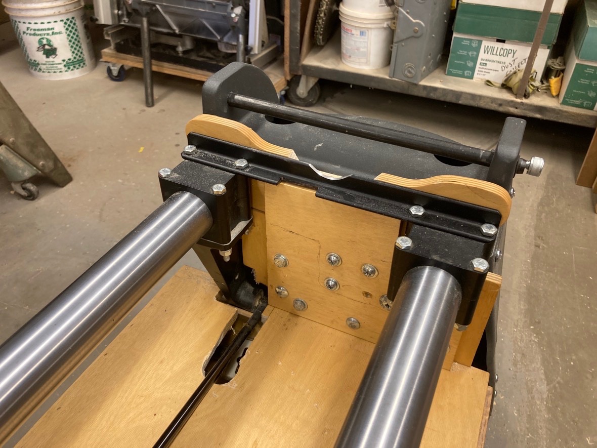

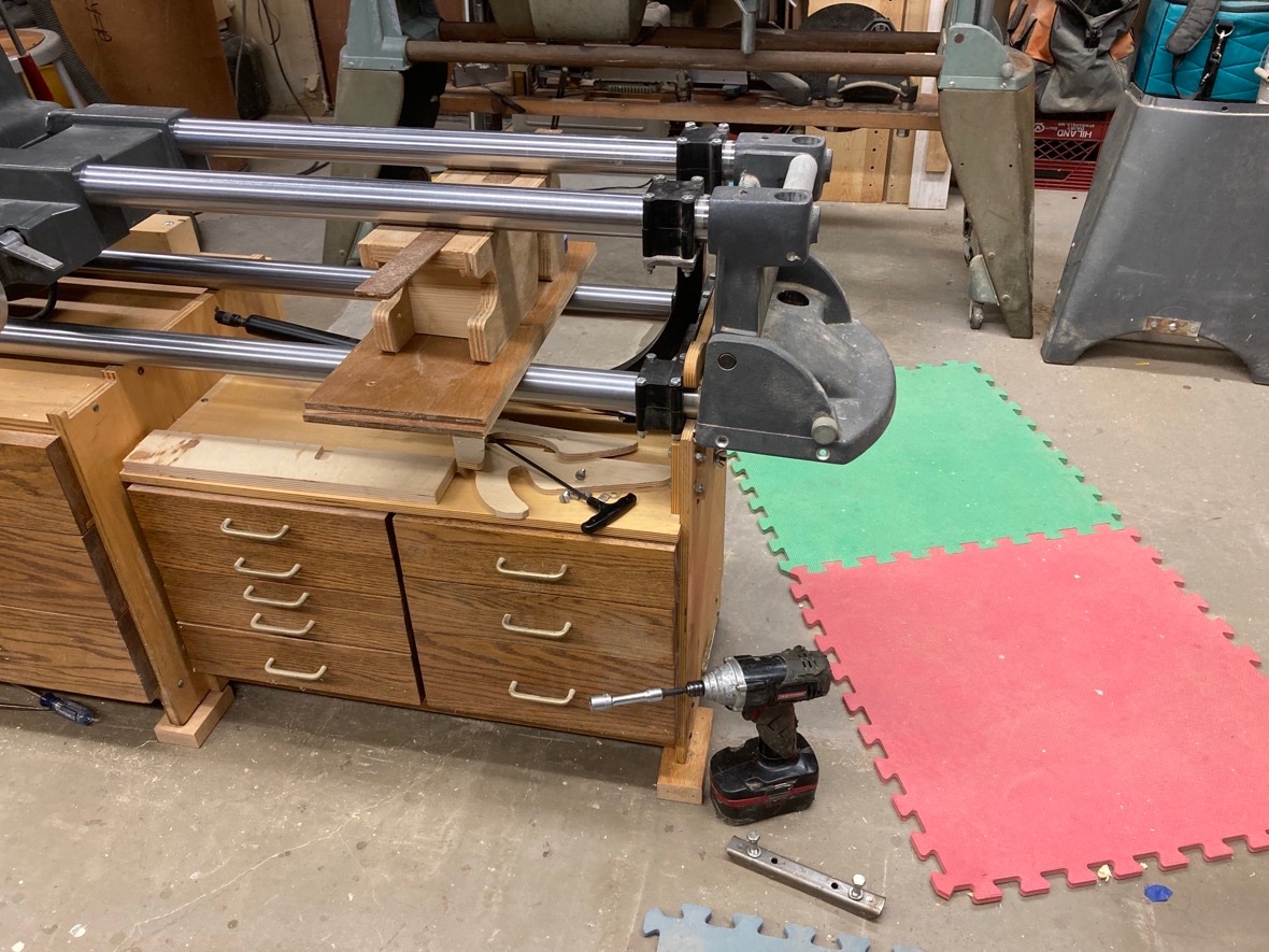

Bought it in March last year, finally found my round-to-it and started installation yesterday and got done today. I didn’t want to dismount my storage cabinet so I set it on blocks so the legs would be clear and changed one end at a time. Happy with how it turned out. I had to do some modifications where the lift assist mounts.

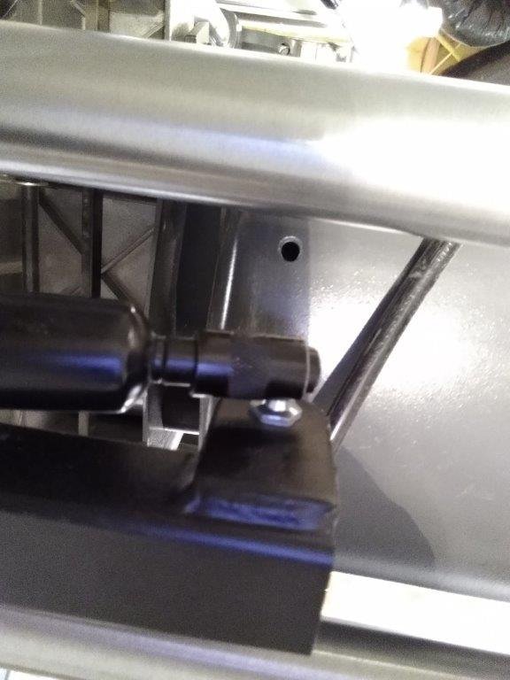

I have the double tilt and lift assist on mine.
For whatever reason I have a lot of difficulty with the quick disconnect on the lift assist ... unhooking it, and hooking it back on.
So I dont think I ever use the left side of the double tilt arrangement anymore.

I picked up a used machine that had been upgraded with Lift Assist, PP, and DT (etc.). The Lift Assist must have been done first, it is not the version for DT or PP, and doesn't have the quick disconnect. It has the PITA disconnect. Perhaps yours is the same? An upgrade is available from SS, but I just took mine off. Perhaps someone can post a close-up picture of the quick disconnect and you can see if that's the issue. I think there have been several variants of mounting hardware but as far as I know the upgrade piston is compatible with all.

Here is a pic of the one I have. Youre supposed to draw that gnurled knob to the right in the pic which allows for easy disengagement.

bainin wrote: Thu Jun 15, 2023 1:59 pm Here is a pic of the one I have. Youre supposed to draw that gnurled knob to the right in the pic which allows for easy disengagement.
That's different than mine and therefore, I'd guess, correct for PP machines.(?)
