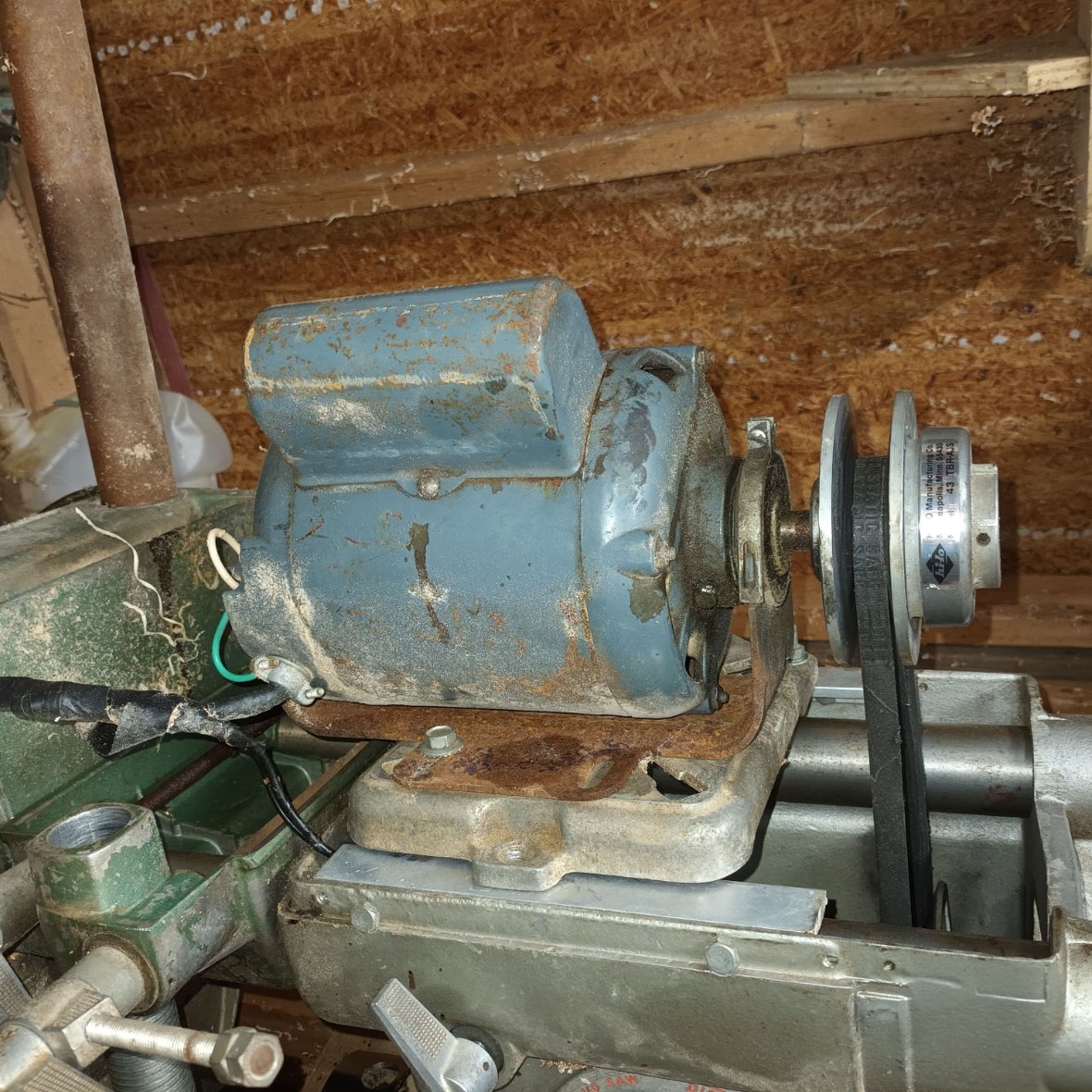

Someone gave me an old (cogged belt) Shopsmith about 20 years ago, and it has been collecting dust ever since. I recently bought a G3 chuck for it and made 6 or 7 bowls. I found that is worked fine at lower speeds, but the belt would slip at higher speeds. I found that a previous owner had replaced the motor using a standard sheave. To account for the changing belt length, the motor plate is only held on with 2 of the 4 bolts. This allows the motor weight to keep tension for about half of the speed range. As soon as I realized what the PO had done, I ordered a new motor sheave from Shopsmith. Since I am seeing that everyone mentions one of two motors, I am wondering if I can make the proper sheave work with my replacement motor. I also only bought the sheave, but I'm guessing there are more parts that I should have gotten to make the system work.

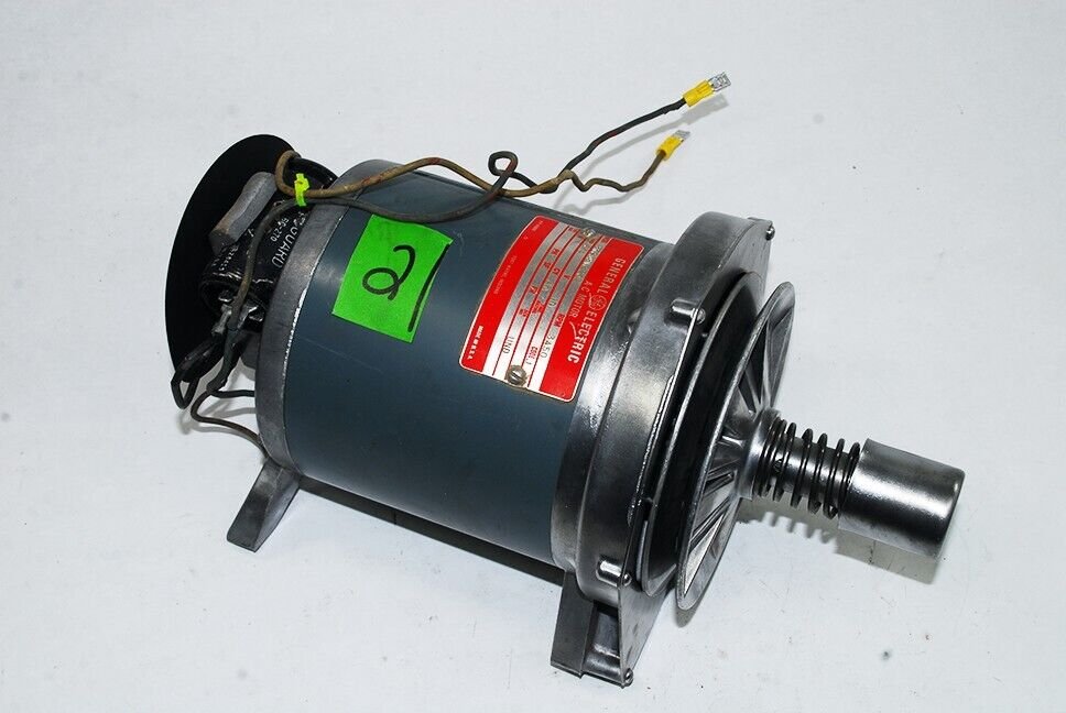

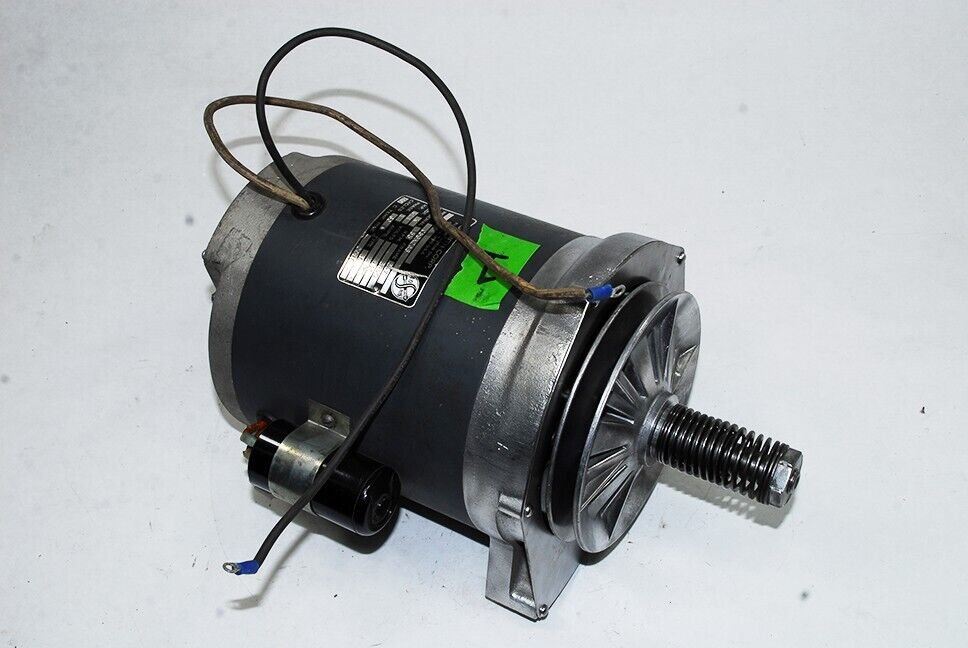

I am guessing it is a Mark 5 Greenie from the 1950's or an early Goldie Mark 5. They used the Gilmer Belt as opposed to the Poly V Belt used since the early 1960's. The original motor would have been a 3/4 HP motor. If your Shopsmith has a made for Shopsmith motor the parts should work but you may need more parts than you ordered. The 1st picture below shows an A. O. Smith motor from a Mark 5 Greenie. You will notice in the picture there is a spring and a bolt on the end of the shaft to retain the spring. It is this spring that keeps tension on the movable sheeve to make the speed adjustment system function. The 2nd picture below shows a G. E. Motor and notice the cap used to help retain the spring. Emerson motors were also used in the early Mark 5's.an old (cogged belt) Shopsmith

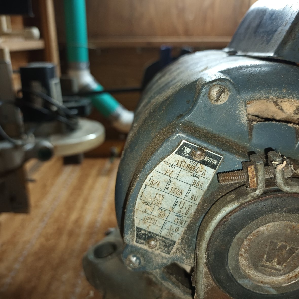

First attempt to upload pictures. We'll see if this works. This is the hand I was dealt:
- Shopsmith motor2.jpg (321.1 KiB) Viewed 10033 times
- Shopsmith motor ID tag.jpg (217.45 KiB) Viewed 10033 times
