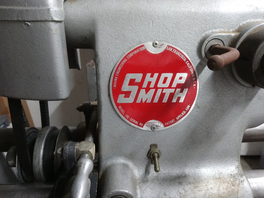

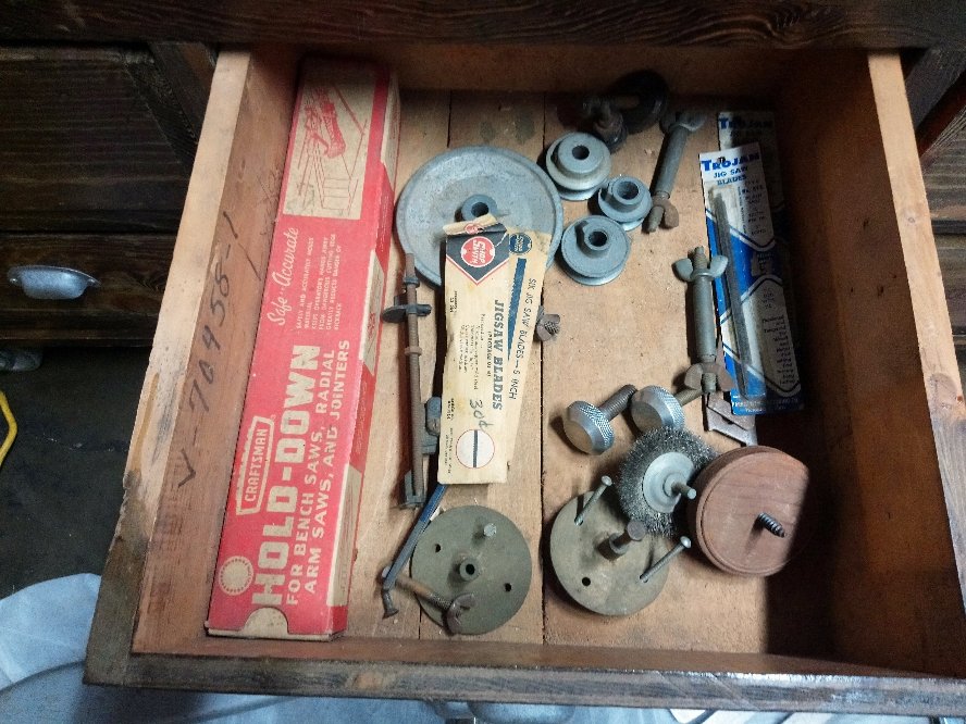

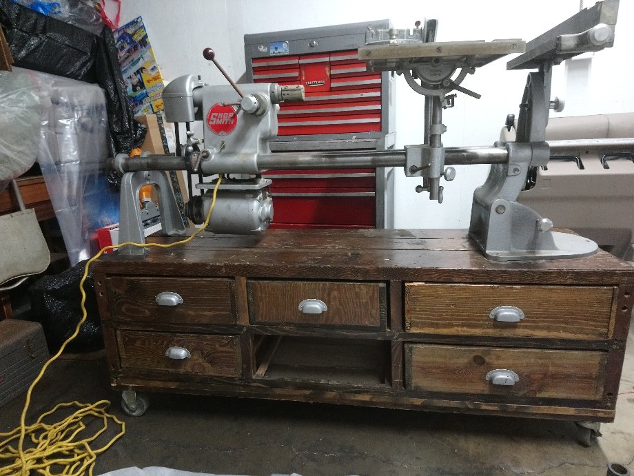

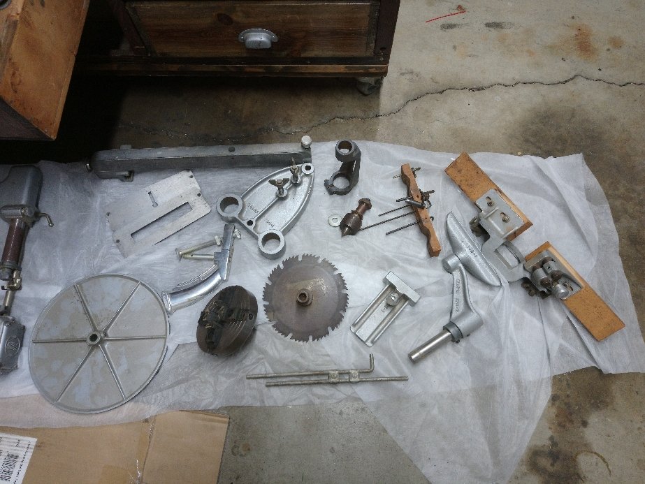

Hi All. I'm new to this group and to the world of Shopsmiths. I purchased my first Shopsmith a couple of weeks ago for $200. A model 10E serial number 22612, which likely dates it to about late 1948 or early '49. The seller had purchased it a few years ago from the original owner. It has quite a few accessories such as the jigsaw and speed changer. The original miter gauge and extension table are missing; most likely upgraded to the ER version by the original owner in the early 50's. It does however still have its original fence and tailstock. It seems to have been well cared for. I'm still trying to familiarize myself with the Shopsmith, but hopefully I'll be able to use it soon.

Re: Recently Got My First Shopsmith 10E
Nice acquisition!
A suggestion: Move the speed changer crank to the outer side of the bracket. This gives more hand clearance...
Welcome to the zoo!
Welcome to the zoo!

Nice looking machine, well kept over the years. Full complement of accessories and built in storage, you got a deal. Welcome to your new obsession

Welcome to the Shopsmith Forum. As JPG and Ed have already said you have a great looking Model 10E there. As you learn to care for it and how to use it, I believe you will enjoy it. Looking at the pictures it appears the original owner did upgrade it to the Metal Extension Table and I see you have both fences. Do use the one with the rear fence lock. Setup and use of the Metal Extension Table is easier than the Wood Extension Table.
Before running your Model 10E remove the Jointer Cutterhead from the Spindle. Those knives on the cutterhead can do a lot of damage so the Jointer Cutterhead should only be on the Headstock when properly setup using the Jointer/Shaper Fence you have. With that off you can check if your Model 10E is functioning correctly. I would recommend loosening the Belts to check the motor and the Drive Sleeve and Quill Assemblies separately. Turn the Upper Drive Pulley by hand to see that the Bearings in the Drive Sleeve Assembly and Quill Assembly turn freely and smoothly. Run the motor without any belts on it to see if it is running well.
Hopefully you received a Owner's Guide with your Model 10E along with manuals for the other accessories like the Jig Saw. If you need manuals we can direct you to PDF's of the manuals that are available for free.
Feel free to ask any questions about your Shopsmith.

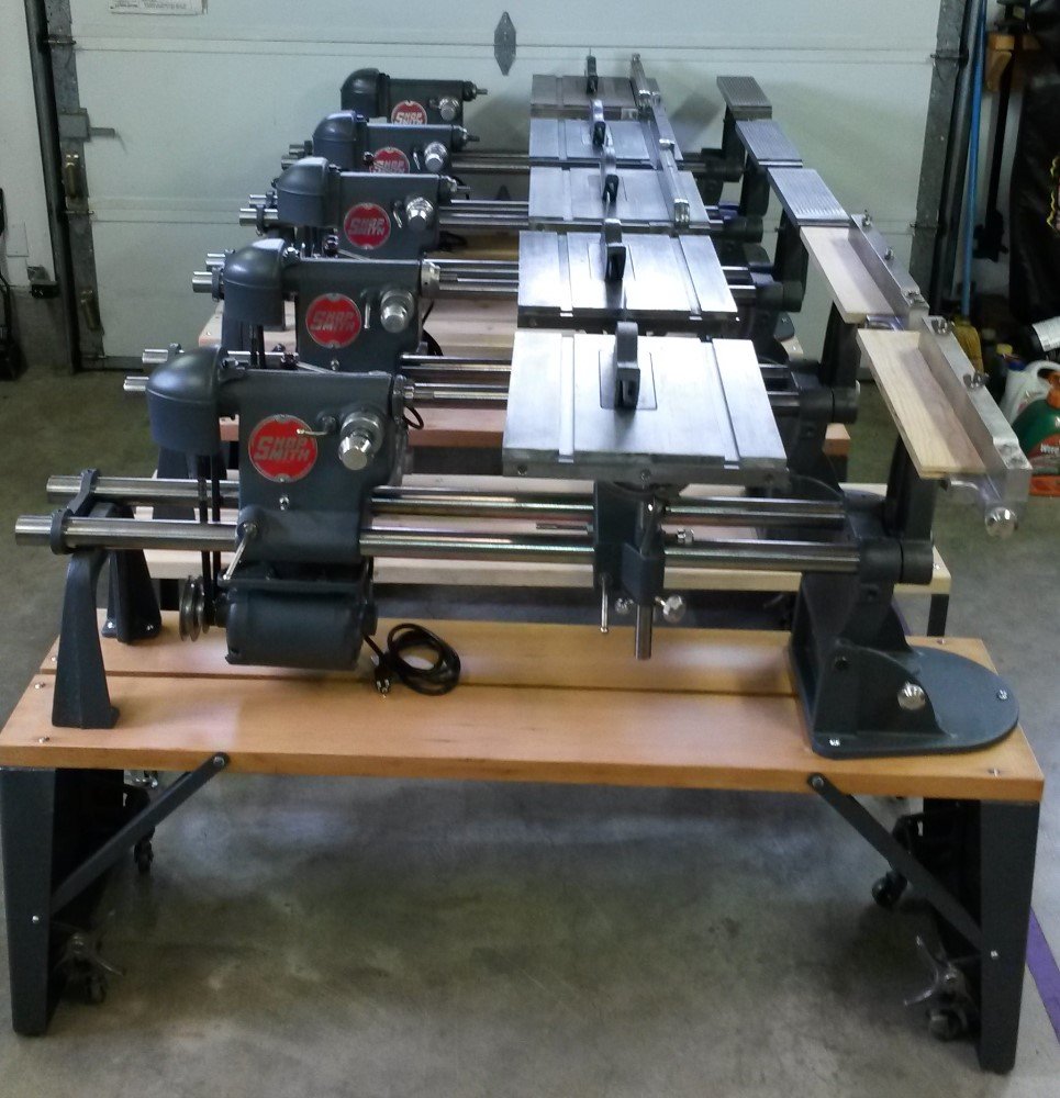

As JPG and Ed have already said Welcome to the wonderful world of Shopsmith's. Do know that Owning Shopsmith Tools can be habit forming as evidenced by my picture below.
_ .
These are 5 I restored and had together at one time. I still own the back one shown in this picture which was my first restoration. The second one, a Model 10E, is very similar to what your Model 10E would have looked like originally.
When you get to the Jig Saw we can discuss things to look out for and check to get it ready for use.
_ .
_

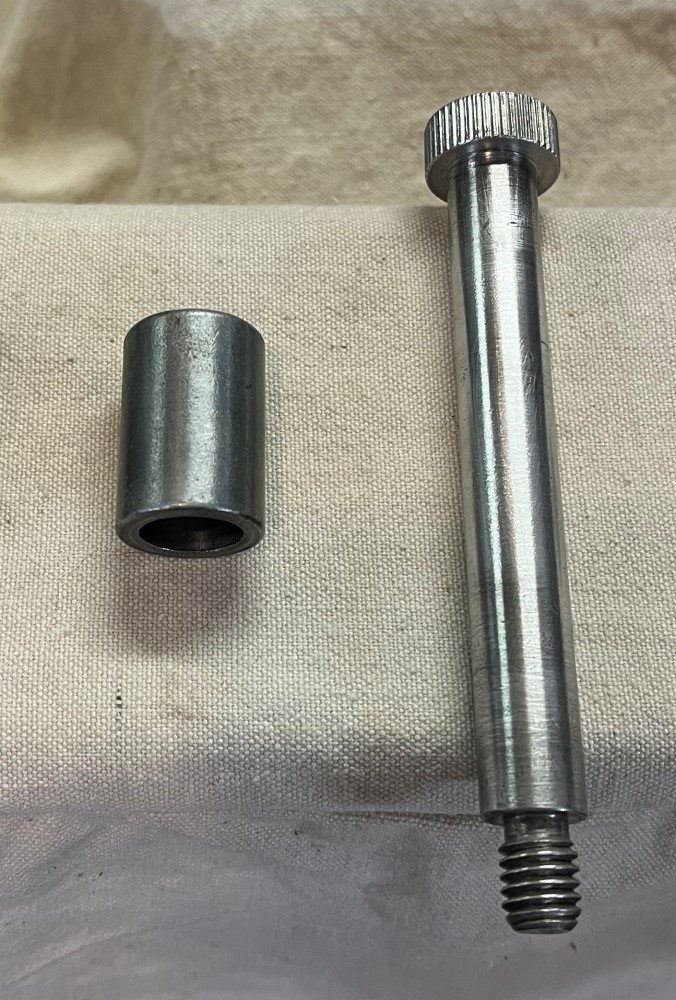

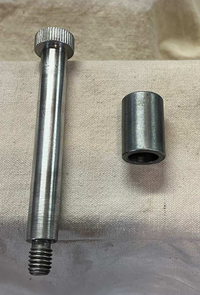

Below is a picture of the Jig Saw Mounting Bolt and the Spacer which is used when the Upper Arm is removed for the Sabre Saw function.
_
_
Left hand thread???
- Posts: 4538
JPG,
Nice catch. No, it is actually a right-hand thread, but the picture was flipped, my bad. As you know the Jig Saw Mounting Bolt goes into the hole of the Headstock for the bolt used to hold the Belt Cover on.
Here is the picture in correct orientation.
_
_
