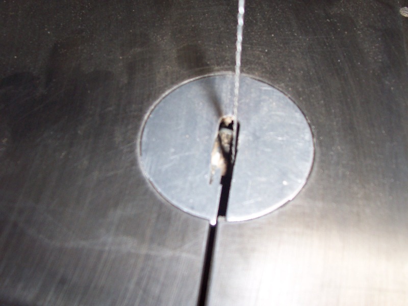

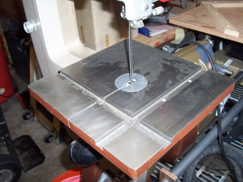

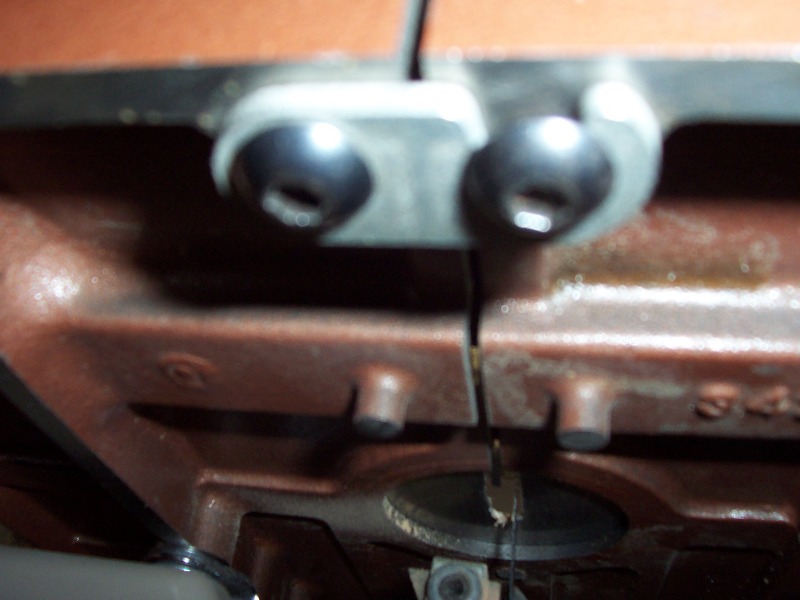

Anyway, here are a few pictures as requested:
[attach]3236[/attach]
this is the 2 1/2" aluminum insert. Not exactly zero clearance any more.
[attach]3237[/attach]
this is the cross bar under table with two 5/16-18 button head screws. These need a 3/16" allen wrench.
[attach]3238[/attach]
this is another view of steel table and insert.
