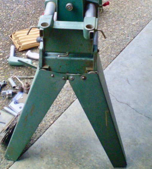

There are some things you can do to make your Mark 2 better. I mentioned the Bench not being very stable in my previous post. The picture below shows a common problem.
_ .

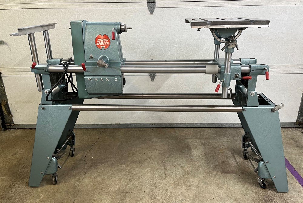

This can be improved upon if you have the Mark 2 Retractable Casters to help maintain the leg spacing or add something to the lower end of them to keep them properly spaced. The Mark 2 Retractable Casters are the same, as seen in the picture below, as the ones for the Mark 5/V and 7 except they are a bit shorter front to back.
_
_ .
_
