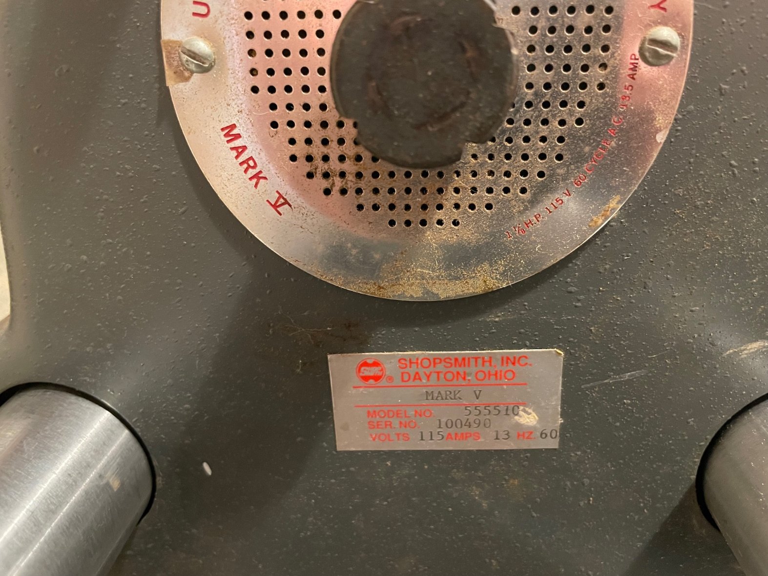

According to the Shopsmith timeline, the 510 was introduced in 1985. However, based on serial number (100410), my new-to-me 510 was made in 1981 and the jointer that came with was made in the first half of 1980. The plate on the headstock says 510 so this isn't a case of an earlier machine upgraded. Thoughts?

Does the nameplate indicate "510R" or similar? Early on they did factory 510 upgrades and IIRC this is how they are identified. A new nameplate with the old SN could easily be part of an upgrade.

Is the serial number on the nameplate or a separate sticker? I don't recall what the date codes looked like, but could it have been made on October 04, 2010?

Good guess, but per Everett Davis' "Buying a used Shopsmith v2" document, date codes started in 1988 and are in mmddyyyy format.
Posts: 4538
Re: 510 curiosity
Seeing a picture of the serial number on the Headstock would be the easiest way to determine when it was made. Not having that my first question would be is the serial number on the Vent Plate or a sticker. On the Vent Plate it is a serial number. Actual Mark V 510 serial numbers began with 51-serial number, but the records show it didn't go anywhere close to being as high as 100410. The Vent Plate also says Mark V Model 510. On a sticker it is a date code. Some date codes have dashes between the month, day and 2-digit year while other are simply 6 digits of month, day and 2-digit year.
Post a picture of the Vent Plate or sticker with the Serial number and we can solve the mystery.

Sorry -- number is 100490. So maybe 04 OCT 1990? That would make more sense!

Oct 4 1990

Mystery solved.
HopefulSSer,
since date codes well before Oct. 4, 2010 were using the MM-DD-YY format unlike the earlier date codes like yours being simply 6 digits without the dashes.
