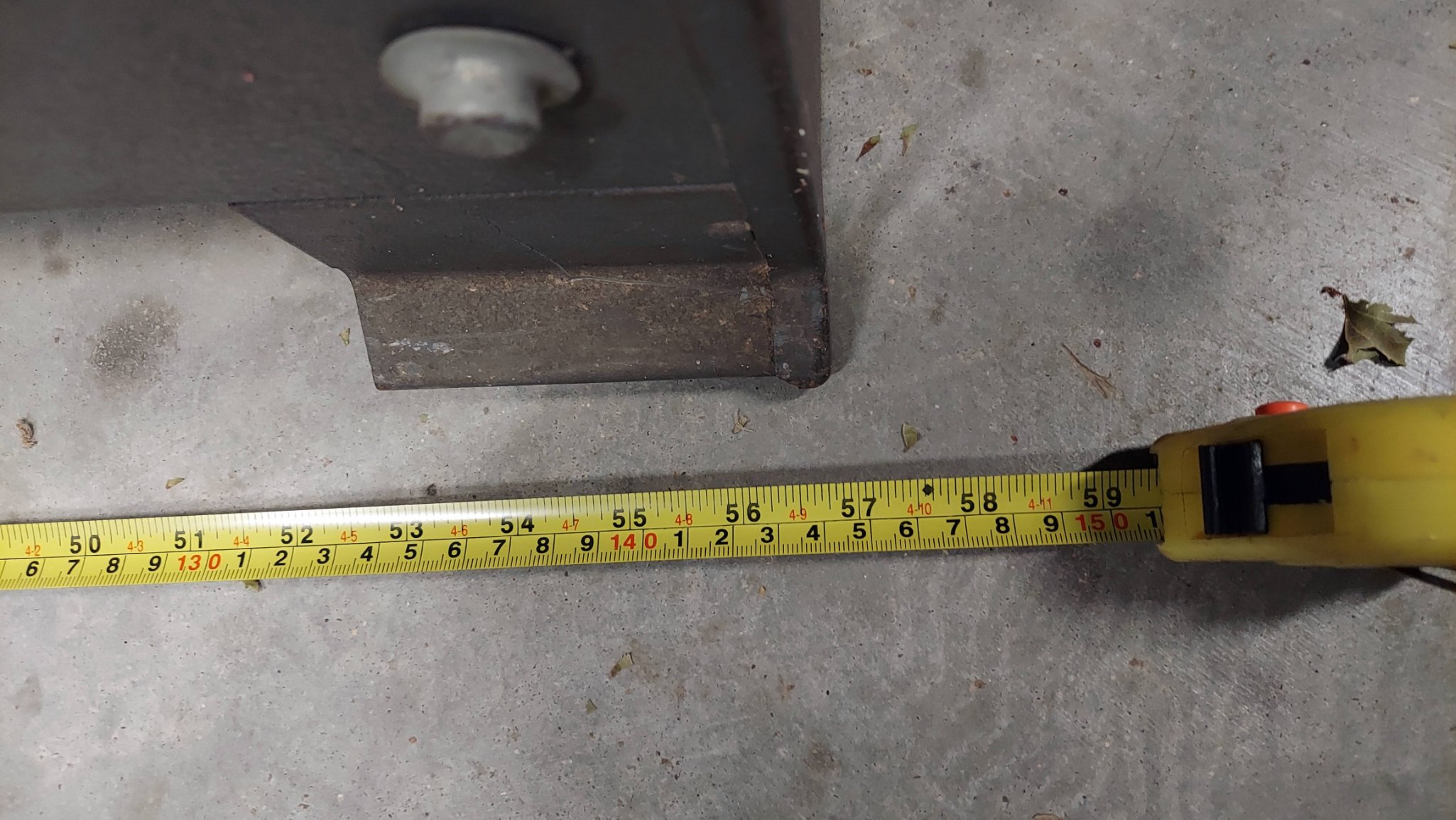

Next we've got the base measurements. Looks like 17 wide by 57 long.
base width.jpg (345.07 KiB) Viewed 945 times
base length.jpg (359.23 KiB) Viewed 945 times

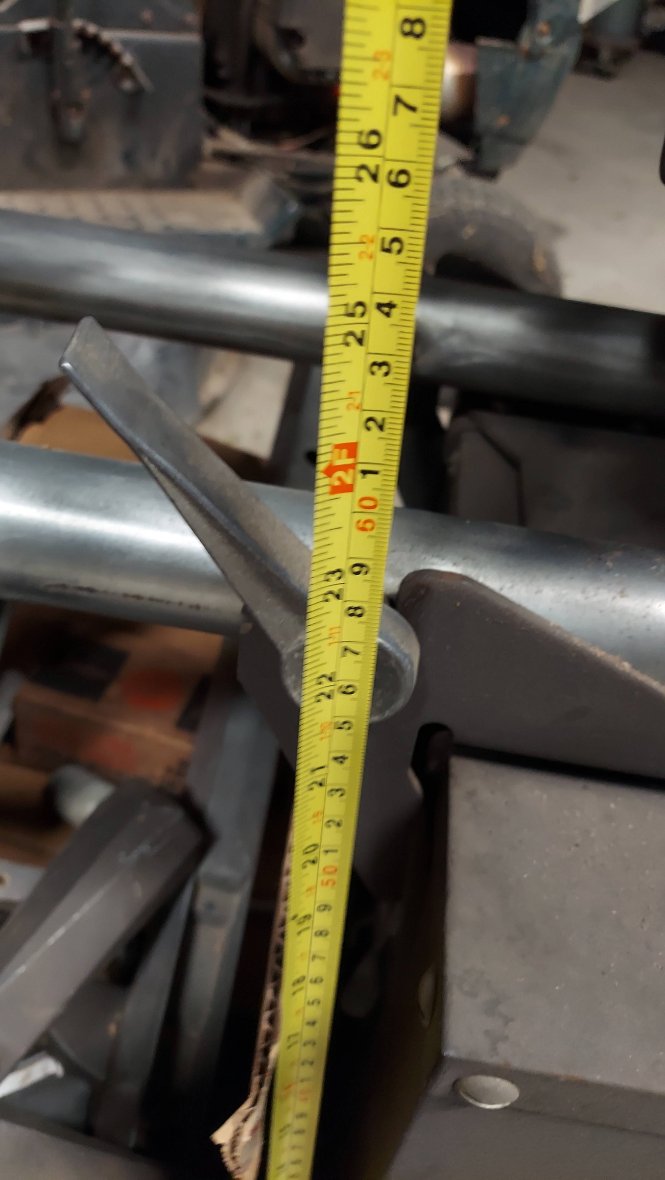

And last, is the height from the ground to the lower ways pivot.
pivot height.jpg (87.58 KiB) Viewed 945 times
I'm of the opinion that the base should have outriggers greater than 17" to help from tipping. This goes along with the pivot height at the lower ways being higher than 22 inches. I'd likely add about 6-9" for the lower set of ways to pivot so the tool was a bit higher in vert mode. Of course that depends on the operator too.
