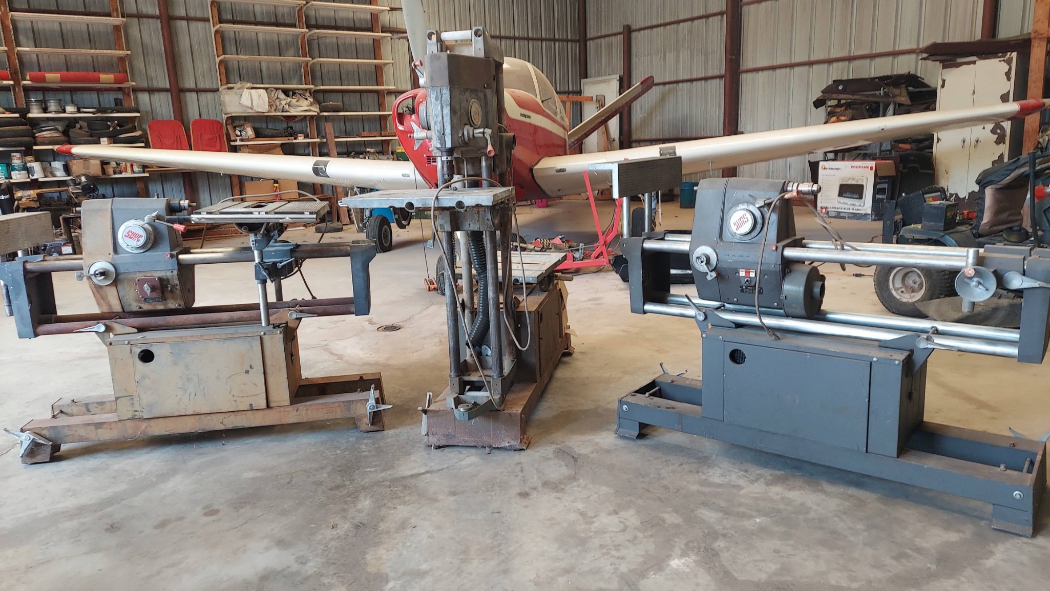

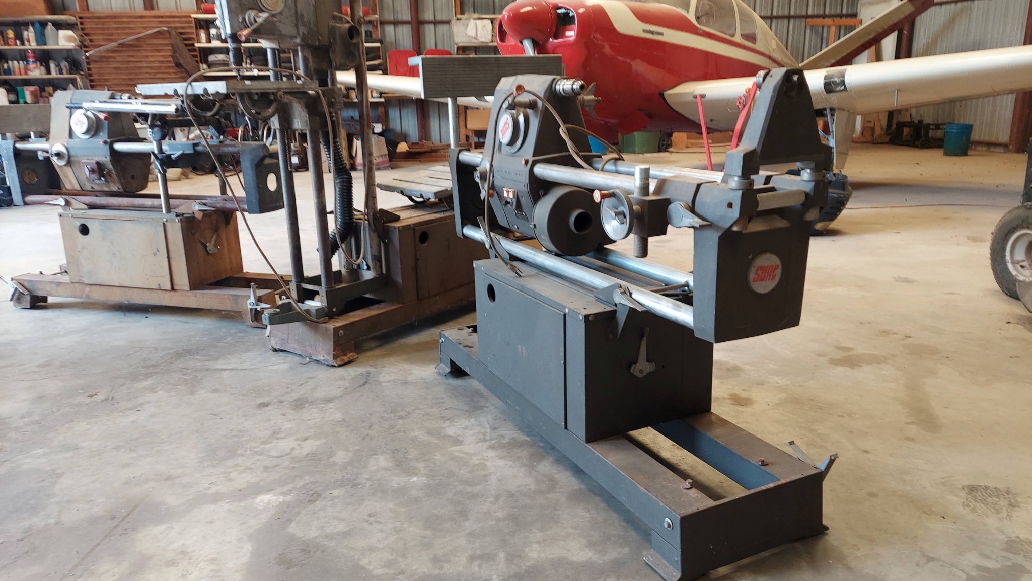

Pichurz.
Leda is the best cond yet. The castors castor, motor motors, the spindle spindles, the ways way, the speed speeds, the vac vacuums, and the quill quills. Only thing I see that needs doing is some lube and has the wrong gilmer belt, but it's working just fine.

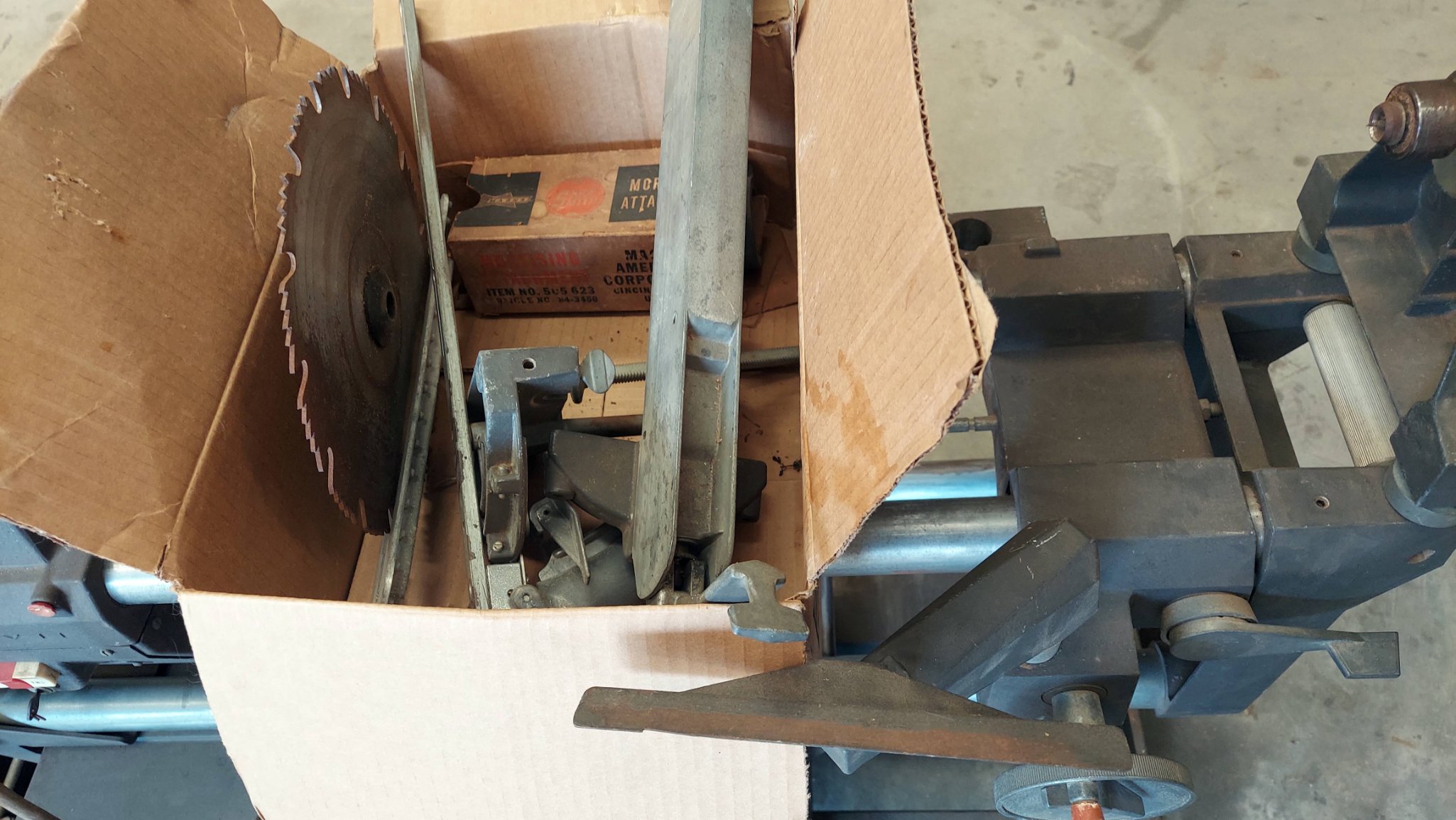

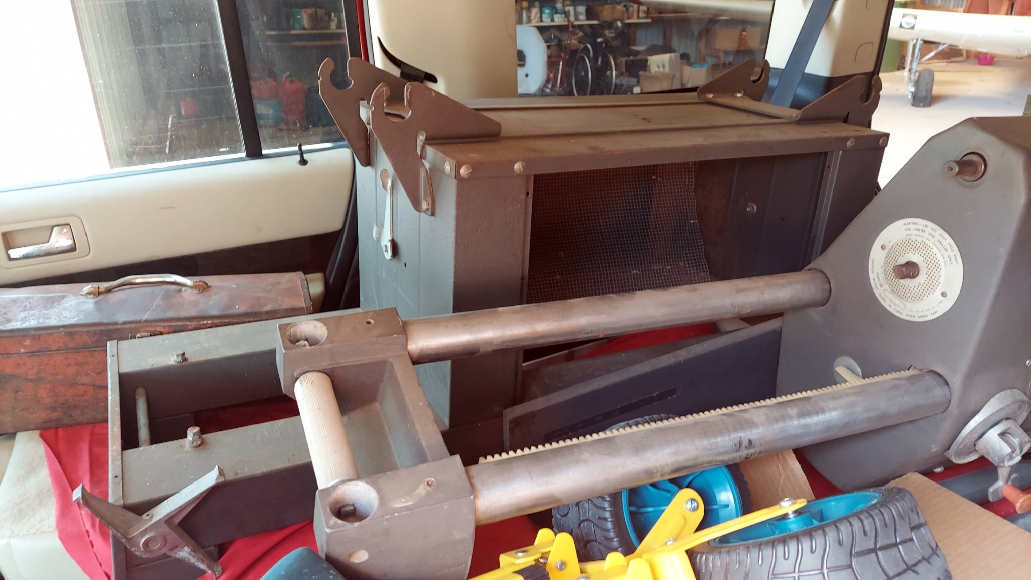

More pichurz. First one still in my Flex. I say this was the deal of the century.

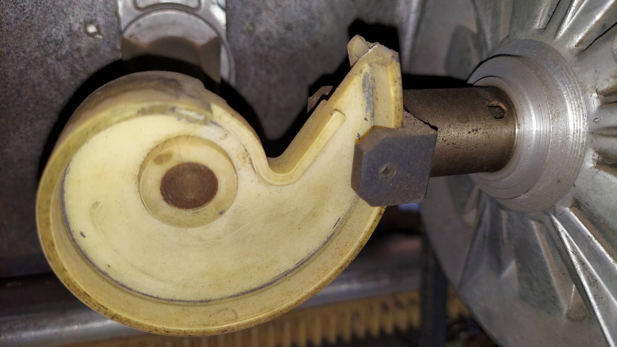

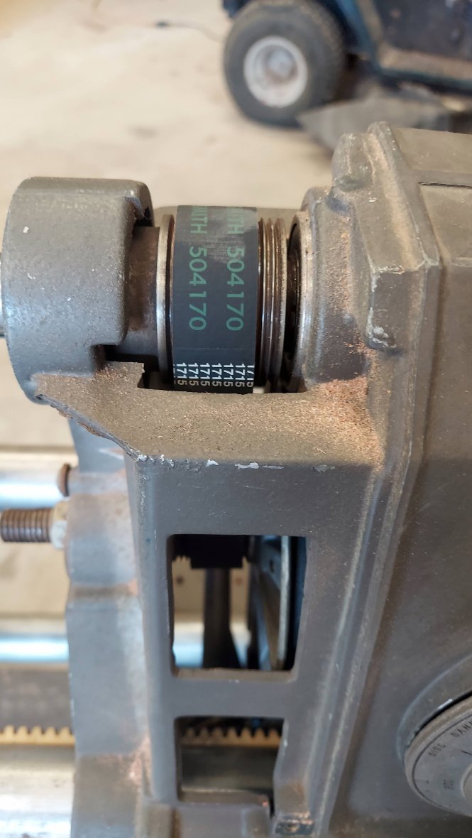

pichurz. Now, I'm not sure yet, but at first blush, it appears the gilmer belt is not well aligned on the grooves. Which is not groovy. I'll loosen it up and do some hacking at it next week when I lube. I got a nice drill chuck with it, but no chuck key, and no allen. I've ordered both from amazon.

Those things are so cool looking! The disadvantage to the bench configuration appears to be the low height of the headstock in drill press mode. That just tells me the bench tube pivot on the right side should be further out. The cabinet could be longer, or just a bracket extension. It's not a disadvantage when the headstock is in under table mode so the left side pivot could remain the same.
Looking at your pictures I'm wondering if the cabinet could be shifted to the right on the wheeled frame, along with new pivot rods on the bench tubes positioned to correspond with the new cabinet position. Maybe a problem with clearance in under table mode. So just moving the right side pivot point further to the right should do the trick.
Is there a locking mechanism for the two vertical modes?
