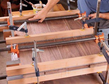

woodhead52 wrote: Thu Oct 12, 2023 9:38 am In the meantime, what I have now is bar clamps and pipe clamps. How can I make these work?
Pete:
Here is a photo clipped from a Fine Woodworking article on clamping. In the picture you can see that the cauls span the boards that are being edge joined and downward pressure on the cauls is being applied with the small clamps. The pipe clamps are putting the squeezing pressure on the joints. A couple of things to note: The inner faces of the cauls are covered with strapping tape or wax paper to prevent them from sticking to the glue, and some people recommend that the cauls be gently curved on their inner faces such that the center of the caul is about 1/4 inch or maybe 3/8 inch thicker than at the ends. That little bit of curve ensures good pressure along the full length of the caul.
caul picture.jpg (28.36 KiB) Viewed 23217 times

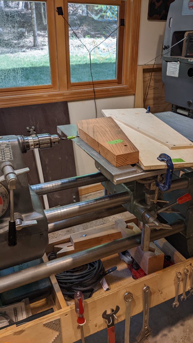

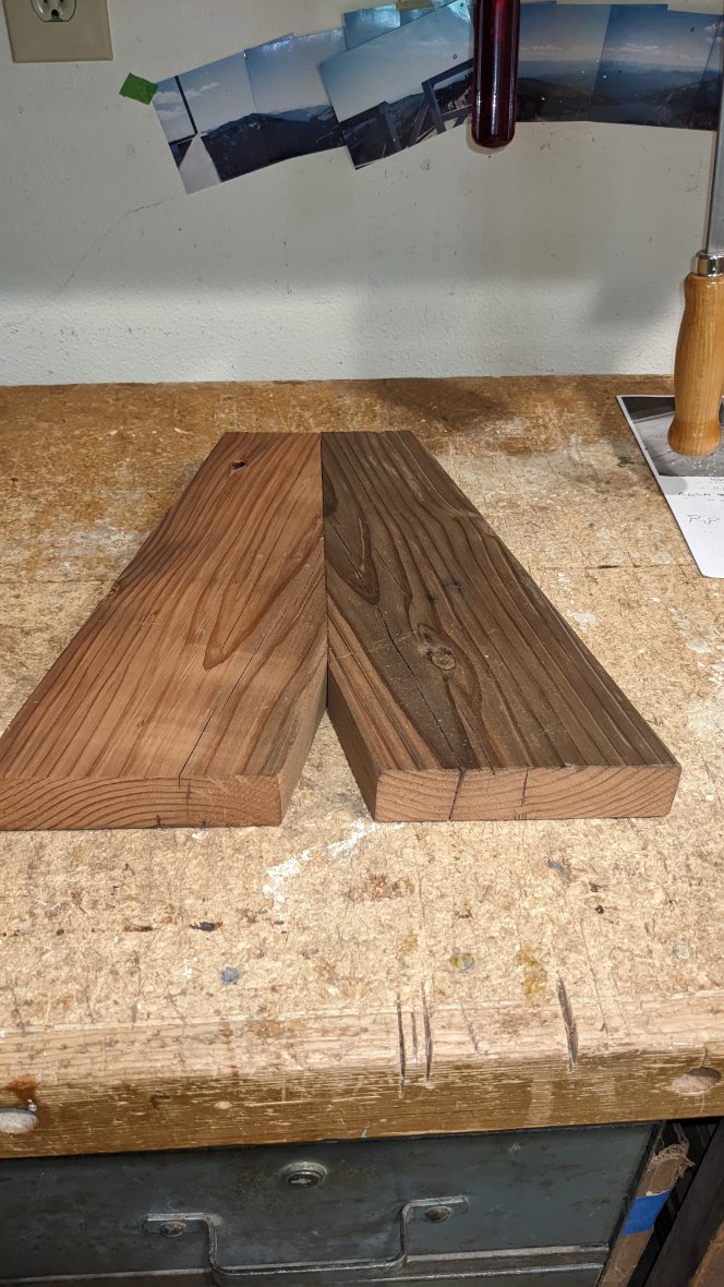

RFGuy wrote: Thu Oct 12, 2023 10:54 am For those who deem this easy on a Mark V, perhaps you can give all of your best tips to the OP on this thread because I wouldn't even attempt this myself given some of the caveats with horizontal boring on a Mark V.
Well, I don't claim to have done a lot of doweling on the Mark V, but over the years I have done some. About a year ago I had to edge join some picnic table legs that were angled on the inner faces, and the glue-up required temporary clamping "ears" for the clamps to press against. Since the glue-up was going to be a little tricky, I decided to use dowels to make sure the pieces were aligned and did not slide around when I clamped them. With my 500 in horizontal drilling mode I clamped a board to the main table at the correct angle and drilled for the dowels.
picnic table legs drilling.jpg (170.63 KiB) Viewed 23212 times
picnic table legs.jpg (178.78 KiB) Viewed 23212 times
The legs are redwood, so the drilling was easy and the clamped board provided enough resistance against the quill to keep the table from flexing. In the case of a harder to drill wood I have had to do things like clamp the main table to the auxiliary table and/or use the fence backed up with boards clamped at right angles to the fence to counter the deflecting forces. Even so, it is still necessary to drill with minimal pressure on the quill, withdraw the bit frequently and take small "bites" to avoid moving the table.
