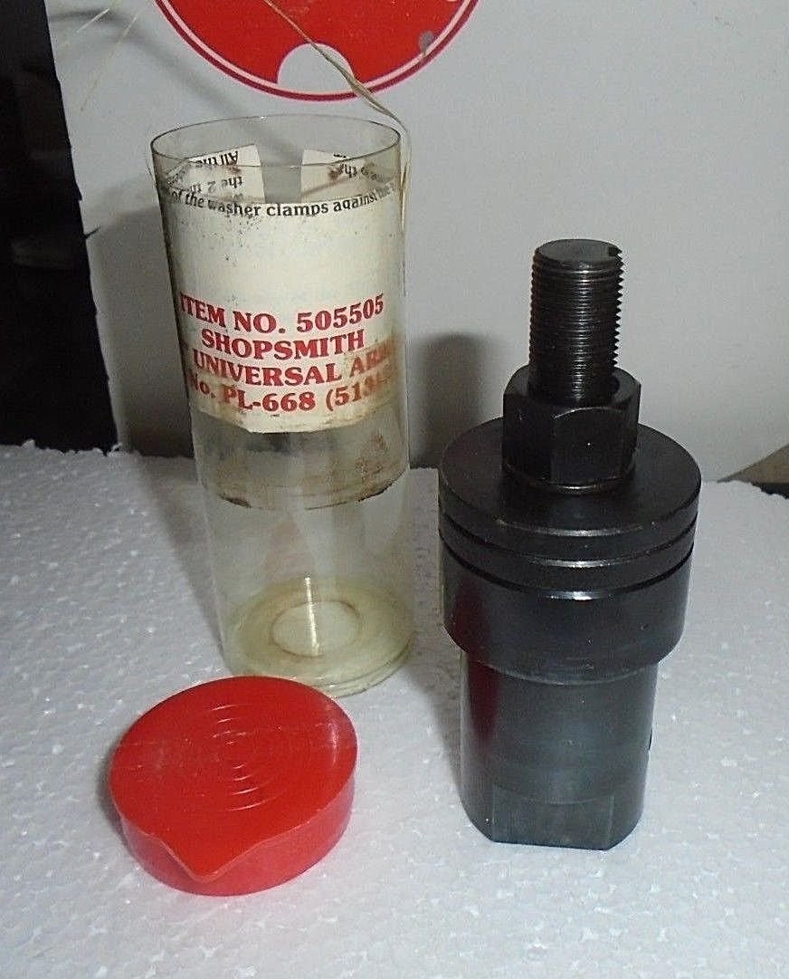

Items 1 & 2 appear to have a 1/2" bore and if so are spacers for the 1/2" Universal Arbor P/N 505505 you have as item 7. It uses one of them and a complete 1/2" Universal Arbor is shown below.
_
505505 V2 w- tube 04-79.jpg (109.39 KiB) Viewed 19968 times

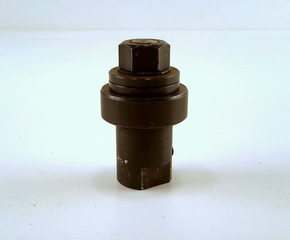

Item 6 appears to have a 5/8" bore and that spacer would go to the 5/8" Universal Arbor or as it is currently called Molder/Dado Arbor both P/N 505506.
Item 3 appears to have a 5/8" bore and is a machined washer also for the 5/8" Universal Arbor.
Below is an example of a complete 5/8" Universal Arbor.
_
505506 V3-3a.jpg (60.58 KiB) Viewed 19968 times

Russ:
As usual, the complete answer(illustrated!!!).
