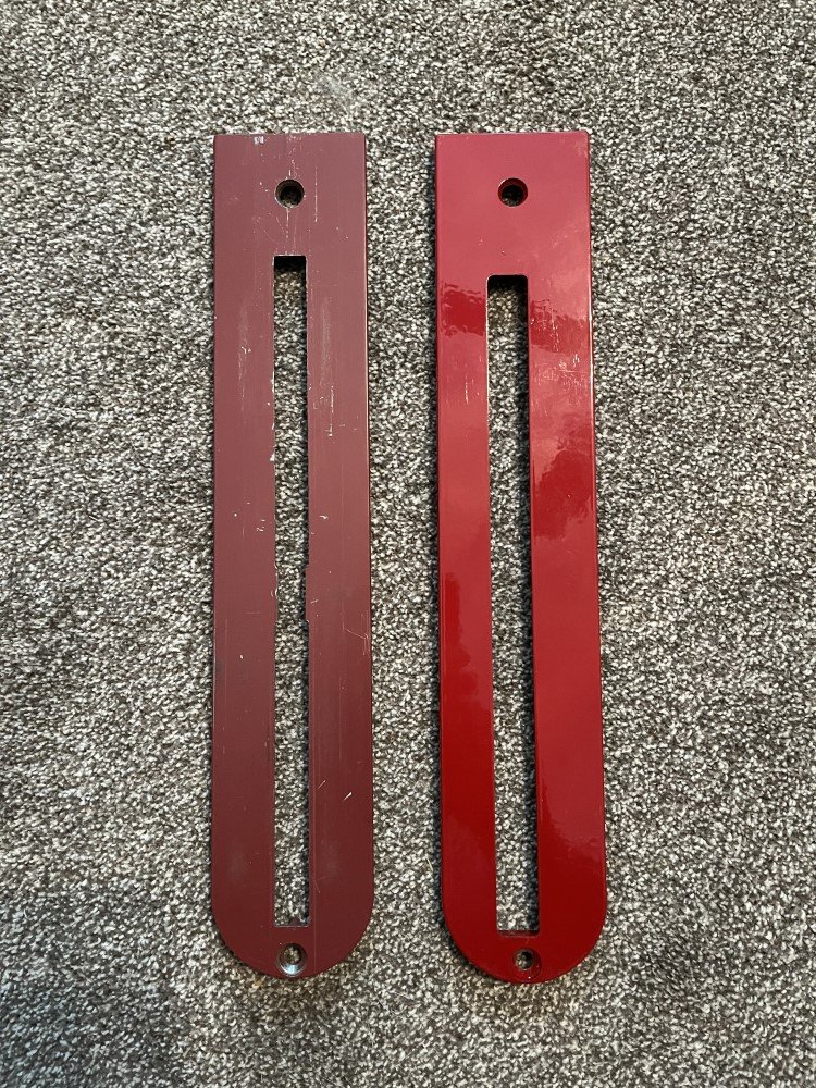

Russ please provide what you know about this. The early saw blade insert slots were not long enough to allow the sanding disk to be fully exposed. I seem to remember at one time SS sold a table insert just for the sanding disk that had a longer slot. Then they just lengthened the saw blade insert slot for the sanding disk and now there is only one insert. I have one here that I lengthened the slot. As I remember it was about 3/8".

You are correct about the standard Saw Blade Table Insert and there having been a slightly different Sanding Disk one. Apparently, the Sanding Disk Table Insert is no longer available since the online catalog listing for it takes you to the Drum Sander Table Insert. The Saw Blade Table Insert opening at 12-1/2" is longer which accommodates not only a 10" Saw Blade but the mounting of the Upper Saw Blade Guard or a Riving Knife. The slot is narrower at 5/8" wide and has the narrower spot at the arbor center. The Sanding Disk Table Insert opening is 12-1/4" long by 3/4" wide.

EDIT: Below is the Saw Blade Table Insert on the left and the Sanding Disk Table Insert on the right

So here is the more important difference between the two Table Inserts. The opening on the Sanding Disk Table Insert starts closer (slightly less than 1/8") to the Infeed end of the Insert. This this gives slightly more clearance at the infeed end for the Sanding Disk than can be done with the Saw Blade Table Insert. The slot on the Saw Blade Table Insert is 3/8" closer to the outfeed end of the insert to allow for the mounting of the Upper Saw Blade Guard or a Riving Knife. I do not know if the Saw Blade Table Insert has been changed to give the extra clearance at the infeed end. Both of the Saw Blade Table Inserts I have are the same and came on my 2001 and 2006 Marks.I have one here that I lengthened the slot. As I remember it was about 3/8".
I do have a Sanding Disk Table Insert and will try to get a picture to post here.
