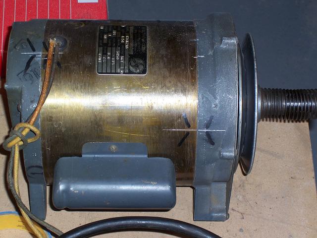

Motor (2 required) - See attachment for an image of the motor.
Original: FAFNIR 203-KDD
