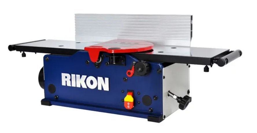

Cast iron manufacturing has improved in recent years, I believe, but I am wondering why it can't be aluminum instead? Check out the pic below of a benchtop planer (model 20-800H) on the market from Rikon (a reputable woodworking tool brand that is the cheaper version of Jet woodworking tools). The infeed & outfeed tables as well as the fence are all aluminum. It has an 8" helical head cutter and the entire machine weighs only 49 lbs which includes the motor! Shopsmith's 4" jointer (without motor) weighs 53 lbs. I would really like to understand why Shopsmith can't bring to market a product like this, i.e. an 8" jointer with helical head, aluminum infeed/outfeed tables that mounts directly on the Mark V/7. An added bonus would be the ability to have some kind of table extensions for infeed and outfeed...could even utilize the Shopsmith floating tables in some kind of arrangement that attaches to the jointer's infeed/outfeed tables.
I would really like for the naysayers to tell me what I am missing here. Why can't Shopsmith bring to market a larger format jointer that can mount on the Mark V/7 and not kill my back? They can continue to sell the 4" jointer to anyone that wants it as well, but honestly an 8" jointer should have been brought to market by them years ago IMHO.

Yeah, I agree, but they have all of this influx of new money now, remember? :D In the past, on the forum or elsewhere online the discussion invariably is that Shopsmith can't release a jointer wider than 4" because it would be too heavy. The 6" clone jointer was 100 lbs ( :eek: ) and that has often been the comparison point to say that no one would want a jointer larger than 4" to mount on the Mark V/7. Moving to aluminum tables, as benchtop planers have done, as Shopsmith has done for the Mark V itself seems to make perfect sense to me. Looking at those ground and polished Rikon tables they look perfectly flat to me. I know it is just a picture, but still they look to be high quality...better than the much cheaper benchtop jointers on the market that it competes with. IF Shopsmith made something like that Rikon in an 8" with helical head, I wouldn't hesitate to buy it. Don't know how many more me's there are out there, so difficult to tabulate potential sales numbers. Last time I did a doppelganger search I was unique, but things can change. :rolleyes:

Rikon Jointer Aluminum Outfeed Table:
