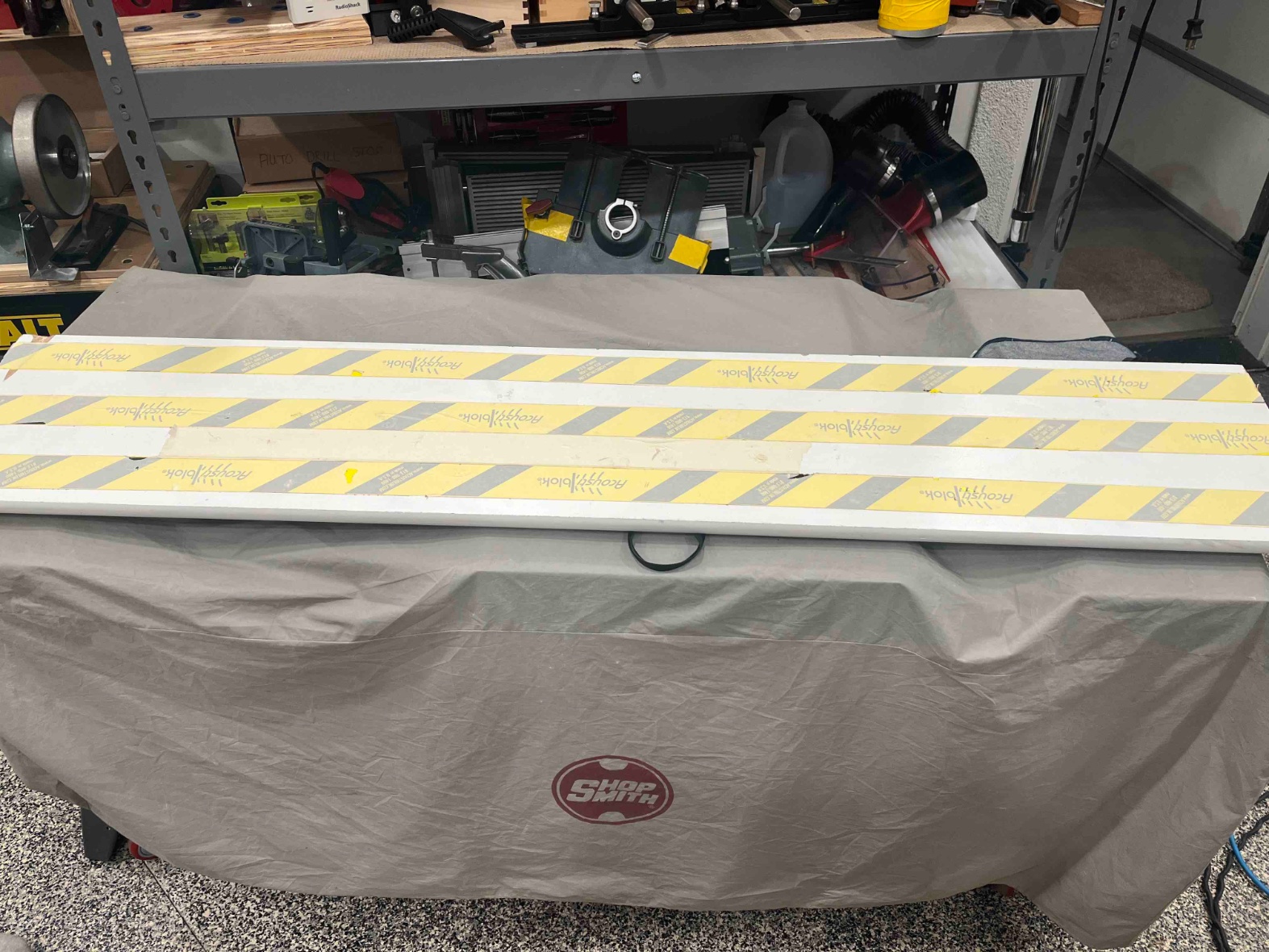

Erik
Posts: 43
Joined: Fri Mar 20, 2020 3:49 pm
Location: Durango, CO
Re: Sell me on the SS jointer
Post by Erik »
RF Guy,
I routinely use a Thein sled for surface planing (viewtopic.php?p=275317&hilit=Erik#p275317). Initially I stacked 2" OSB and 1" melamine together, but it works so well I have since dropped the OSB and simply use a 1" thick piece of melamine (5'x11"x1"). I have three strips of masking tape running the length of the melamine which works to surface boards from about 4"-11" in width. The only trick -- if there is one at all -- is to assemble the sled on a reliably flat surface. My assembly table is perfect for that. I have run hundreds of boards through this system in the past 5 years and other than replacing the masking tape a couple of times there is little maintenance. Plus, you can't beat the footprint of a 1" board if your shop is on the small side!
-Erik
