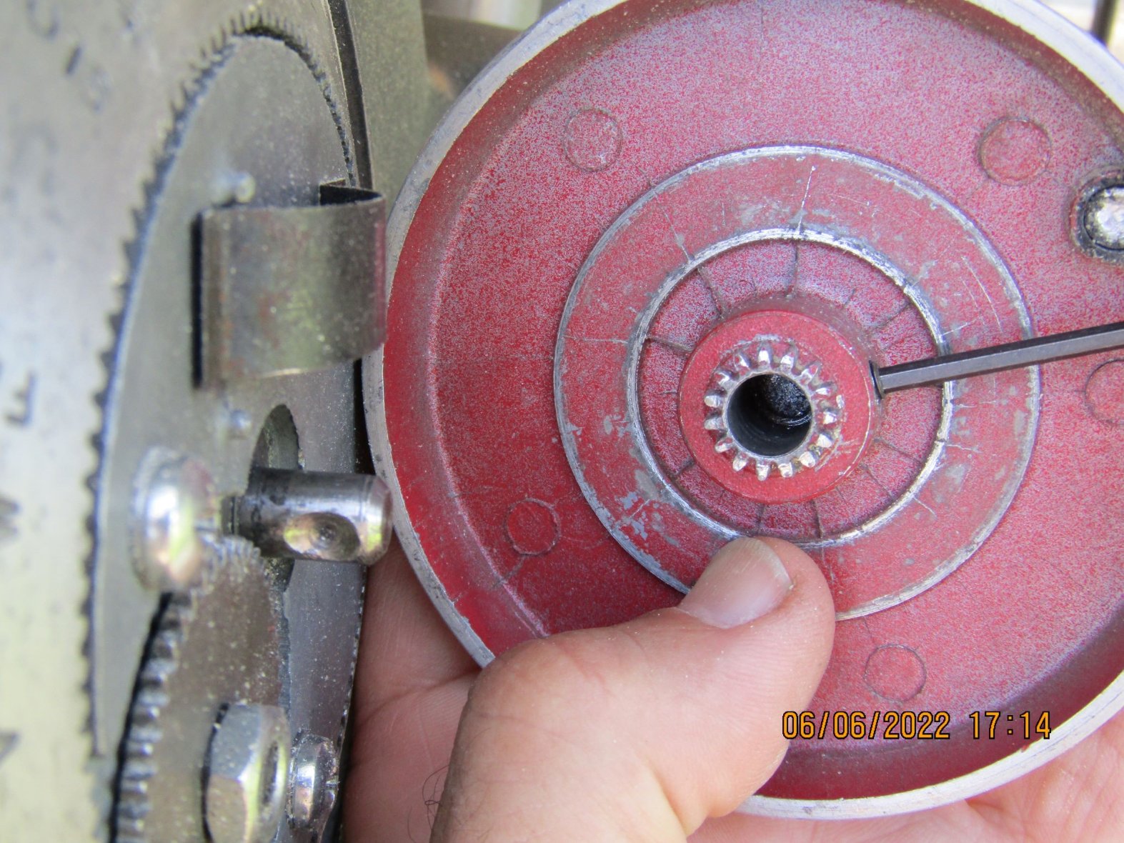

I am getting a similar drift problem but my question relates to the setscrew connection between the Speed Control Handle (84) and the Worm Control Shaft (87). See attached photos.
My Speed Control Handle wants to come off the shaft during operation. Pinion teeth are not worn. and the setscrew threads are OK.
But look at that huge oval indent on the Worm Control Shaft! Does anybody know if that still how they come from the factory? Or is that wear from the setscrew?
It's like the setscrew manages to vibrate its way past that sloppy oval detent. I have tightened that little setscrew to the max, but the dial still wants to slip out of engagement with the Idler gear (93) and off the shaft.

What shape is the end of the set screw?
Re: Speed Control Issue
The indent on my worm gear shaft appears to be oval but is round. Yours looks different in your pic to me. Mine only appears to be oval because of how it is cut into a round shaft. If I remove the setscrew from the handle and hold it in the indent, the indent is clearly round at the depth that the setscrew engages. If I install the handle without the dial it is straight and tight, exhibits no movement relative to the shaft.SteveMaryland wrote: Mon Jun 06, 2022 6:35 pm ...

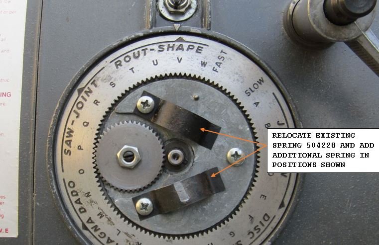

To remedy the speed drift problem, I added a second item 83 dial spring, and I located these two dial springs opposite each other (see picture). This second dial spring doubles the thrust loading and dial drag friction, while the two opposite locations balance the thrust load on the dial axis, thus (possibly) solving both the speed-drift problem and the off-center thrust loading on the dial. But while this mod doubles the speed-stabilizing frictional drag on the dial, and also balances that loading, it also doubles the thrust loading on the dial, making an improved dial retention necessary.

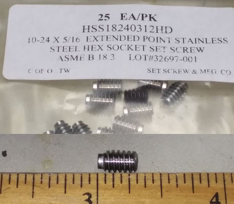

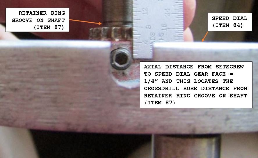

A dog-point setscrew provides improved dial retention. To accommodate the new dog-point setscrew, I crossdrilled item 87 (worm control shaft). I want the dog-point to pilot directly into this new crossdrilled bore. Crossdrill location is critical to get this and also get full mesh of the gear teeth between speed dial and item 93 (pinion gear). I found the proper location to be 1/4" from the retaining ring groove on item 87 shaft (see picture). The reason the gear face of item 84 (dial) may need to be sanded down is to remedy any interference between that gear face and the face of item 92 (retainer ring), which may happen depending on exact crossdrill location. To be effective, a dog-point setscrew must pilot exactly into a bore, and depending on the exact bore location, some sanding of the dial gear face may be necessary to get a clearance between that face and the retaining ring. I have implemented these mods on my Mark V headstock, and improvements in speed-holding and dial retention have been observed.

Great write-up and documentation of your modification Steve. Reviewing the thread you referenced, the OP said his would drift at speeds of "M" and higher. Notionally 2400 RPM and up, making a few assumptions. If he resolved the problem he didn't say so or tell us how. I'm wondering if your pre-mod drift started this low? I've seen drift, but only at much higher speeds near the top end.
I especially like the idea of balancing the force of the leaf spring.
