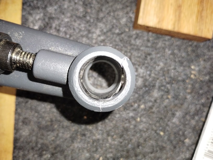

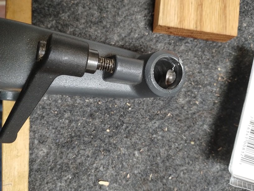

Where his broke is the same place mine did, just not nearly as bad. Took some pictures this morning. As you can see, the crack extends down both sides and leaves the tool rest just loose enough that it moves around even after you tighten the wing screw. It's cracked just enough that it's loose, but not quite enough to fall off. I do like the option in that last video, but again, I can't weld and I don't happen to have a piece of stock the right size to use for this purpose.
