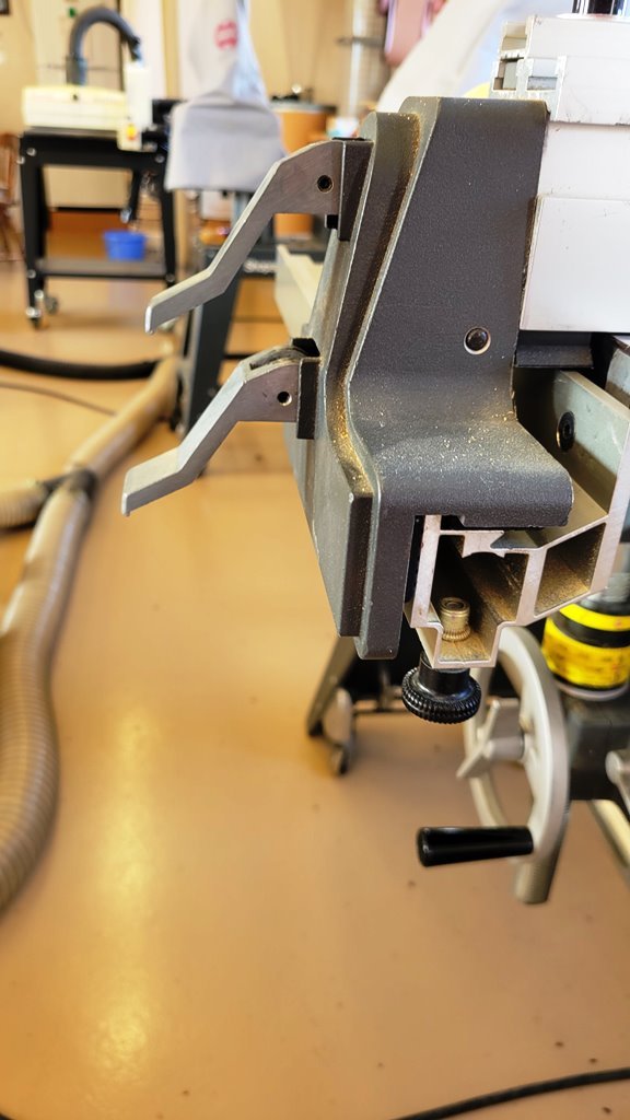

The term all the way down is the question. I didn't think when I responded. I meant all the way down when properly adjusted it won't go any farther. Too lose and the handles will go down farther and almost point at the floor. Too tight and you won't get the over center feel. The picture shows a properly adjusted fence in my opinion. The nuts are tightened to the point that the handles get tighter up to the point just before the end. Then you get that over center feel where the last little bit has less tension. At that point the handle is "all the way down" for that adjustment. It will not go any farther. Notice both handles are in the same angular position. Each one has the same tension and over center feel when locked. I use spray dry lubricant on them other wise they get a little sticky.
Bottom line you want that over center feel at the end. If you don't feel that you are either too tight or too loose on the adjustment of the nuts.

520 Fence.jpg (81.81 KiB) Viewed 36109 times
