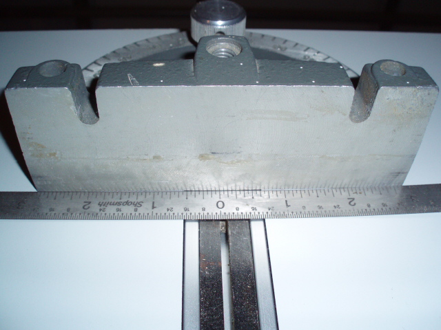

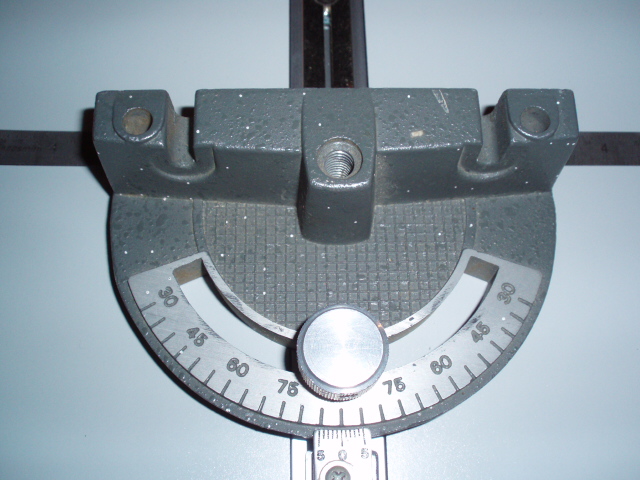

Just got my MiterSet what a sweet deal. Richard is a real gentlemen. I have a problem that I need help with. My miter gauge head is only 5 3/4" wide and at the 8 segment setting it is not wide enough to contact both pins???? Richard had a great fix by using a 6 inch metal rule that I will be getting tomorrow. Any one else have this troube. Is my miter gauge head not a Shopsmith head or maybe it is old. I bought my SS used and it was a 500 so it was stated. Pictures attached. Richard and myself are interested in this if there is something that may have been overlooked. Thanks for the help.

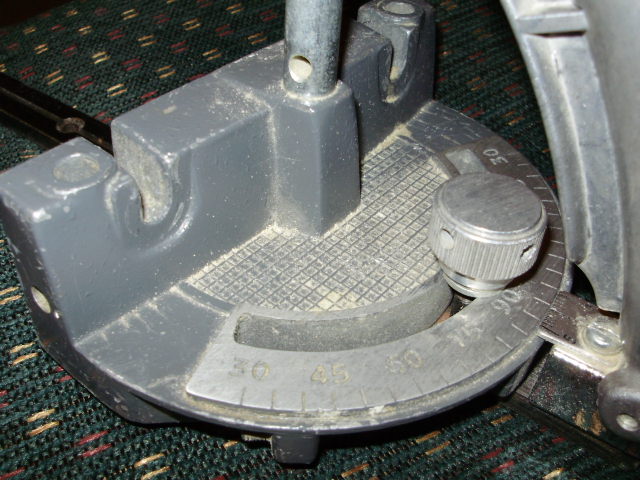

kd6vpe wrote:Howdy all,
Just got my MiterSet what a sweet deal. Richard is a real gentlemen. I have a problem that I need help with. My miter gauge head is only 5 3/4" wide and at the 8 segment setting it is not wide enough to contact both pins???? Richard had a great fix by using a 6 inch metal rule that I will be getting tomorrow. Any one else have this trouble. Is my miter gauge head not a Shopsmith head or maybe it is old. I bought my SS used and it was a 500 so it was stated. Pictures attached. Richard and myself are interested in this if there is something that may have been overlooked. Thanks for the help.
Your miter gauge looks very, very similar to mine.
[ATTACH]3343[/ATTACH]
[ATTACH]3344[/ATTACH]
I went back to look at your posted images and realized you have the other MiterSet. My input won't do you much good. You can see though that my gauge isn't any wider than yours.

Do you have an 'engineers square'? Do you have anything long enough, skinny enough, with parallel edges?? Lay it between miter gauge and pins. Being parallel, the angle set WILL be correct.

Here I am with egg on my face. kd6vpe certainly has a correct miter gauge so when I decided to make the MiterSet Segment model for ShopSmith I made a slight error. I don't see an immediate fix to the setting fixture as the holes would probably be too close together if I tried to make it smaller.
However it just might be time for all of us to listen to my secretary/Wife and fit a fence to the miter gauge head. This would be the wise thing to do in any case as it makes for a sturdier set up with increased support for the work piece.
I expended too much energy in making sure MiterSet fit the ShopSmith miter gauge bar and not enough time on research.
Dick Pattee, Inventor of MiterSet
