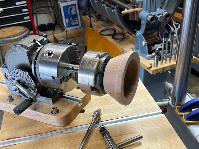

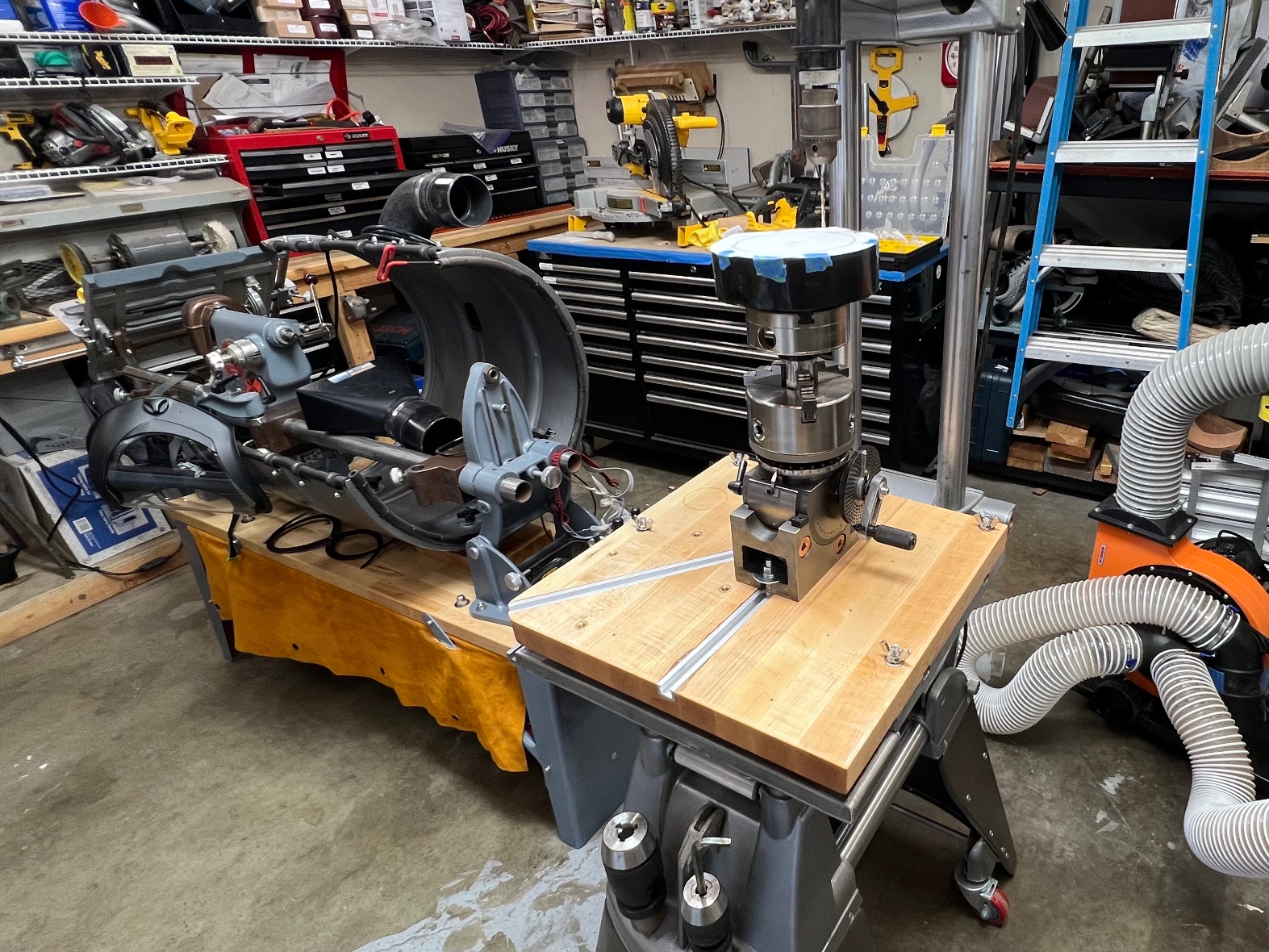

Been screwing around with this the past week and prototype worked out to be finished solution. I want to put small circles of various diameters, about 3/32 deep and flat bottomed, around top and sides of bowls. After this is done I will inlay various materials similar to bowl shown. I tried measuring and marking with limited success. Pretty sure this is going to work beautifully as it’s extremely solid and the Shopsmith has a huge vertical range. Please let me know your thoughts, comments or questions.

Very cool! First thing I thought of when I looked at the setup: that seems like a great use for a Mark-mounted Over Arm Router (OAR) setup.
Question: Are both lathe chucks necessary? Is the chuck nearest the indexer a metal lathe chuck and the other a wood lathe chuck?

Yes and yes, for me, though somebody with better skills might find a way to modify.

Softer jaws for the metal chuck = no wood chuck?

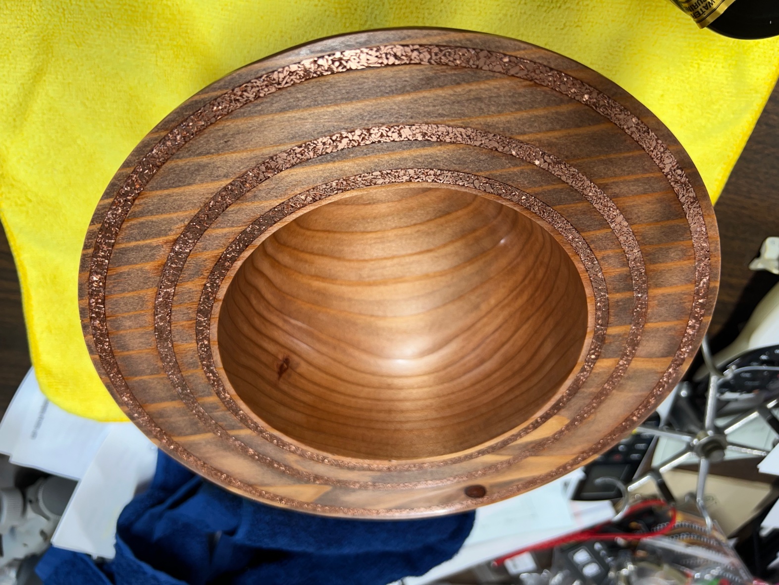

RFGuy- I used the lathe and carbide cut off tool to cut the groove. The indexer is to drill a round hole/circle approx 3/32 deep at specific spacing along the circumference at the top or side of a bowl. After I inlay stone, shell, copper shavings etc. I have 1/8” to 3/4” Dia. flat bottom drills. The indexer was not used on the bowl shown. I’m doing a little practice and then will post how it looks with circles.
Dennis- the side has red coral inlay (pretty east to sand/grind flat), the top is tourmaline tailings from a mine in Pala, CA (way harder and not gonna do that again) it took hours to get it right. They say to use stone between 3-7 on MOH scale- https://www.gem-society.org/article/sel ... -hardness/ -crush and grade material starting with bigger pieces and eventually fine. I use CA glue, thin, with an accelerator to speed up drying between each grade of material. Just takes practice and I’ve only done 8 bowls total and 4 with inlay so it’s not that hard to do if you have patience. I’m retired so I have nothing but time to enjoy the ride:-)
Lots of YouTube videos. I’ll attach a pic of one I did with copper shavings, tricky and you must protect yourself.
Dust protection and FULL FACE SHIELD an absolute must for all this type of work!!!
Tried copper ball bearings.. not gonna do that again either.
CA glue ventilation a must.
Wood is Sapele.
JPG- the front chuck is a wood chuck- https://www.pennstateind.com/store/CSCBARR4.html
Wood is Sapele.

Tried it today on a simple bowl and everything worked as designed. No complaints except need to figure out right speed for flat bottom hole drills/endmills. Has very slight tear out that will not be noticed when finished but bigger diameters may be an issue
