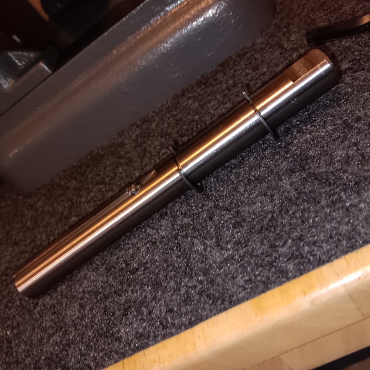

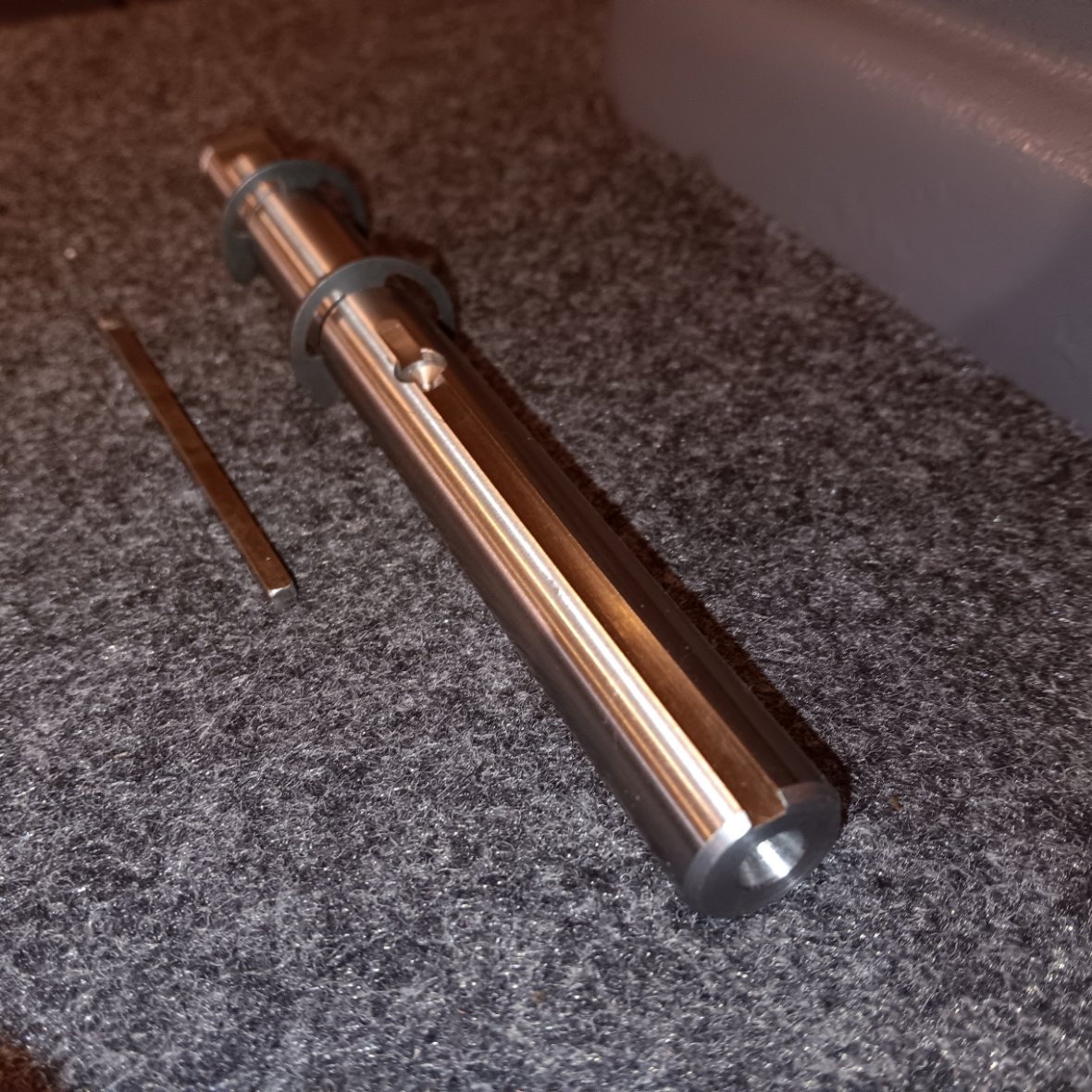

Re: Mark VII Idler Shaft Damage
Here are a few pics of the first completed shaft for JPG.
- 20240303_160611.jpg (384.25 KiB) Viewed 5339 times
- 20240303_160913.jpg (223.44 KiB) Viewed 5339 times

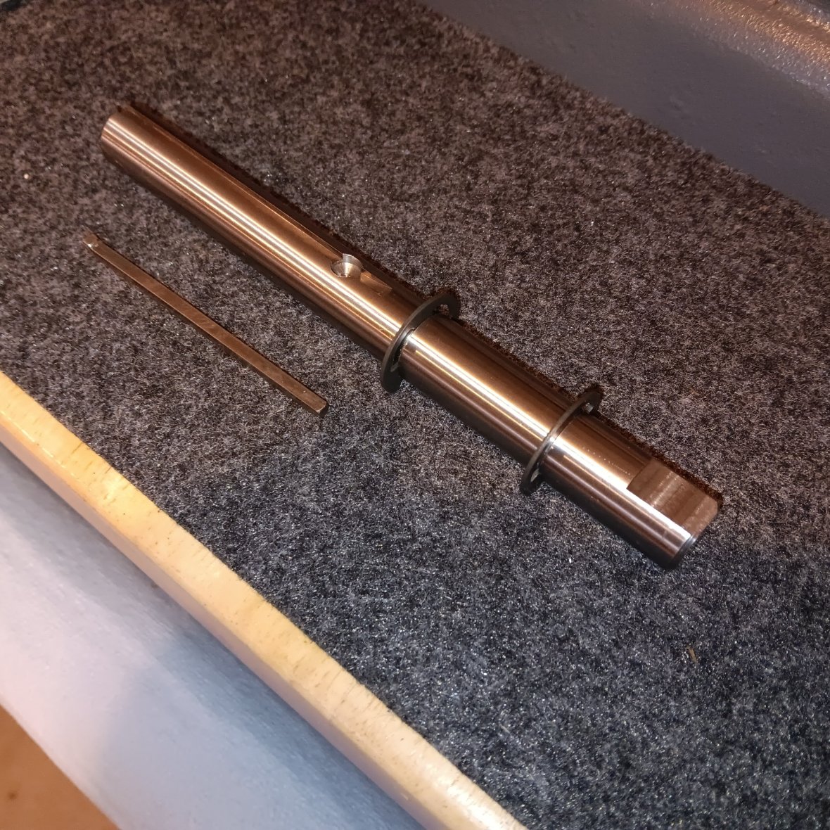

Here's another one.
- 20240303_160642.jpg (286.32 KiB) Viewed 5338 times
