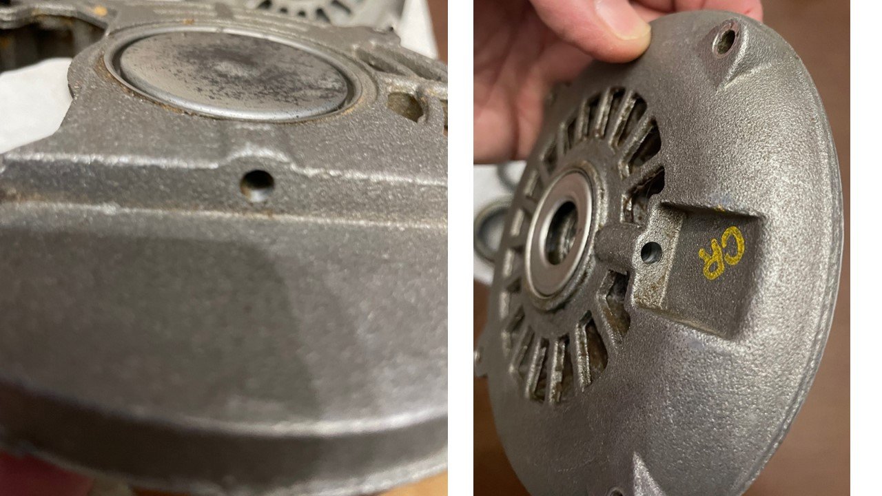

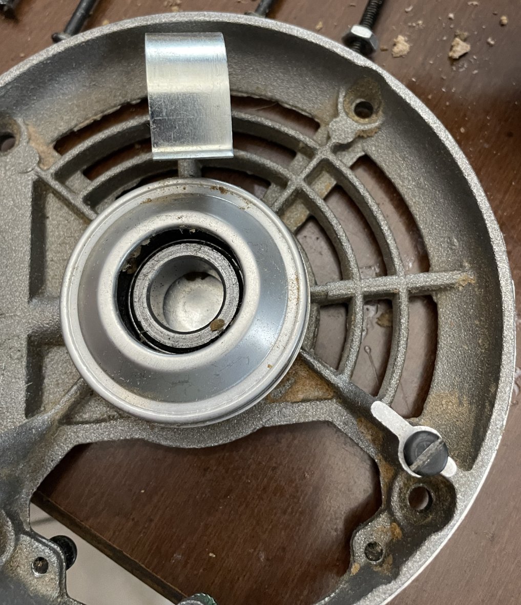

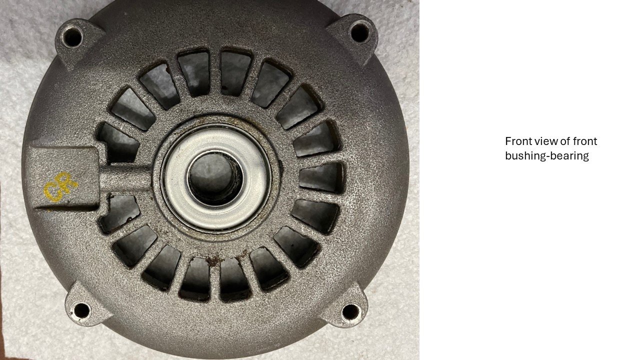

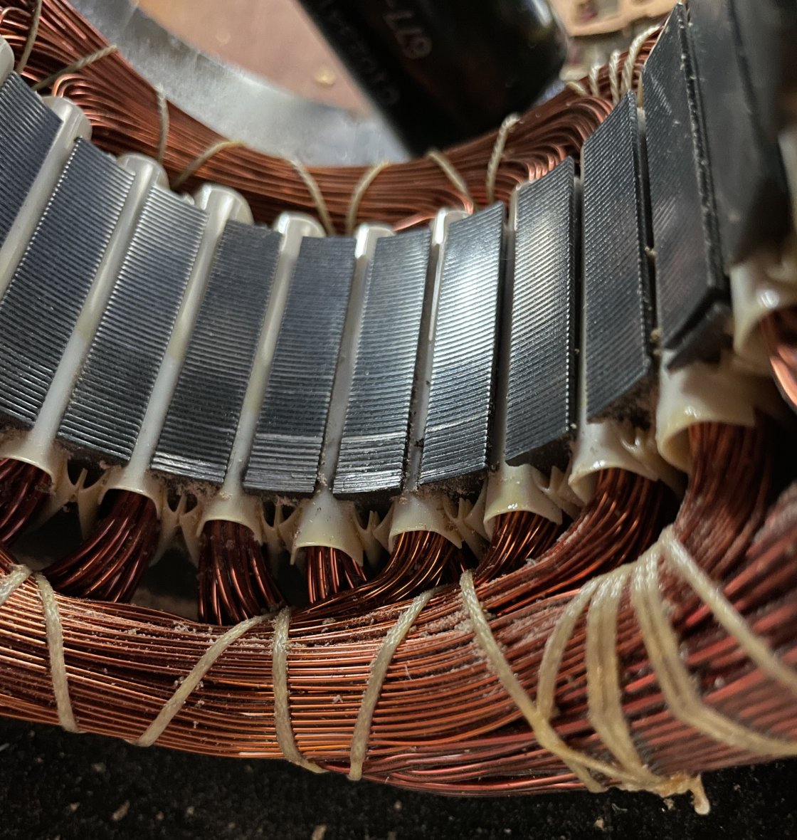

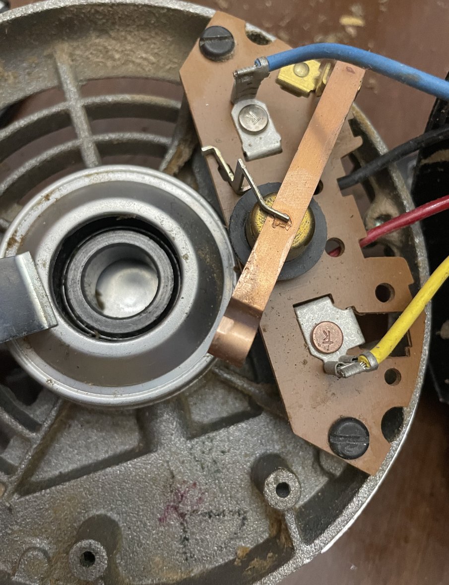

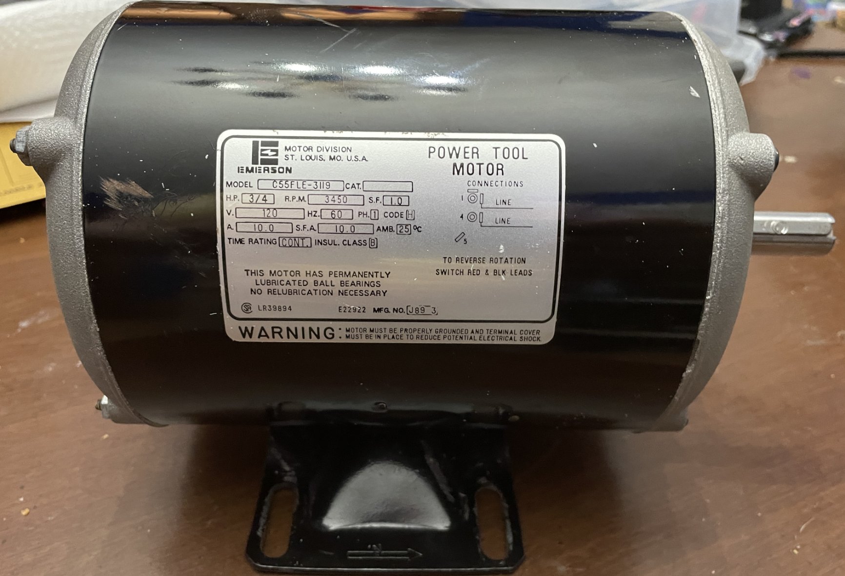

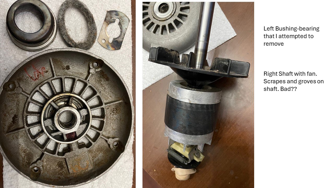

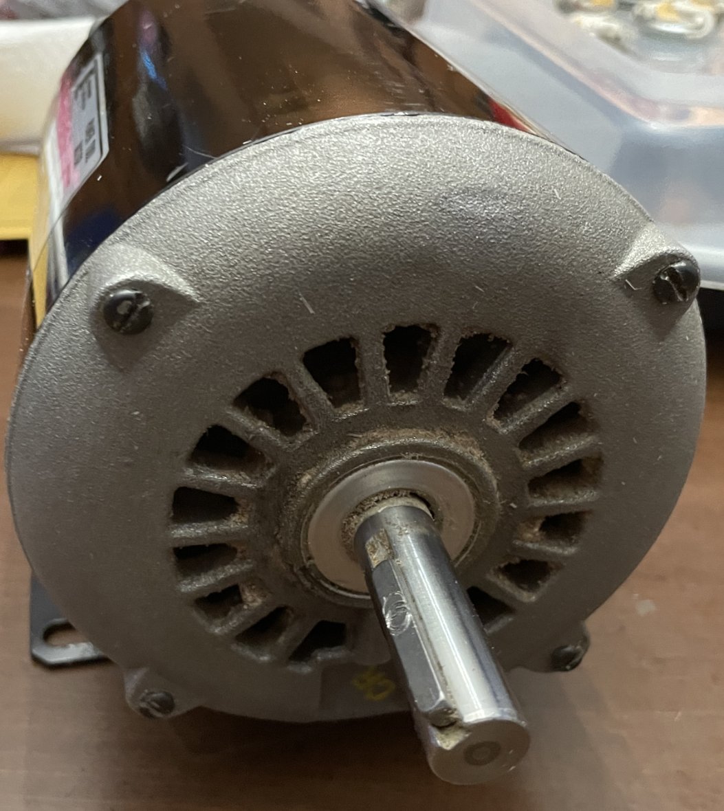

The 3/4 hp Emerson motor on my power station seized up completely. One second happily cutting away with the band saw, then it came to a screatching hault; nothing but a buzz sound coming from the motor. Cut the power ASAP. Spent the past couple of days trying to understand what I need to do to get it up and going again. I learned that it's not the typical motor frequently shown/discussed in this forum or youtube. The nameplate claims to have "permanently lubricated ball bearings", and the user manual reads that no maintenance of the motor is needed. I know little about electric motors except the basic physics and wiring behind them. I've never rebuilt a motor or replaced bearings on them, but I have on cars, trucks, etc. Not afraid to try and mess up. Took apart the motor (with some effort...really seized up on the shaft), and I noticed that it does not appear to have ball bearings at all, or at least to the best of my limited experience. Looking in other forum posts I believe it has packed bushings on both ends. In my ignorance I attempted to remove what I thought were damaged bearings, so I believe I may screwed things up more. I tried using a torch, removed the packing material, pounded on what I believed were bearings with hammer, etc. I'm about to give up with rebuilding this motor. I can't seem to find instructions on how I go about replacing these bushings or even if they can be replaced. I'd love to avoid spending the money on a new motor, but short of getting help and instruction on what needs to happen to get this motor up and running again, a new motor may be the easiest fix. I'm also confused by why it reads it needs no lubrication, but I see what appears to be lubrication holes on both bell ends and what looks like a path for oil to travel to the bushings. That said first question: Any recommendations on where to buy a new motor that works with the power station (specs to shop for etc. too)? Second question Could someone point me in the right direction on where I may find instructions, photos, videos, on how I would fix this motor? Pics included.

- Back Bushing-Bearing view 2
- Back Bushing-bearing view 2.JPG (268.99 KiB) Viewed 5996 times
- Wear on coils I think
- wear on coils.JPG (289.36 KiB) Viewed 5996 times
- Back Busing-Bearing View 1
- Back bushing-bearing view.JPG (214.69 KiB) Viewed 5996 times
- Motor Back view
- motor back view.JPG (232.68 KiB) Viewed 5996 times
- Motor Front view
- Motor Front view.JPG (190 KiB) Viewed 5996 times

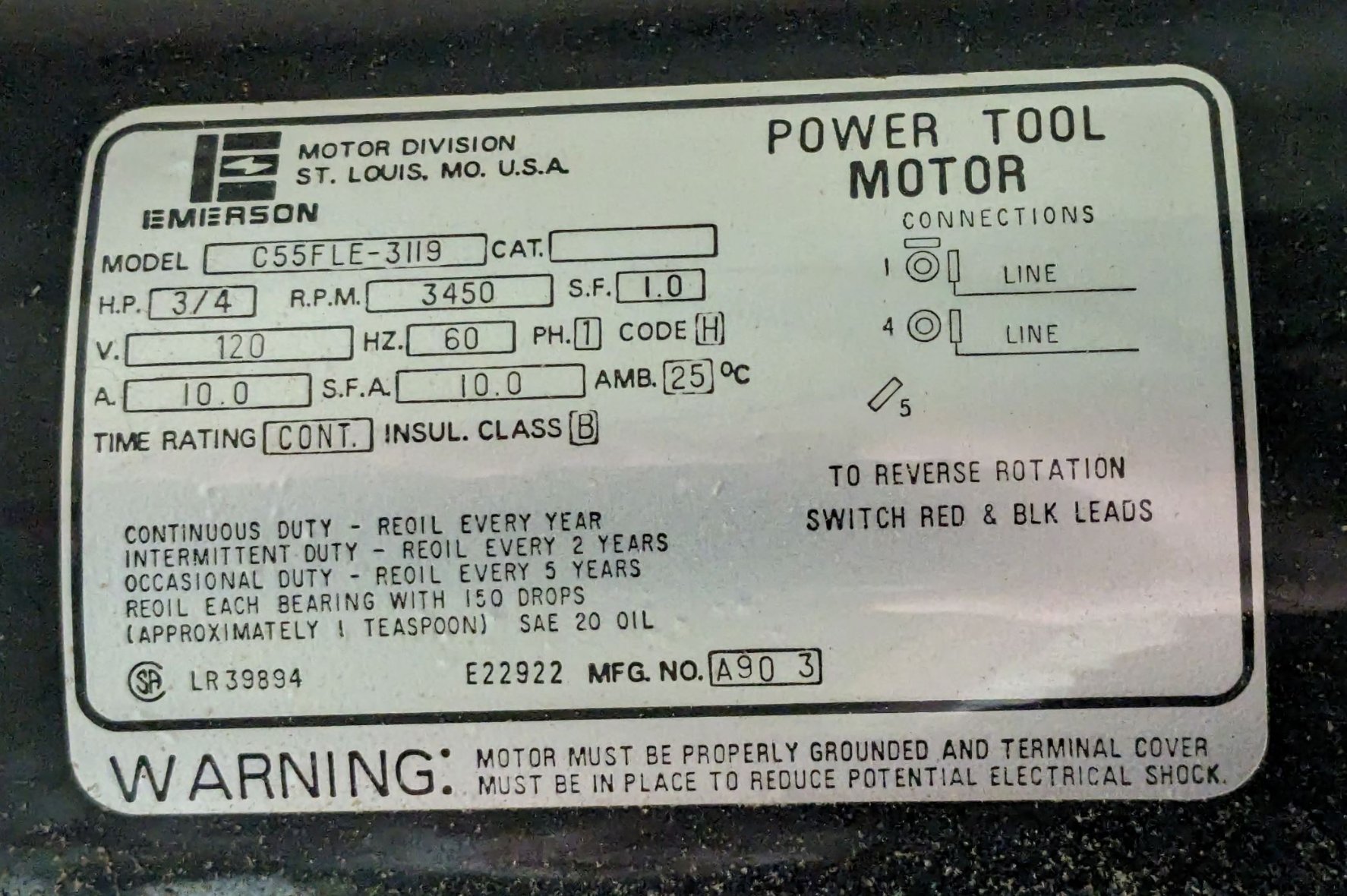

- Motor with Nameplate
- Motor with Nameplate.JPG (271.49 KiB) Viewed 5996 times

- Front bushing-bearing that I attempted to remove and shaft with scrapes and grove
- Front bushing-bearing that i attempted to remove and shaft.JPG (206.57 KiB) Viewed 5996 times
- Front bushing-bearing front view
- Front view of front bushing-bearing.JPG (202.78 KiB) Viewed 5996 times

There is one image of the motor windings that might show evidence of a short in the windings. Can't tell for sure. However, the rest of the motor does not look bad. When you say seized up do you mean physically can not be turned. With no power applied you should be able to spin the shaft. If you can not, the problem is most likely not electrical. If you can not spin the shaft I suggest that you reassemble the motor and take it to a motor repair shop.

If you still have it apart, you might consider just taking the end caps to a motor shop to have the bearings replaced. Any reputable shop has the ability and supplies to do that.

Dusty: Completely seized = couldn't turn the shaft at all, not even with an 18" torque bar. Had to use hydraulic puller just to separate shaft from front bell. Nothing to loose taking it in to an electric motor place...If I can find one around here. RE Oiling: guess that's what I get following the directions.

I recalled that the label on my Power Station motor specified lubrication intervals, but didn't see that on glarson's motor label. So here's a pic that I just took of mine.
Note that the motor model number is exactly the same on both labels. Yet glarson's label declares that THIS MOTOR HAS PERMANENTLY LUBRICATED BALL BEARINGS NO RELUBRICATION NECESSARY", whereas mine specifies oiling intervals. This is inexcusably sloppy documentation / version control by Emerson.
In the "POWER STATION MAINTENANCE SCHEDULE table in my printed copy of the manual (from Sept. 1989), in the "Lubrication" row it states: "No additional lubrication is required, because the bearings are permanenty lubricated throughout the machine." "Sept. 22 '90" is handwritten on the front cover, presumably by the original owner to note the purchase date. So it appears that Shopsmith failed to update their manual after Emerson changed the label, and possibly the bearings, on that motor model.
When I purchased my machine used in 2012, the motor bearings felt and sounded a bit rough. So I disassembled it, and discovered that it had sleeve bearings, not ball bearings. And that they were running dry. But after I cleaned, oiled, and ran them in a little, the bearings felt and sounded perfectly smooth.
All this reminds me that my bearings are way past due for re-oiling, even for "OCCASIONAL DUTY". It's been 10 years now, but I filled the reservoirs with the specified 150 drops of oil at the time, and the bearings still seem happy.
So Dusty, I definitely don't think that you are "wasting your oil"!
