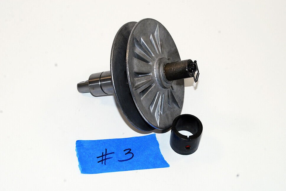

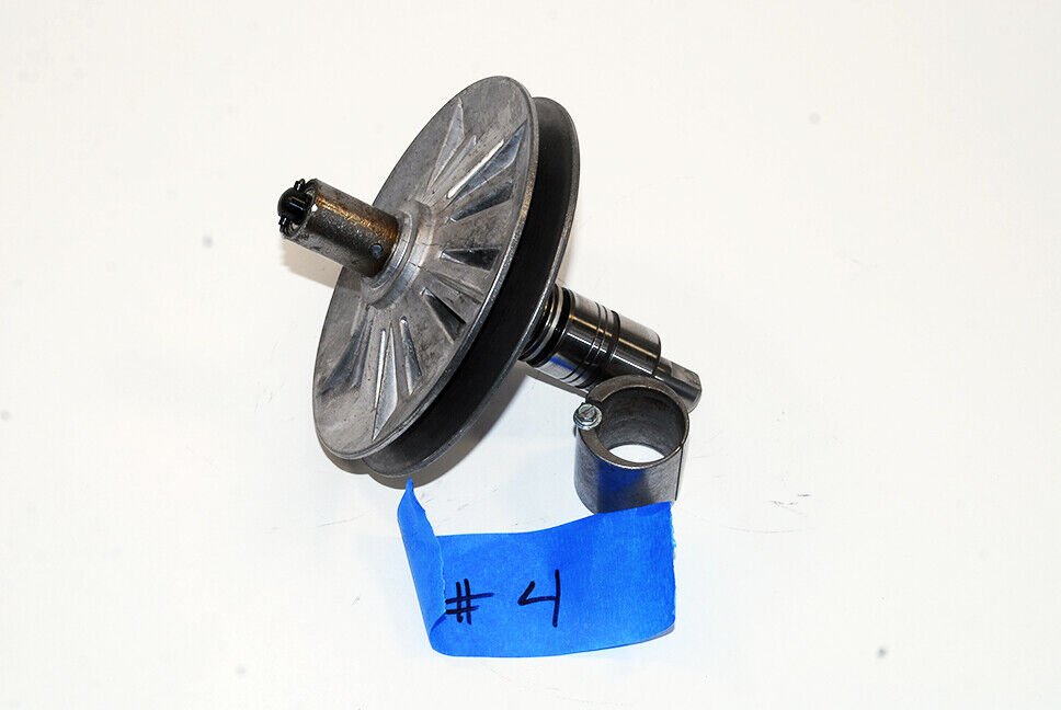

Idler Shaft - These are also generally compatible. If it comes with sheaves, make sure you get a Poly-V and not a Gilmer. If it is the new style bearings it must have a new style eccentric with the split. IIWM I would try to buy the old style bearing with the new style eccentric because these are newer than those with the old style eccentric. Examples:
In these examples, borrowed from current ebay ads, "#4" is newer than #3 but not new enough to have the new style bearings. That, in my view, is the sweet spot.

Thanks. My idler looks exactly like #3. But, you’re saying #4 would be a better choice?
Re: What parts are compatible on 500, 510, 520
Yes, only because the split in the eccentric bushing suggests that it came out of a newer machine. I've not heard of very many Idler bearing failures with the water pump bearing, and I haven't experienced any. I would trust an old one too, but given a choice I'd rather have one that is 15 or 20 years old than 40 or more.tprowood wrote: Sat Mar 30, 2024 3:34 pm Thanks. My idler looks exactly like #3. But, you’re saying #4 would be a better choice?
