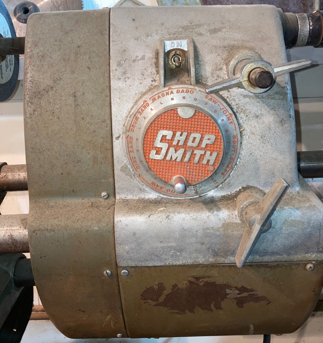

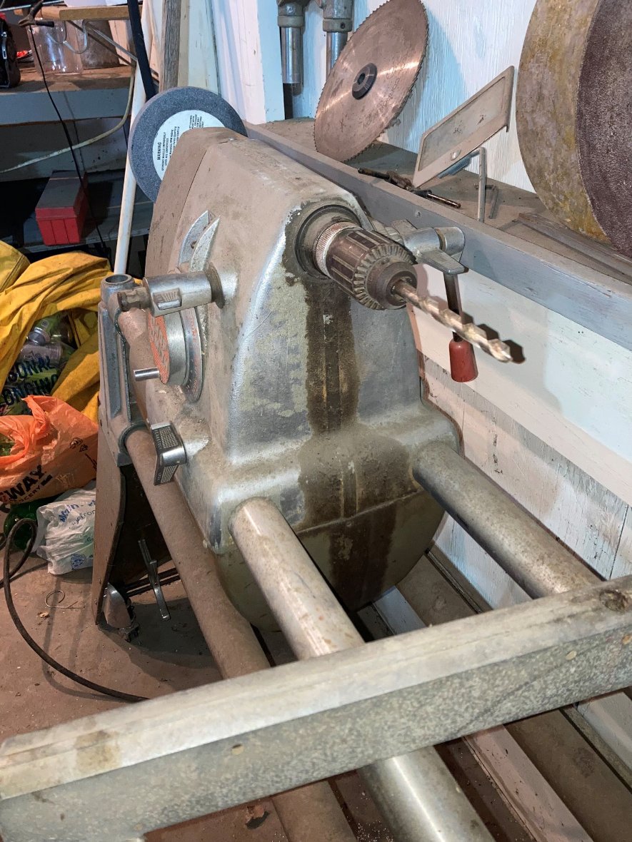

Good afternoon everybody, I found this unit for sale on FB marketplace for $200. It’s about 1.5 hours north of my house. I was up to look at it over the weekend and make sure I wanted to buy it. Seems to me it still works. The motor turns on, the speed control dial works and while the motor is running I could speed up/down. Some light rust on the rails, a small leak from the quill, and needs a deep clean but otherwise seems to be in ok shape. I plan to pick it up and take it home this coming weekend. Serial numbers points me to early 1955.

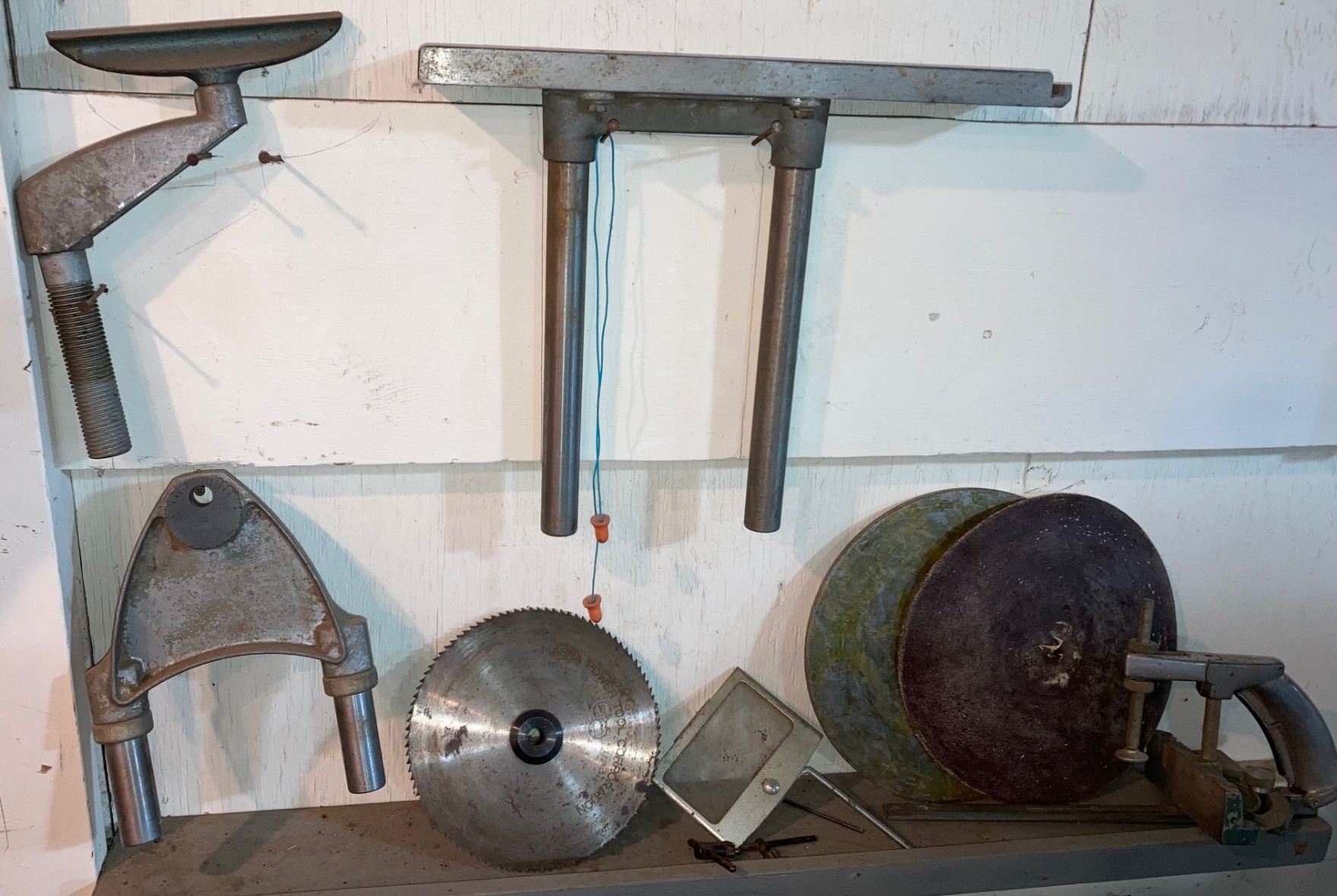

The accessories in the pic are everything that comes with it. I’m missing some of the lathe equipment but not sure what else. Is there anything you can see right away that I’m missing? These are the pics I took myself but there were some on the FB post I didn’t grab before the listing went away. The seller inherited the building this unit has been sitting in for years. From what the seller said, I don’t think it’s been used since the early 2000s. At a minimum it looks like the headstock needs a new seal kit.
My coworker turned me on to the SS and this will be my first step into the fun. What do you guys think? I think I scooped this machine, provided it works.

Is there a fence? I see chuck keys but no chuck. Did you get saw guards?

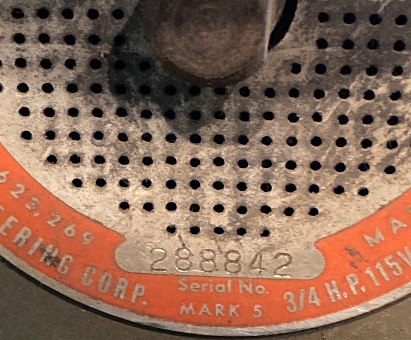

Serial number 288846 was made in January 1955. It is an "A" Headstock which, unless modified, doesn't have the removable rear logo plate to access the Idler Shaft Sheeve and back of the Speed Control Assembly for lubrication. It's the main downside of the "A" Headstock itself. Unless upgraded this 1955 Mark 5 will have the Gilmer Drive as opposed to the current (changed in the 1961) Poly V Drive. It would have the 3/4 HP motor which was standard at that time as opposed to the 1-1/8 HP motor they changed to in the early 1960's. I mention these things because it does present some challenges when restoring these Mark 5 "Greenies" from the 1950's to a good working tool. This is not to say it can't be done. I have restored 2 Mark 5 Greenies (a 1956 & a 1957) to like new condition.
I'm not sure what you mean by,
The Headstock likely needs some TLC and maybe new bearings in the Drive Sleeve Assembly and Quill, especially if they are the original ones. The same may be true for the Idler Shaft Bearing.
From the picture it does have some of the accessories it came with from the factory originally but some are missing like the Fence and Drill Chuck Ed mentioned. Early Shopsmith Mark 5's did not come with Saw Blade Guards but were an option to purchase separately. Many additional accessories were available, and still are, to be able to do more with it.

Could "a small leak from the Quill" be the bearing loosing some kind of lubrication? Maybe someone sprayed lubricant on the bearing to make it turn better but that is a temporary "fix" only. The need for "a new seal kit" has me puzzled by what you mean.a small leak from the quill,
or

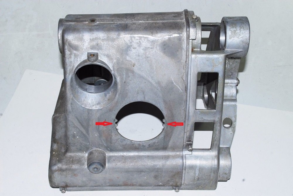

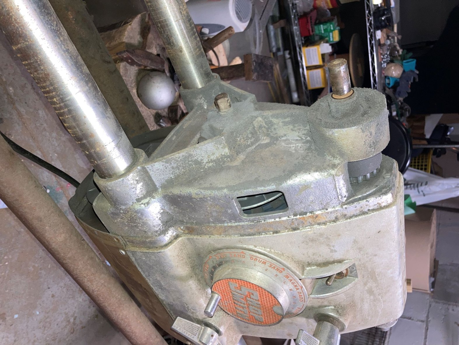

On the topic of the back view port thingy, is there anything preventing me from drilling a hole and 3d printing a dust cap? Can the 'A' headstocks be modified that way?

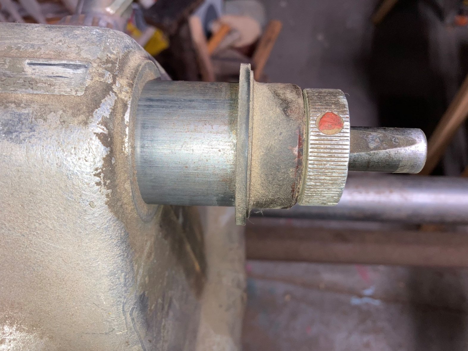

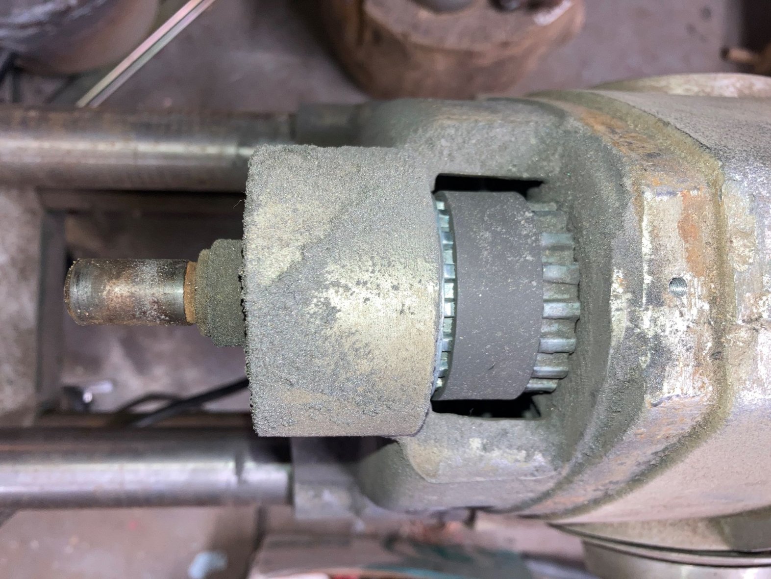

My comment about needing a seal kit mostly comes from my other mechanical hobbies. Most mechanical things have some sort of seal to keep insides in and outsides out. Since that first post, I've read enough to know there shouldn't be anything in the head that would leak. I'll know more once I get it home. Is it possible to buy a bearing kit that includes bearings, belts, seals, other accoutrements I need. I do plan to update the quill to the two bearing setup.

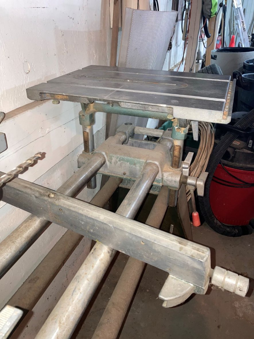

There is a fence, I do have the table, there are chucks, as far as I can tell all I need are the small lathe parts. I have the back mounting bracket thing that the tailstock fits into. I asked the seller if he had seen any of the other lathe pieces and he said he will look as he continued to clean out the building. If that equipment is not found, are their upgrades to the lathe? This is the function I'm most interested in and don't mind upgrading to better aftermarket parts. I do REALLY want a bandsaw but I can wait to pick that part up.

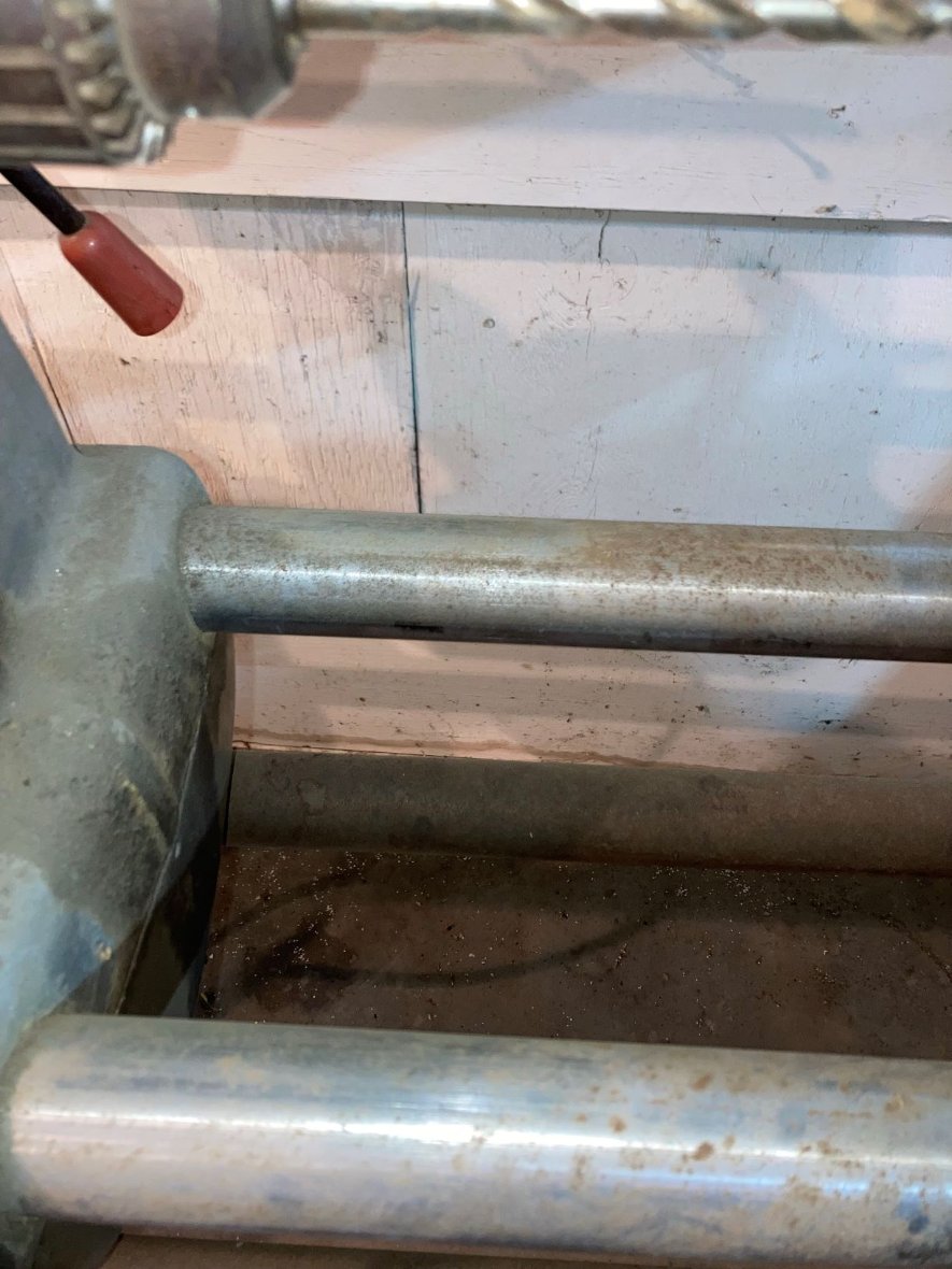

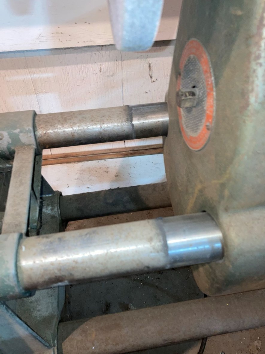

- SS Bars Front.jpg (146.88 KiB) Viewed 15914 times
- SS Bars Rear.jpg (138.36 KiB) Viewed 15914 times
- SS quill leak.jpg (235.83 KiB) Viewed 15914 times
- SS Table.jpg (193.98 KiB) Viewed 15914 times

I recommend drilling a hole in the back of the headstock. Horizontal boring mode with a bi-metal hole saw would work great, if you had another Shopsmith

Adding the access hole behind the logo plate on the back side of the Headstock can be done by marking the hole diameter and drilling holes around the diameter leaving a spot for the logo covers pins as seen below on the "B" Headstock in the picture. This is the same spot that the pins of the "A" Headstock cover go through. Filing can then round out the rest of the hole. The hole itself is slightly smaller in diameter than the cover.
_ .
Doing it this way you can get a logo cover from a "B" Headstock to replace the one you have. The only difference between the "A" and "B" Headstock cover is the addition of the retaining clip on the "B" cover that snaps it in place.
As for painting it the finish is a hammered finish paint. Rust-oleum Verde Green has been a popular replacement for the original green color but was discontinued by Rust-oleum a couple years ago. There have been rumors that they were bringing it back. Verde Green is not an exact match and a little bluish than the original green color. Rust-oleum Hammered Finish Silver will match the silver painted parts. The Way (upper) Tubes are polished metal and the Bench (lower) tubes were painted plain silver. Shopsmith sells a Dark Green Spray Paint (12 oz) PART #522843, but it is not a hammered finish. You could choose to use it and try Rust-oleum's Hammered Finish clear coat. I haven't tried that yet so I don't know how well it would work so test it first.
There is some oil stains coming down the Headstock from the Quill but not a leak from the Quill.

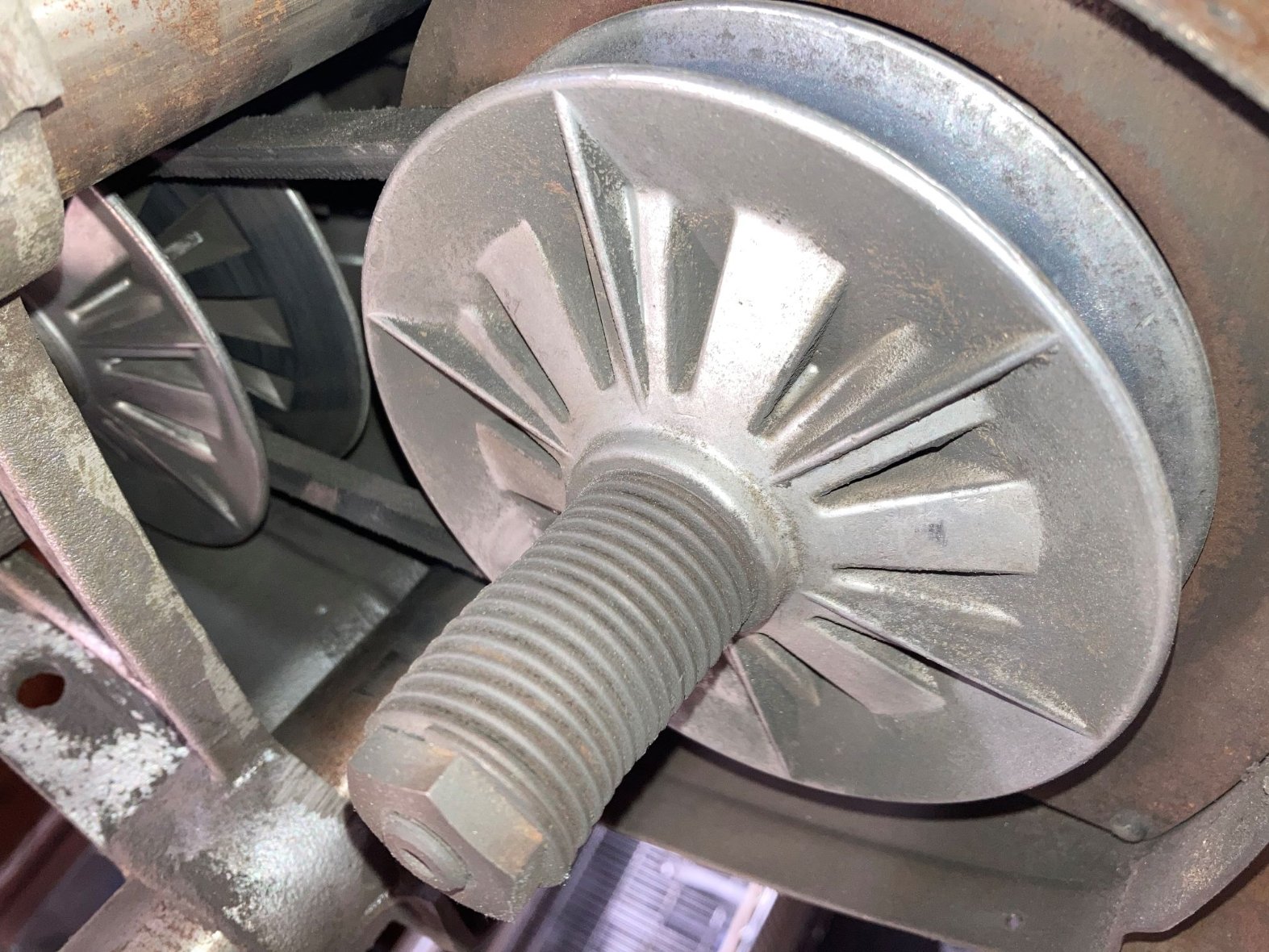

You asked about the Gilmer Drive and if you would be missing out on anything if you upgraded to the Poly V Drive. Functionally the answer is no but it would no longer be original. There is a reason they changed to the Poly V Drive system. Early Gilmer Drive Sleeve Assemblies did not have a clutch and tended to break belts. A clutched Gilmer Drive Sleeve Assembly was added to help prevent this but the Poly V Drive is better. Since you want to change to a Double Bearing Quill upgrading to the Poly V Drive at the same time would be the best way to go. Changing a Gilmer Drive Quill to two bearings has been done but would require some machining. A cost that could better be used to upgrade to the Poly V Drive. The Quills of the Gilmer Drive and Poly V Drive have a different number of Splines and are not interchangeable. To change to the Poly V Drive you would need a Quill (you said you wanted a double bearing one) Drive Sleeve Assembly and Idler Shaft Assembly Poly V Sheave along with a Poly V belt.

It was the first Gray painted Mark 5's in the 1960's that had the crinkle finished paint. I have a Bandsaw from the 1960's made by Magna American Corporation with the Gray crinkle finish paint although it has been repainted once by a previous owner, so it has lost some of that crinkle texture. It was the Greenies and the Goldies that had the hammered finish paint.

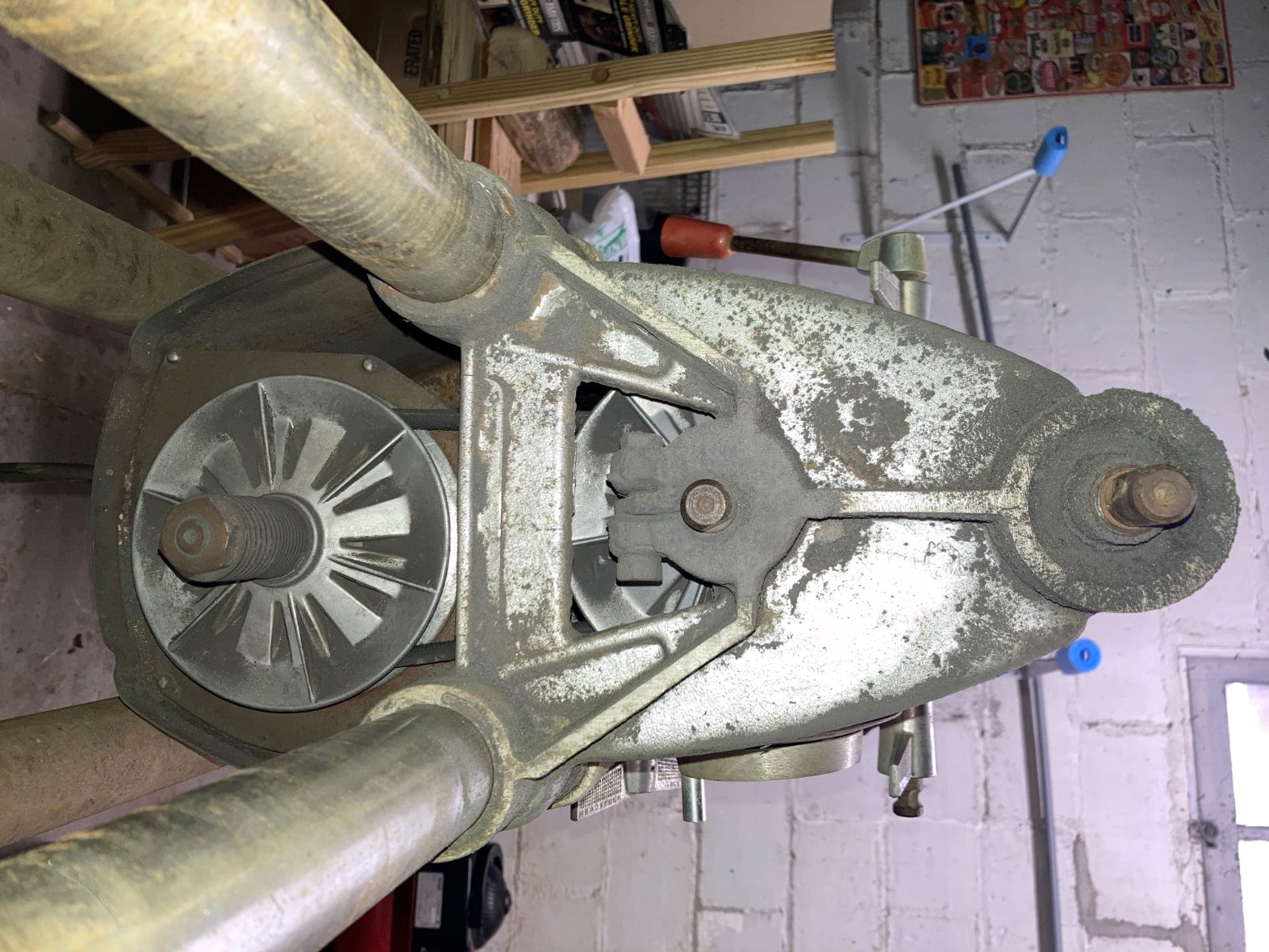

I was able to bring it home Saturday morning and was happy and a little surprised at how good of condition this unit is in. Some more back story, the seller is the son in law to the original purchaser. The seller never saw the owner use the tool and it sat in a climate controlled shop on sealed concrete. I took the headstock off the rails and the feet off the rail assembly. I have yet to find a rusty bolt or anything seized in place. The collar set screws on the drive shaft were tight but I was able to break them open with just hand pressure. I got it home, partially put back together, and took off the back dust cover. Apart from the grinding wheel dust it looks fantastic. The belts seem to be in good shape and they don't appear to be cracked. Once I get the guts pulled out I'll determine if the bearings need any work. If I need to replace any, is there a preferred place to purchase new ones? Did I read correctly that the Shopsmith website does not sell parts (specifically bearings) for the old machines, just the new revisions? If my quill is in good working condition I won't plan to update or upgrade anything at this point.
I do plan to strip the entire unit down, wash, paint, and seal all of the surfaces minus the top rails of course. Is the housing safe to sandblast or is it pretty soft? I've drooled over too many of the pictures in the "rebuilt" forum. I'm curious to know if I can grind down the casting seam in the headstock? I cast metal as a hobby and that seam drives me nuts. Edma, knocking out an access hole in the back of case is going to be cake and I'm not too stressed about that anymore. I was concerned there may have been a reason it would have been more difficult than it is. I was worried the casting would have a rib or something in the space where the hole is going to be. I do have a full sized drill press so actually drilling the hole is nearly a non issue.

- SS Gilner Drive.jpg (329.29 KiB) Viewed 15662 times
- SS Pullies.jpg (352.8 KiB) Viewed 15662 times
- SS Quill.jpg (311.5 KiB) Viewed 15662 times
- SS Rear housing.jpg (360.23 KiB) Viewed 15662 times
