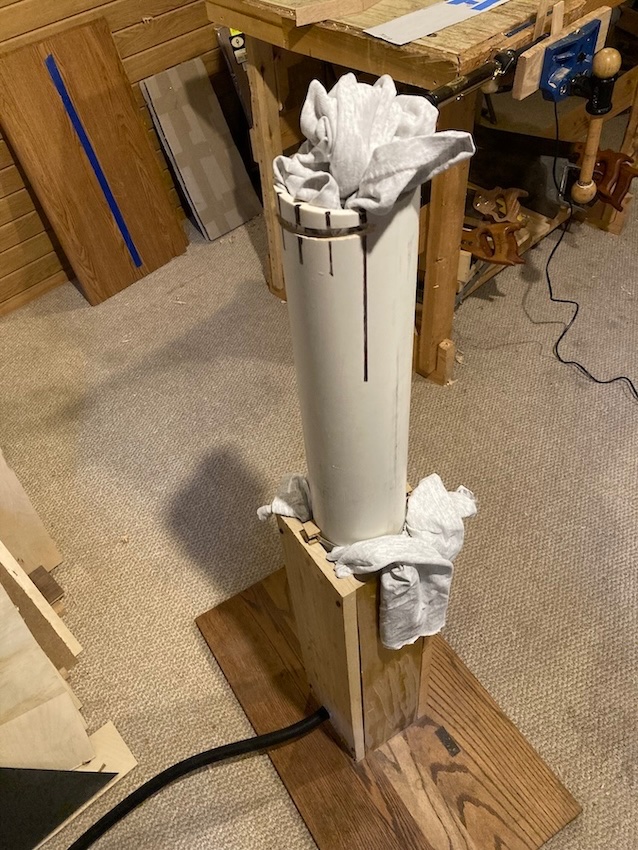

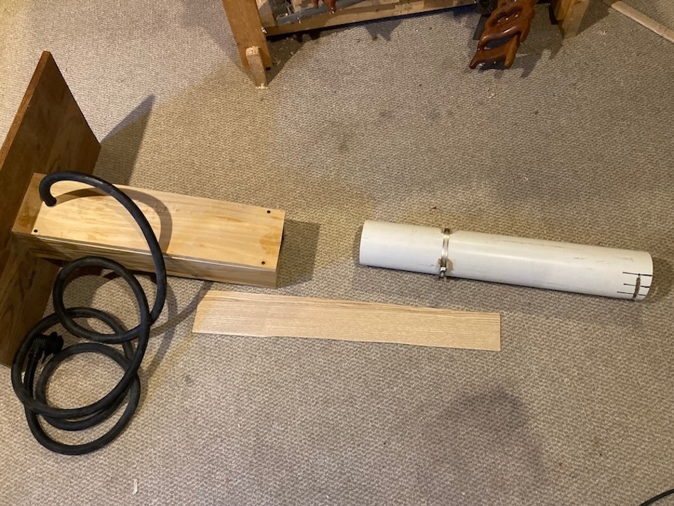

Here's to the Wagner steam-generator! I have one, also.

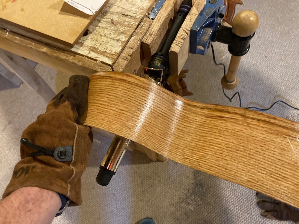

For this project, though, I did my final bending with the primary instrument being an up-cycled Goodwill hot hair curling iron.

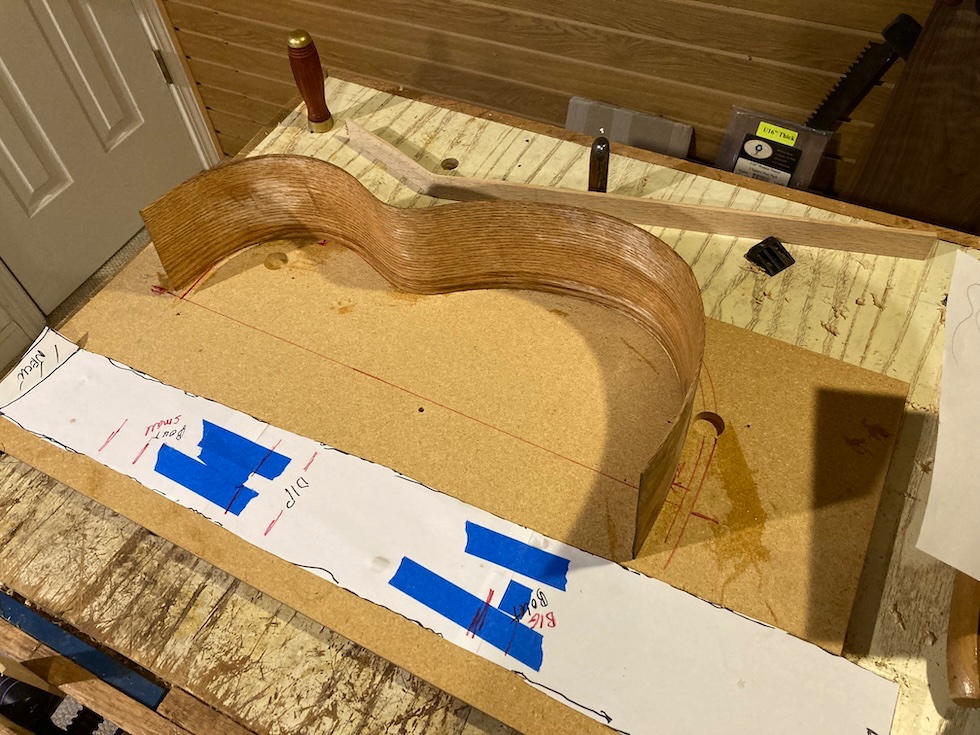

Anyway, sequence more or less as depicted.... for better or worse I've started making another guitar! Yeah, it's oak, and nobody buys oak guitars, but I like domestic woods:

1 down, one to go?
Looks damn good to me. Let us know how it sounds.
