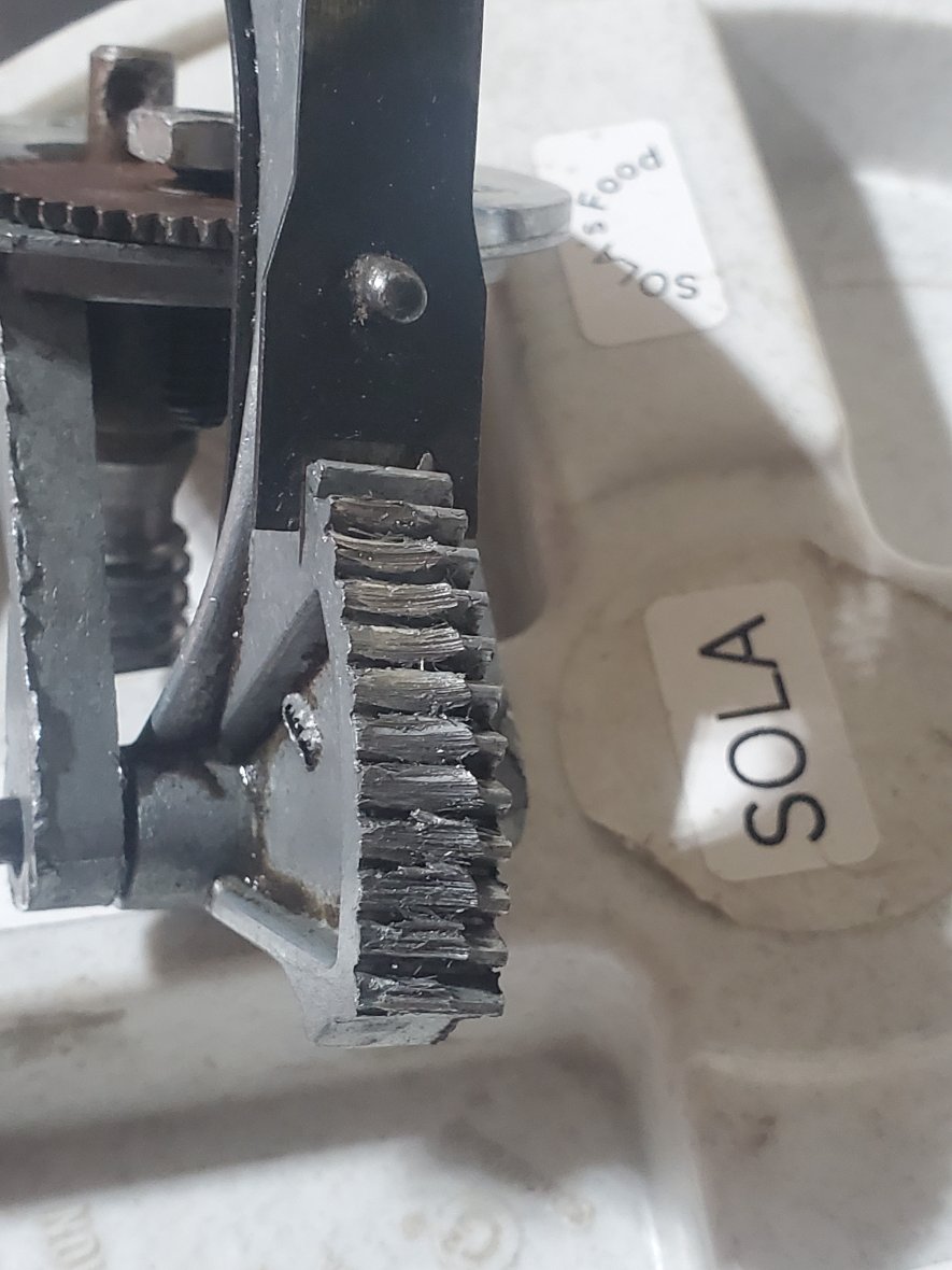

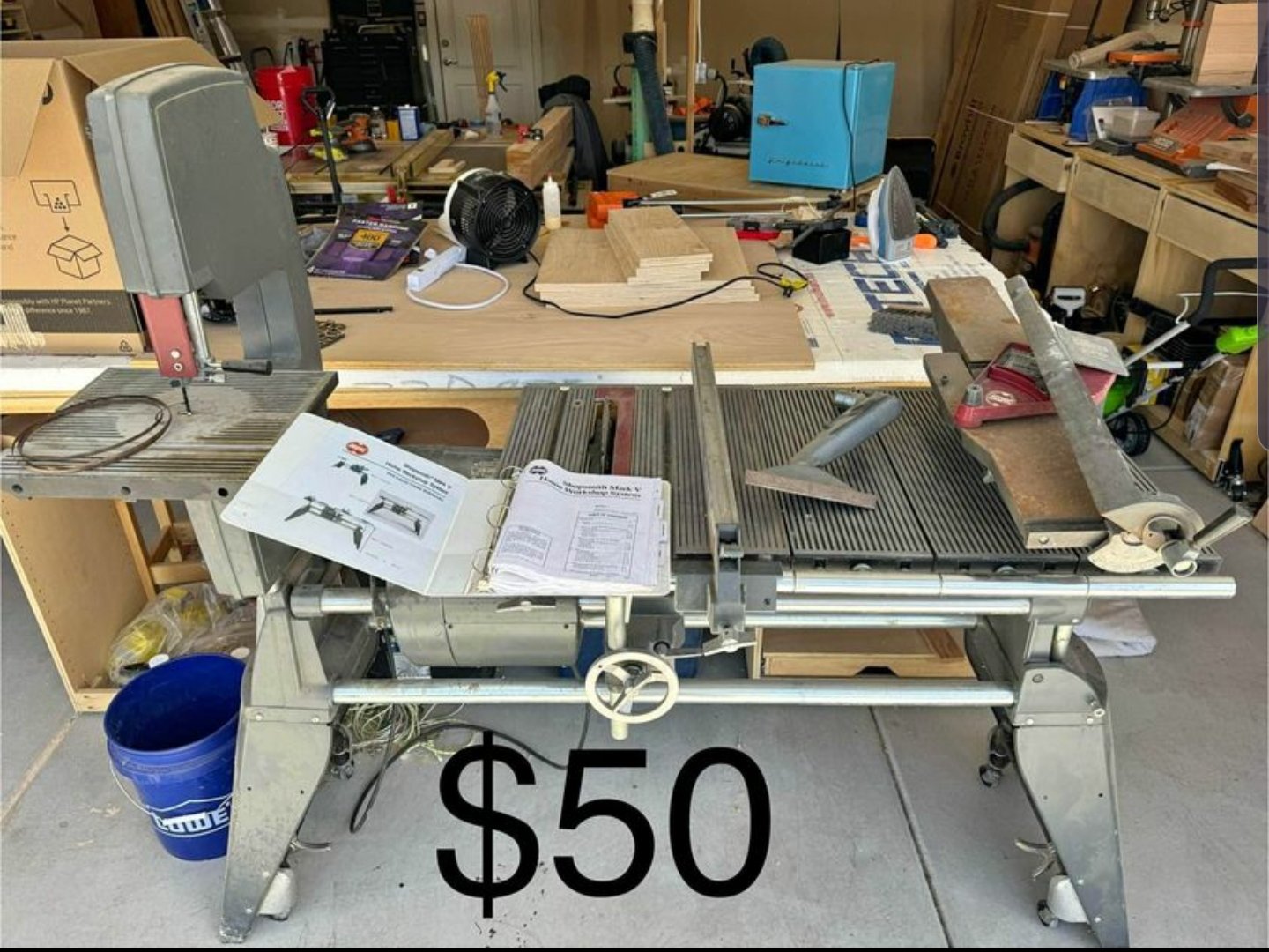

I recently discovered the existence of Shopsmiths. They are a perfect size to fit into my workspace, so I am going all in. I was "lent" a 500 from a friend for an undetermined amount of time. It had a fair amount of rust and the speed quadrant was basically destroyed. I went about removing the rust, cleaned and lubricated the motor, and replaced the speed quadrant. It was missing a fair amount of accessories, so I was constantly searching the used market (no disc sander, lathe attachments, or band saw). I was able to find a 510 on Facebook for $50! It came with the band saw, ProTable, jointer, and a lathe tool rest. So far, I am blown away in the improvements of the 510 versus the 500; it is quieter, larger table, and actual dust collection ports. At this point, I will be returning the 500 but borrowing some of the accessories. I have a few questions for this community, so I can get the most out of my 510.

- Busted speed quadrant
- 20240327_175717.jpg (118.13 KiB) Viewed 3091 times
- Shopsmith 510
- Screenshot_20240411-135101_Facebook.jpg (269.76 KiB) Viewed 3091 times

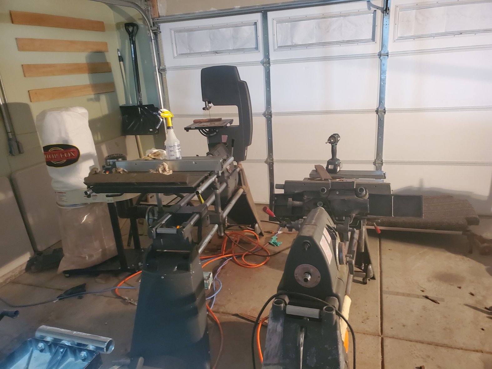

- Both Shopsmith getting repaired in my garage
- 20240414_195244.jpg (217.22 KiB) Viewed 3091 times

A 510 with a bandsaw and joiner for $50 is a fantastic deal. Tailstocks are all interchangeable. You will want a 12" sanding disc, it is one of the best features of a Shopsmith.

That is one very bad looking Speed Control "porkchop" you are showing there. Did you replace just the "porkchop" or the whole assembly? If it was just the "Porkchop" replaced how are the other parts "fitting" together. Excessive play may have caused that damage and if not corrected will happen again.
