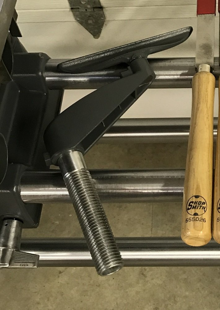

I have a Shopsmith MarkV Model 500 1982. I inherited this from my father. I am missing the lathe tool rest and assorted pieces. What tool rest would be compatible with this model? I have also have a couple of other questions.

Below is a picture of a Lathe Tool Rest Assembly from a Mark V made in March 1982. This is from the original Table System later refered to as the Mark V 500.
_ .
They have the "threaded" Post and a shorter Arm than the other Mark V models 510/505, 520, Mark 7 & Mark 4. The 8" Tool Rest itself is the same for all Lathe Tool Rest Assemblies.
_ .
