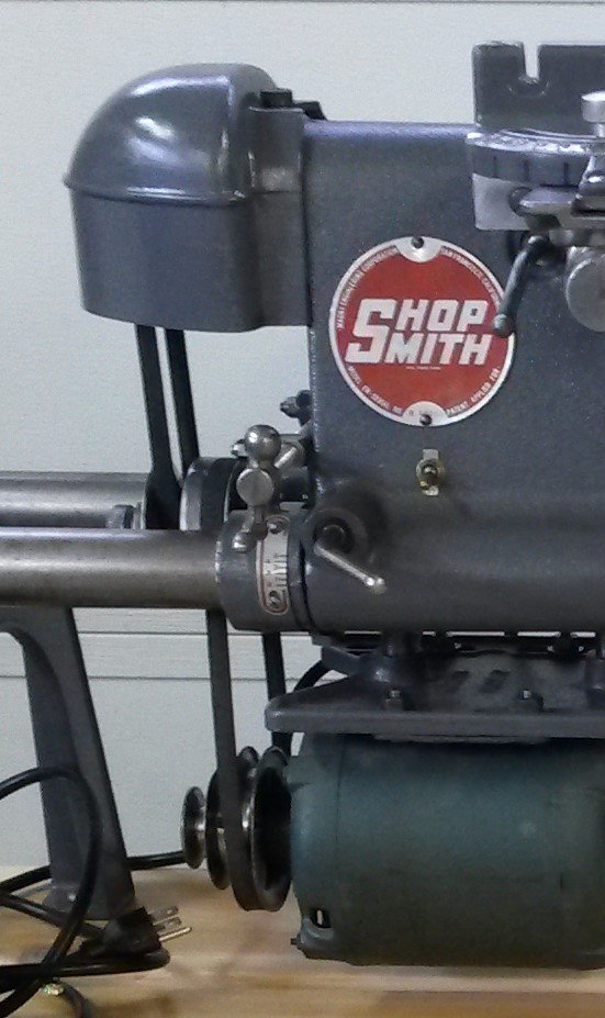

As JPG said pictures would help describe the problem you are having. I have restored 24 Model 10E and 10ER Shopsmith Tools some with and some without the Speed Changer and none required a different motor mount from the original that comes on the Model 10's. It has slots for the motor to mount on and with the slots (90 degrees to the Motor Mount slots) that come on all the brands of motors I have seen on Model 10's there is not a problem aligning the pulleys and belts. Those motors include mostly A. O. Smith 1/2 HP, some A. O. Smith 3/4 HP, GE, PowrKraft (Montgomery Ward) and Craftsman plus a couple other brands. The picture below shows a Speed Changer in place on a Model 10ER with an A. O. Smith Motor. Although the belts look out of line it is the angle of the picture making it look that way.
_
Speed Changer in place.jpg (88.63 KiB) Viewed 1137 times

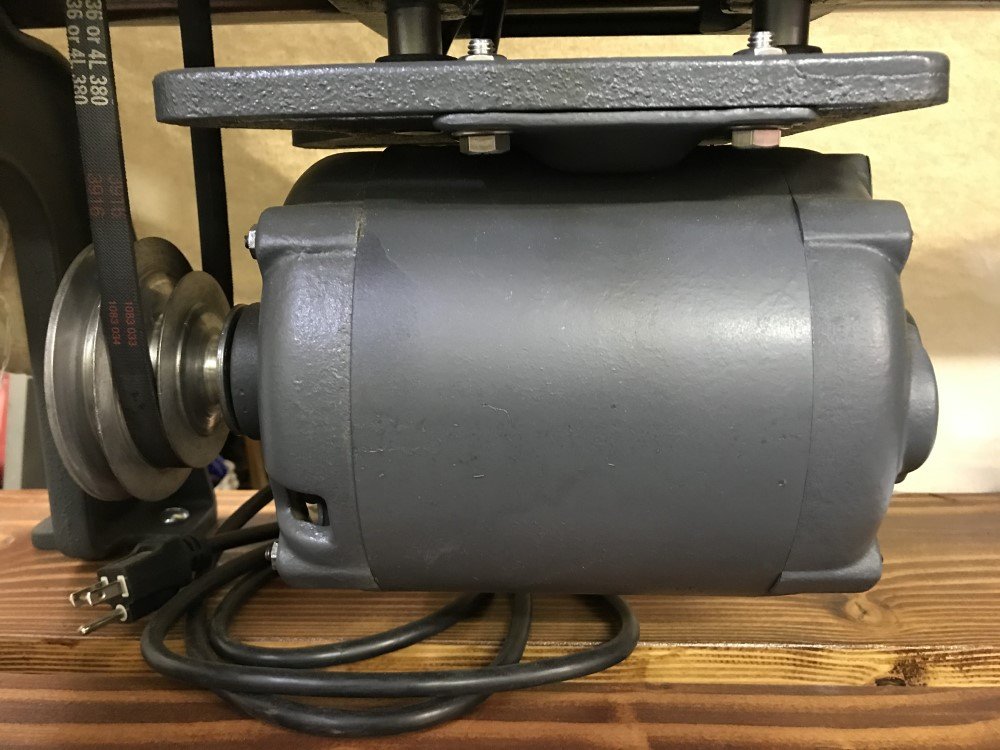

The picture below shows a typical mounting of a Motor and the Pulley orientated for use without a Speed Changer.
_
A O Smith 1-2 HP Motor r.jpg (124.95 KiB) Viewed 1024 times
You can see it is in nearly the same position as the Motor mounted in the picture in my previous post.
