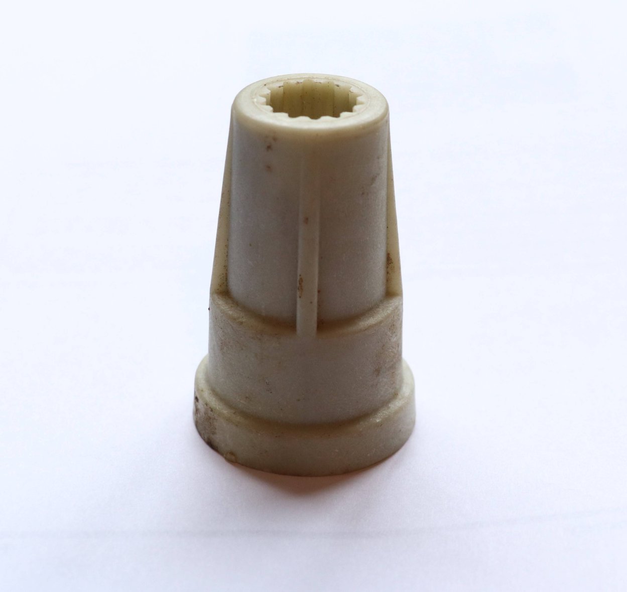

Today, I think I learned that there are at least two versions of the Drive and Ring. I might have them mixed up, but I think this one has been in my parts drawer for 40 years since I mistakenly bought it for my Greenie, and I think it is the same as one I received recently. Externally, it has some differences from the one Russ posted:
Drive and Ring.jpg (73.16 KiB) Viewed 4053 times
- David

So I tried installing the new part and this ring is giving me trouble. Am I supposed to install the drive onto the shaft with the ring already seated in the drive? Or do I put the ring on the shaft first, then put the drive on? If I do the first, the drive doesn't fit on the shaft. If I do the second, the ring wont seat into the drive. What am I missing?

danielsegge wrote: Sat Apr 27, 2024 5:00 pm So I tried installing the new part and this ring is giving me trouble. Am I supposed to install the drive onto the shaft with the ring already seated in the drive? Or do I put the ring on the shaft first, then put the drive on? If I do the first, the drive doesn't fit on the shaft. If I do the second, the ring wont seat into the drive. What am I missing?
The first is correct, the Drive and Ring should install on the Drive Sleeve as an assembly. Or at least that's how I've done it. The ring acts as a lock. The slight chamfer at the end of the Drive Sleeve splines should open the ring to allow installation and the ring should spring closed when it reaches the groove in the splines. IIRC some persuasion is needed to get it started, I used a mallet with a block of wood protecting the Drive. A puller or press that engaged a different part of the Drive would be more ideal. It would be wise to check your Drive Sleeve bearings before installing the Drive and Ring.
