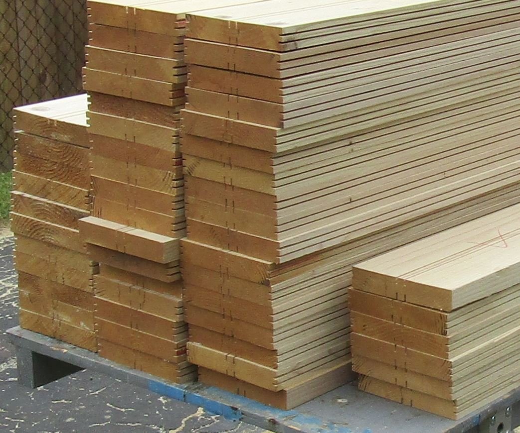

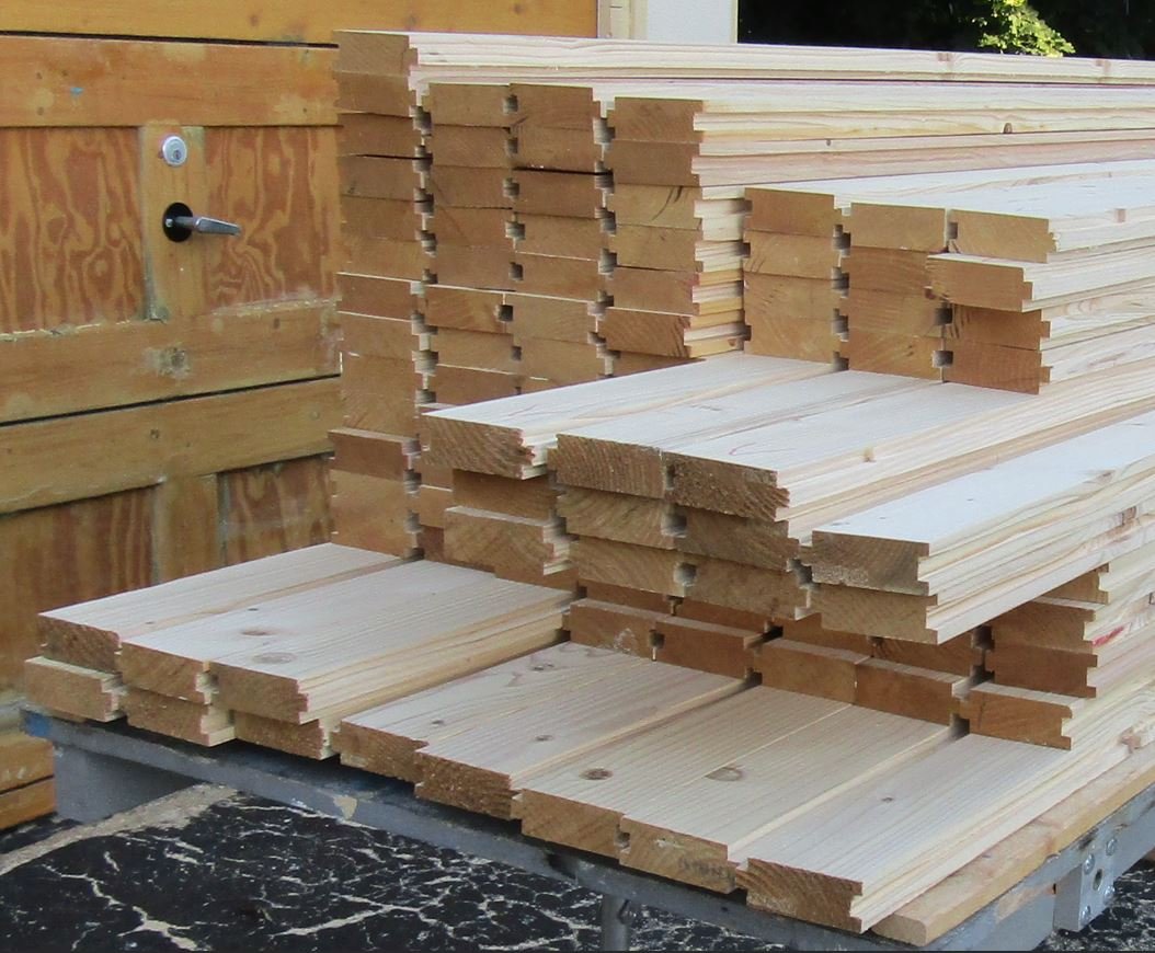

Now I have finally finished milling a batch of tongue & groove floorboards sufficient to do the porch deck. Started with bigbox lumber and milled it down into nice flat straight 1-1/4" thick boards. Shopsmith and I got them to a very uniform geometry.
Next step is tearing off the old floor and preparing all the old joists to support the new floor. May take a long while. This is going to be an edge-banded deck, sanded and then painted. Additional underdeck support will be needed.
I designed the tongue/groove interface to be "loose but not too loose". At assembly I want to prepare these boards to be absolutely rain-tight for life (my life at least). What, at assembly, can I use at the tongue-groove interface to insure this? I have heard about pre-priming the joints at assembly but how is applying wet paint practical at assembly?
Maybe something like a liquid asphalt coating (driveway sealer, roofing tar, marine sealer?) could be pre-applied on the tongues/grooves and stay pliable until assembly, and when assembled would permanently fill up the joint?
If anyone on this forum has used something in a similar exterior tongue/groove build application that actually works, please advise.
2 X 8 MILLED AND DADOED.JPG (187 KiB) Viewed 12232 times
2 X 8 SAWCUT FOR TONGUE AND GROOVE.JPG (188.27 KiB) Viewed 12232 times
CUT INTO TWO T&G BOARDS.JPG (157.86 KiB) Viewed 12232 times
