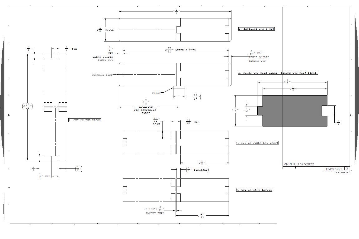

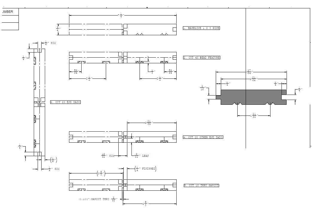

Going the homemade route, I designed sections for the beadboard and the floorboard (see below). Yes they are both hefitier in section than the trad sections but I want them to outlast me.

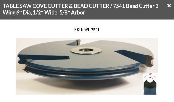

As for tooling, I own a Shopsmith - which makes such homemade millwork possible for me. I would need to buy a rotary bead cutter (see below) but I have a dado set and I think everything else tooling-wise.
But cutting long thin work is generally hazardous and I dread doing it, especially at this scale. And I have never used a bead cutter. How hazardous could it be??

Suggestions as to my design and fab specs for these 2 items are welcome.
- BEADBOARD.JPG (52.3 KiB) Viewed 14599 times
- FLOORBOARD.JPG (64.5 KiB) Viewed 14599 times

- WOODLINE #7541 BEAD CUTTER.JPG (26.21 KiB) Viewed 14599 times

I bet you already know this and have chosen for a reason... I looked at some commercial beadboard product at a local big box (the 'blue' one). I had in mind to use the other side, simple T&G. But, IIRC the profile puts one bead at the T&G joint and one in the center of the board. Contrasts with your profile which has comparable bead spacing but located away from the joint. It is a different look visually, especially if stained. I'm just wondering if what you have chosen matches existing or some other reason? What finish are you planning? (Note, I was not impressed with the millwork on the product.)
Do you have a planer? Having done most of my woodworking without one, I could foresee some challenges getting the T&G fit you want if thickness is inconsistent and you are cutting T&G on a table saw. Depends of course on the extent of inconsistency.

David (DLB), yes, the mfgd beadboard I have seen have the bead located right near the edge; this makes no sense to me but if there is a good reason for that I would like to know (maybe the edge bead is supposed to cosmetically make the board-to-board joint disappear).
I think that edge location (for the bead) would weaken the board. My current old beadboard has the bead near the edge, and it has several edge splits there. I expect my joints will line up well enough to make them cosmetically disappear and then only the beads will appear, equally spaced. At least that is my intent. I expect to finish the ceiling with dye + urethane spar varnish.
Also, no I don't have a planer - or a jointer. I get by with nailing a "cleat" on the board which fits the table t-slot and lets me cut a straight edge. I expect the 1X8 beadboard to be S4S which typically is pretty clean. I am hoping the 2X8 floorboard faces will not need to be planed - floor will be sanded after install.
