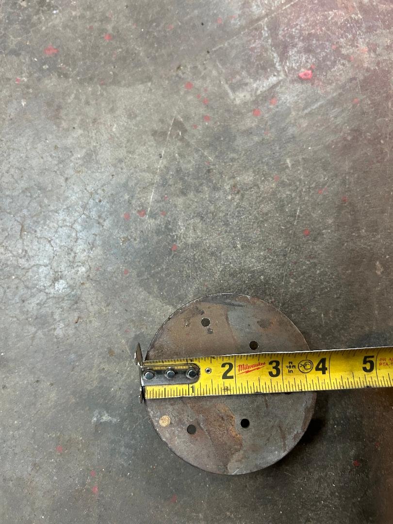

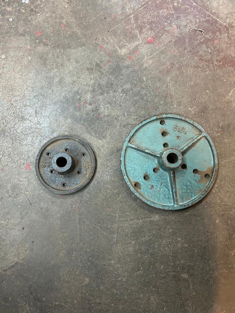

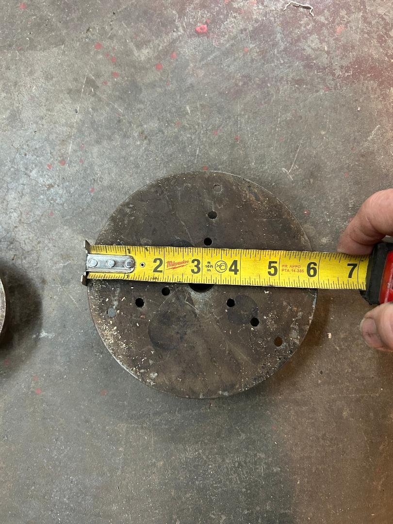

Re: 10E versus the 10ER
Russ,
Maybe they aren't sanding discs at all. Here are some pics of these two items that came with my 10ER. Lathe faceplates?
Kevin
Kevin
- Disc pic 1.jpg (188.85 KiB) Viewed 8094 times
- Disc pic 2.jpg (225.94 KiB) Viewed 8094 times
- Disc pic 3.jpg (273.94 KiB) Viewed 8094 times
- Posts: 35457
Yep! Face plates.
And CI to boot.
And CI to boot.
- Posts: 73
- Joined: Sat Nov 19, 2022 2:36 pm
Yep, CI! I would assume they are pressed or stamped steel today.
Kevin
Kevin
- Posts: 35457
Nope, Cast Aluminum.Real1shepperd wrote: ↑Mon Jul 08, 2024 11:39 pm Yep, CI! I would assume they are pressed or stamped steel today.
Kevin
The conical sanding disk is stamped steel. The flat sanding disk is simply steel(flat plate).

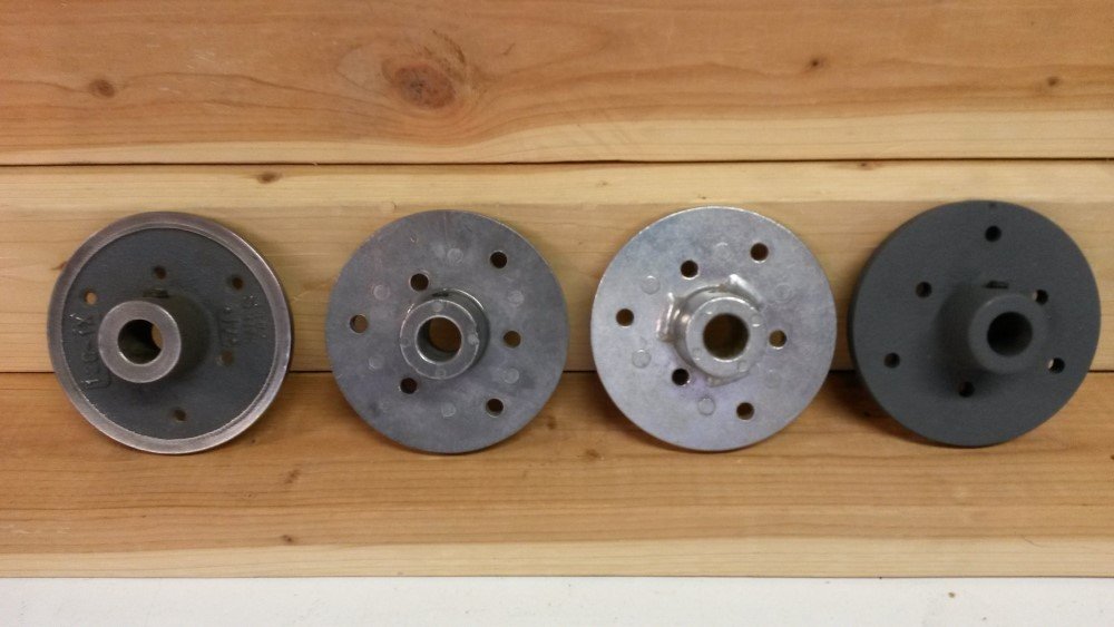

- Posts: 4225
Lathe Faceplates have gone from Cast Iron to Aluminum back to CI. Below are examples of the different 3-3/4" Lathe Faceplates with the most recent one I bought from SS on the right. The CI one on the left is from the Model 10 era. They were changed with the introduction of the Mark 5 Greenie to have the 5/32" Allen Wrench size Set Screw and painted green. If your 3-3/4" Faceplate doesn't have the 5/32" Allen Wrench size Set Screw it was from the Model 10 era.
_
_
