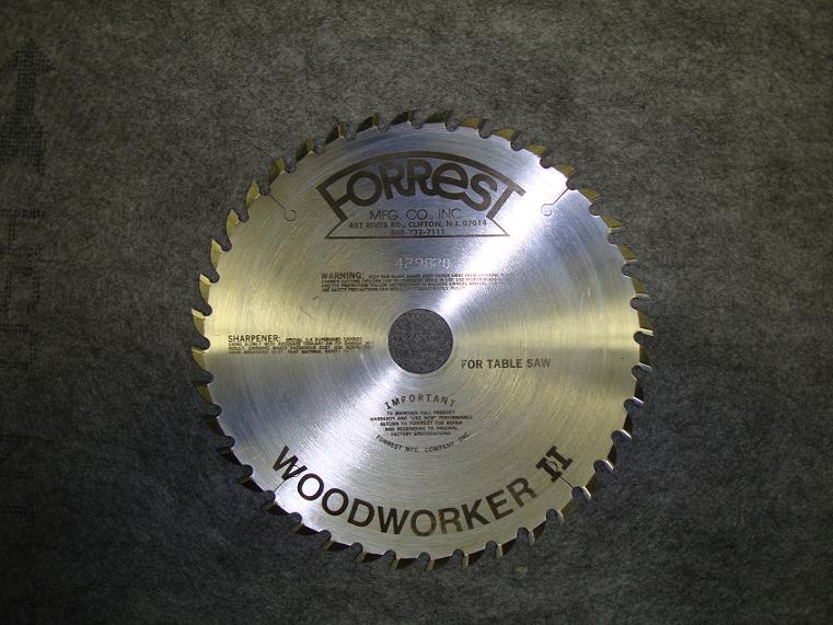

Post by taquin »
[ATTACH]3363[/ATTACH]
Just received my Forrest 9" blade with 1 1/4" arbor.
Wow, this thing is sharp.
