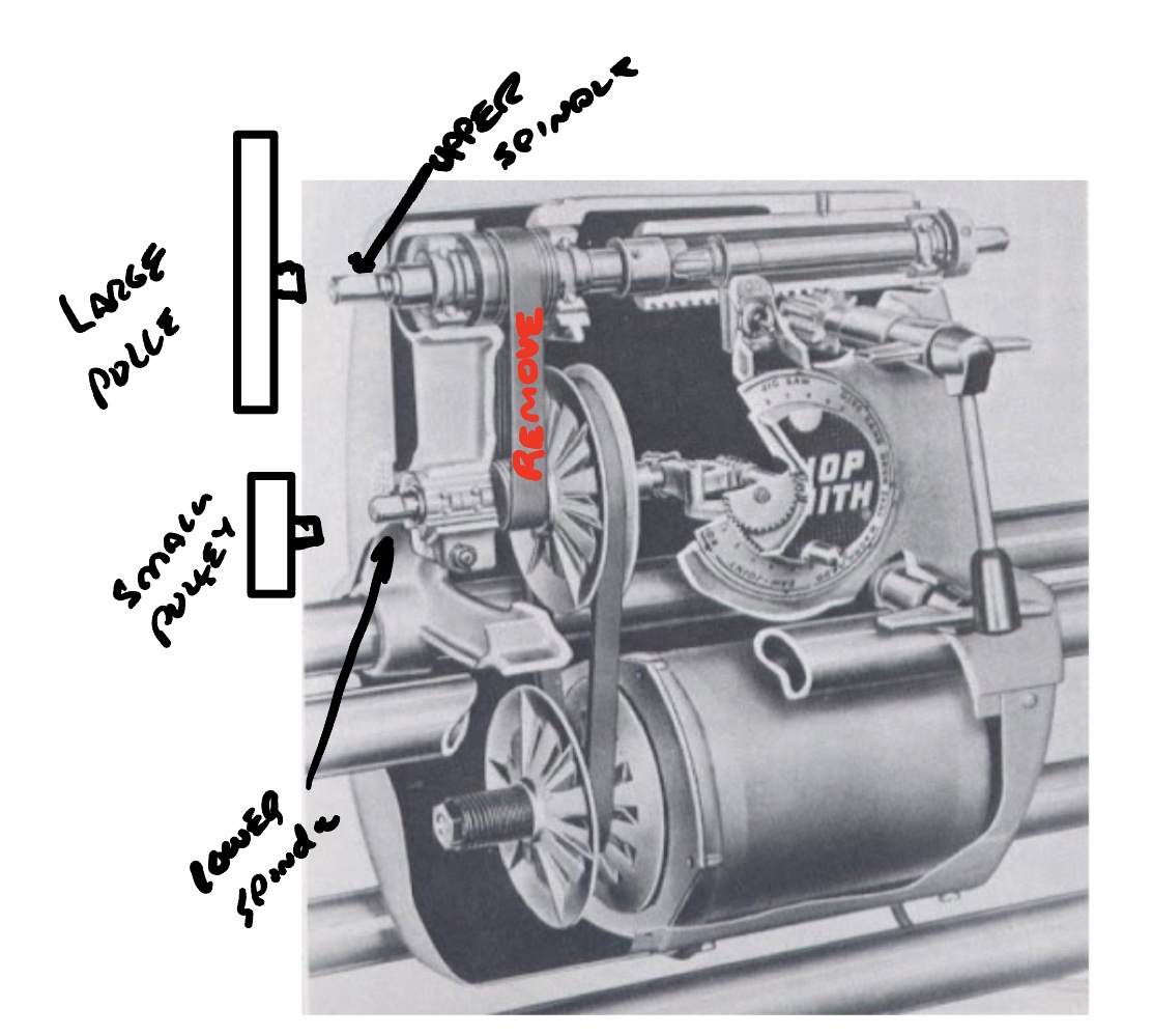

I saw a shopsmith listed in my local classified several months ago that had an interesting modification. The seller used his machine exclusively for lathe turning. It looked like he removed the upper poly v belt but left the drive belt on. The seller had a large pulley attached to to the upper auxiliary spindle and a small pulley attached to the lower auxiliary pulley with an appropriately sized belt connecting the two pulleys. (At least that’s what I remember… but then my kids are always questioning my memory). Essentially he used the shopsmith hubs to make a Jack shaft. I have no idea what kind of speed reductions the seller achieved or even if it worked.

Benmcm - that's what I'm thinking about, but, using a step pulley on each Spindle. I'll post any progress I have.

The shortness of the idler shaft may be a problem.
BTW the upper poly-v(or gilmer) belt needs to be removed and the lower motor v-belt retained.
Pix above accurate, description not so.

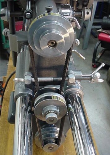

Maybe find and retrofit one of the old style speed changers?
(Photo courtesy of Everett Davis)
