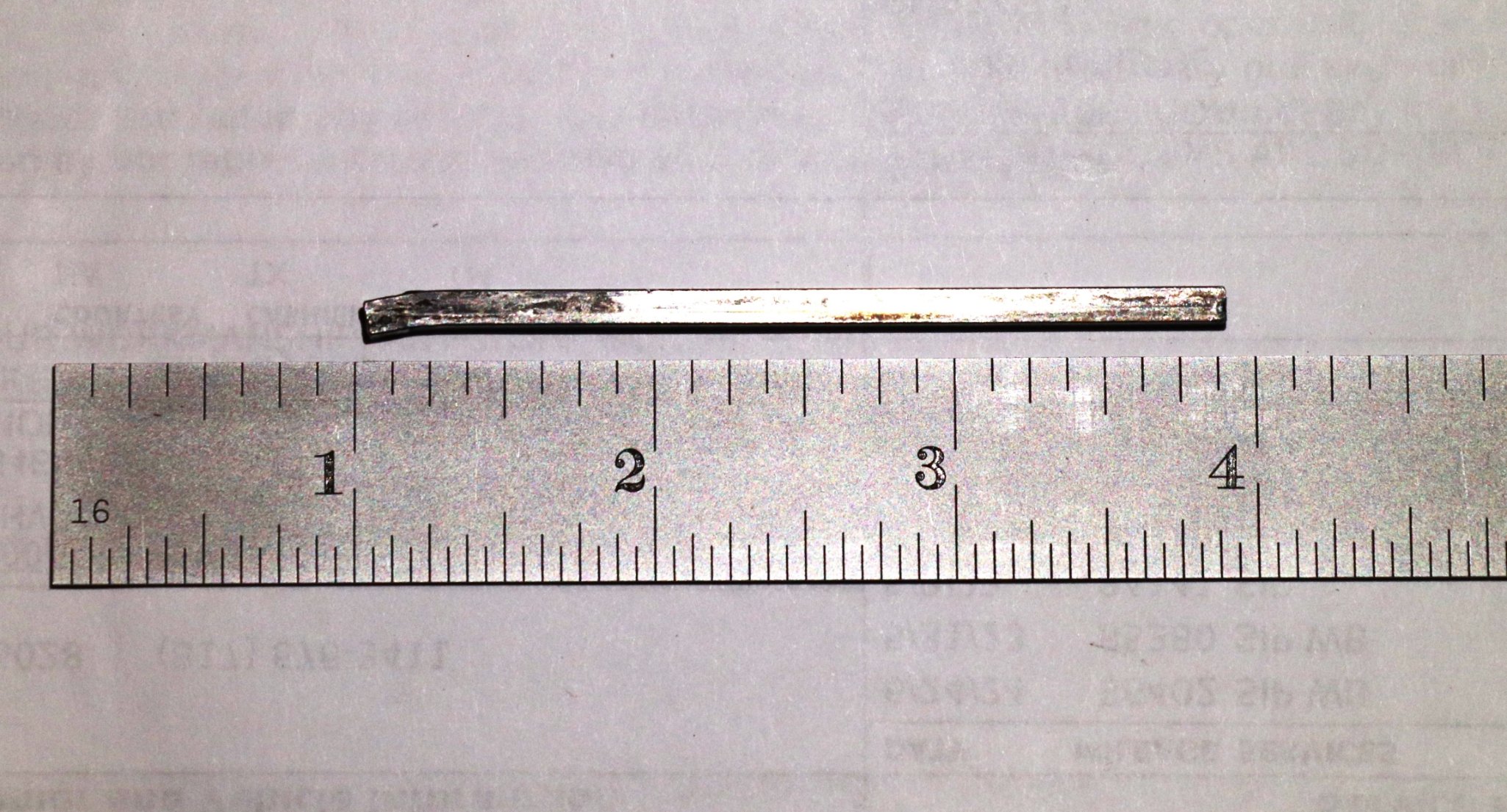

Here is a picture of a standard one, in case that helps you to add the slight bend:
Idler Key.JPG (414.63 KiB) Viewed 1026 times
The bend is small, maybe in the 30 degree range and about 1/8" from the end. Not much is needed since the fixed sheave keeps it in place.
- David

Thanks everyone! David, the picture did help. After bending it, things are humming along nicely. One really nice feature is using the SS head to drive the old Craftsman machines when I restore them. It's so easy to put a hub in place of a pulley.
