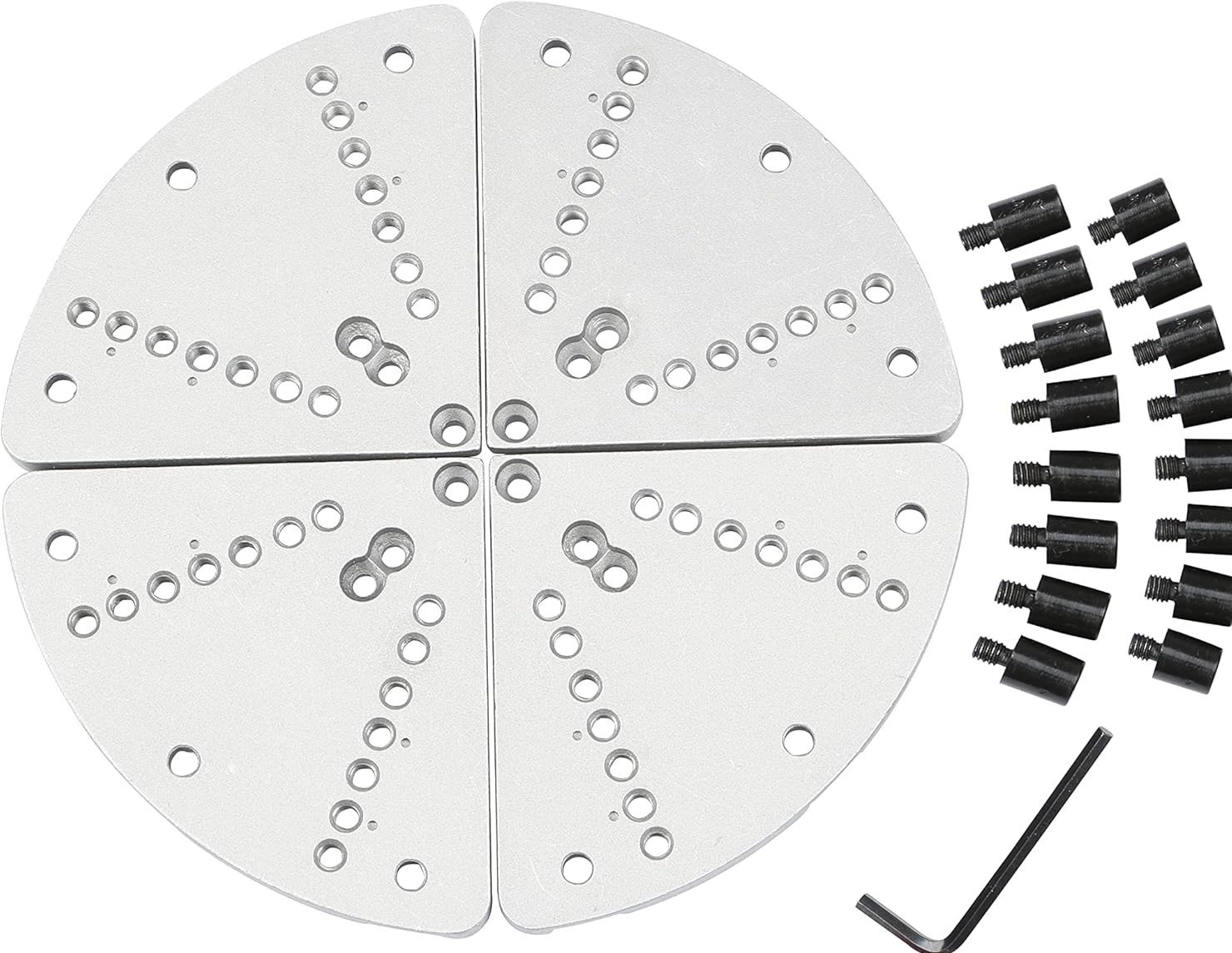

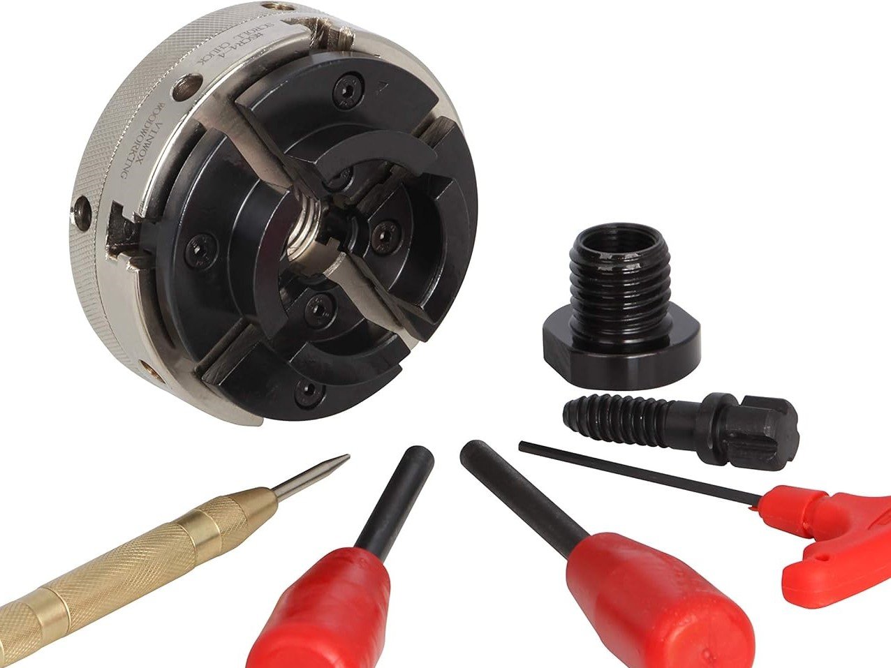

I am looking at chucks for my Shopsmith Mark V.
I found this chuck and aluminum jaws on Amazon in the links below.
Is this a good starter chuck or should I bump up and get a Better one to start out with?
Link to Chuck: https://www.amazon.com/gp/product/B088B ... X03I&psc=1
Link to Cole jaws: https://www.amazon.com/gp/product/B093H ... YSLBF&th=1

No. It won't attach to the Shop Smith without a special adapter. The Shop Smith needs a 5/8" plain adapter. And not all 5/8" adapters are the same. Nova has an adapter for their chucks made for the Shop Smith. The set screw is angled to match the flat on the spindle. I would not use a set screw with a cupped point, either, as it will damage the flat on the spindle. JMHO

I forgot to mention I plan to machine the adapter,
Something like this in the link: https://shopsmith.com/product/shopsmith ... e-adapter/
I am glad you bought up about the taper. :)
That will help me remember to tilt the part 3% before I drill and tap for the setscrew.
Also, the setscrews, I think there is some at work with the ball bearing on the bottom.
Thanks for your help.

If you can find a set screw with a flat tip, that would give you the best contact with the flat on the spindle. Check the set screws used with any of the Shop Smith arbors. The Shop Smith help kit should have some, if you have it.
I have never seen that chuck, so I cannot comment on it's quality. If you do buy it, I am sure others would appreciate your feedback on it.

Re: Vinwox 4" 4 jaw chuck?
I recommend oval tip set screws. Not easy to find, but they eliminate the taper angle/set screw bore angle concern.
As for the chuck, it maybe a good starter, but not likely a keeper.
Tommy bars are a PITA.

Nova G3 is a solid choice. Shopsmith sell a kit with this chuck and an adapter. Nova sell two versions -- a direct thread version (available in 1x8 and 1.25x8) and an insert version (uses an adapter to attach to whatever lathe you have). You want the insert version. The female thread in the chuck body is -- I think -- 1.5x8. You could make the insert, but simplest of course would be to just buy the chuck and insert together.
