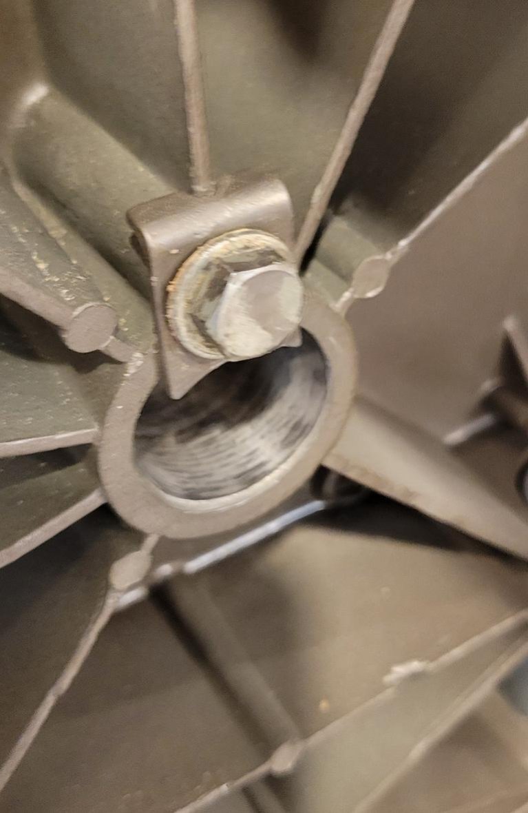

edma194 wrote: Wed Aug 28, 2024 1:31 pm Is it difficult? If it has the water pump bearing it should be held in place with a retaining clip, #31 in the diagram. I haven't replaced a lower wheel on the bandsaw but it's the same design on the strip sander that I did replace the water pump bearing on. They don't have the bearing assembly available on the current model but you can get a replacement water pump bearing and grind a flat on the shaft.
I'd love to be wrong, but posts by Nick Engler and Bill Mayo say it borders on the impossible to change the bearing:
This is clip #31

And this is the wheel, shaft, and bearing.

paulrussell wrote: Wed Aug 28, 2024 4:56 pm
I see what you mean now. Water pump bearings can't be disassembled. The shaft is the inner race. You would have to replace the entire water pump bearing. Bill also mentions problems mounting the wheel on a new water pump bearing shaft. I don't know what makes that difficult in this case as long as the shaft is aligned with wheel when it is pressed in. Possibly when the original bearing is pressed in the aluminum wheel deforms around to match the shaft and a new bearing can't be properly aligned. The bandsaw design should be more tolerant of slight misalignment than traditional bandsaws though.
How old are your different saws? There's a bandsaw serial number lookup somewhere here on the forum.
A post from Russ Chapman maybe, indicated newer bandsaws don't use the water pump bearing. The lack of resistance you feel maybe a difference in bearing types. The 'seam' you mention may just be a groove for a retaining screw, or it maybe it's a double row bearing. I'll check out the water pump bearings feel on on saws I have and let you know what I find.
Ed from Rhode Island

As for the 'seam" mentioned it has no purpose in the Bandsaw. The Main Frame Casting itself hasn't changed since the Bandsaws introduction in 1955 and none of my Bandsaws have had a set screw to retain the Lower Wheel Bearing. The retainer for the Lower Wheel Assembly has always been the clip and bolt paulrussell shows in his post.
