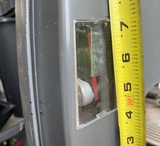

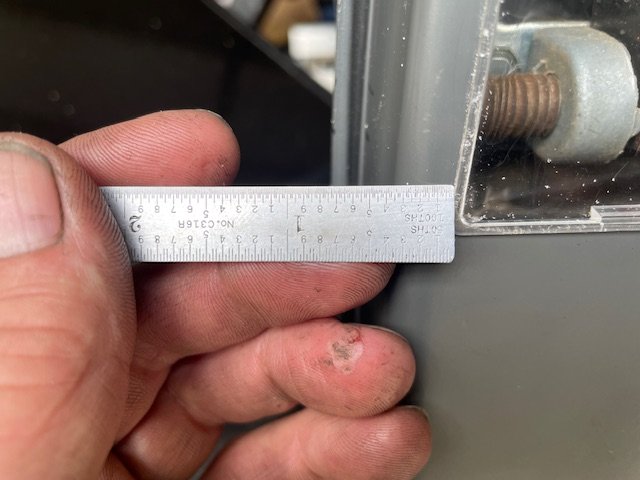

GetterDone wrote: Sat Sep 14, 2024 12:03 am Almost finished with this bandsaw update that will go with this Mark V.
I got a Plug ordered for the access hole / My idea is a MacMaster plug :cool: .
I will drill the hole once I get the plug I ordered in hand.
I plan on doing that also, Would you be ably to share any measurements for location?

AllenH wrote: Tue Sep 17, 2024 9:40 am
I have pictures I can post when I get home.
From the Cover stud below the window ,
The bottom of the window to the center of the stud is 4 inches and top of the widow is 7".
I slowly filed my way to the measurement. :D
Dwayne

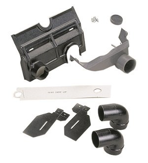

The mounting block with the dovetail grooves you asked about earlier is for the following Saw Blade Guard set. The block is where the Upper Saw Guard attaches. There were two versions with the first having a single 1-1/4" port and the second having two 2-1/2" ports. There was an upgrade kit to change the first version to the second.
Below is version one.
_
505875 V1 500 Saw Blade Guard Assembly 1980s r.jpg (102.66 KiB) Viewed 2493 times
Below is version two.
_
505875 V2 500 Saw Blade Guard Assembly.jpg (17.37 KiB) Viewed 2493 times
The following picture shows the upgrade parts that change version one to version two.
_
555294 - 505875 lower sawguard upgrade.jpg (14.68 KiB) Viewed 2493 times
This Saw Blade Guard set replaced earlier Saw Blade Guards and was the last one made for the original AKA 500 Table system.

chapmanruss wrote: Tue Sep 17, 2024 2:15 pm The mounting block with the dovetail grooves you asked about earlier is for the following Saw Blade Guard set. The block is where the Upper Saw Guard attaches. There were two versions with the first having a single 1-1/4" port and the second having two 2-1/2" ports. There was an upgrade kit to change the first version to the second.
_
_
_
I have plenty of saw guards. :D
I may have Overlooked or just do not have the other Dovetail piece that goes on the guard itself.
Thanks for the pictures. :)
I was wondering what that big guard was I have at least one of those. ;)

Post by GetterDone »

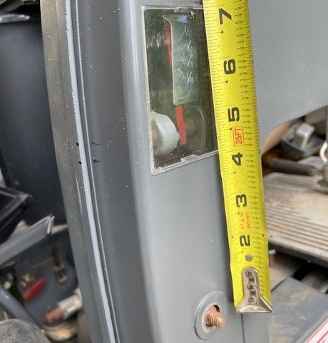

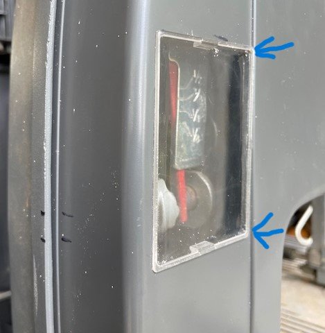

I plan on doing that also, Would you be able to share any measurements for location?
Okay here are pictures and what I plan to change on the other 3 I have. :rolleyes: :)
I like it right about 4" from the stud below this window in the picture.
You can see everything.
Depending on how tall or short :) a person is it could be adjusted a 1/4 " or so.
Here is the stud I am Referring to.

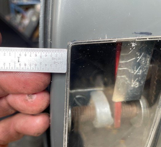

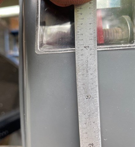

This one after a 2nd Look is 3.9".
Sorry (Not) That's the machinist in me coming out. :rolleyes:
I focus on keeping this one off the step up to the left side as you are looking at it.
I made it about 5/16" off the radius of the outside of the cover.
I done this 5/16" both top and bottom of the cover.
Here is my thing I noticed.
I keep the measurements the same on the outside and they are different on the inside.
This is just me being picky. :rolleyes:
Main thing I learned from this Project IS,
There needs to be relief filed in where the tabs are.
This cover is thicker than the clip relief distance.
I just took a File and a pocketknife to make it snap in.
Main thing I done is cut the hole small and test it for sight and fit as you go. :)
