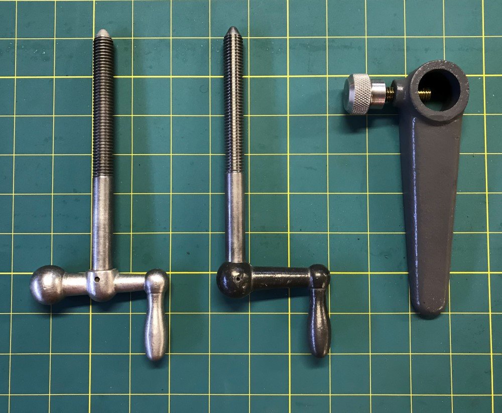

JPG wrote: Mon Sep 30, 2024 10:35 am An arm mounts to the table support leg and the screw crank presses against a depression in the other end of the arm. Yep missing a piece. Or it is hiding elsewhere.
FWIW, 8" is the original blade size.
Hiding somewhere would be a good bet in my garage! I'll have to do a dedicated search for it. Just in case I can't find it, where could I find one now? As I understand, the Shopsmith line has been purchased by a company that has discontinued support for the old machines. That is such a shame! They could sell a lot of parts to people like us.
Thanks!

The picture below shows the common Table Raising parts. There were two crank versions and the Arm JPG mentioned is shown too. The arm goes on the front Main Table Post. It is shown in place on page 6 of the Owner's Guide.

I'm going to scour my very full garage next weekend to see if I can find that table raiser arm. If it's not there, I'll have to see if I can source one somewhere. :confused:

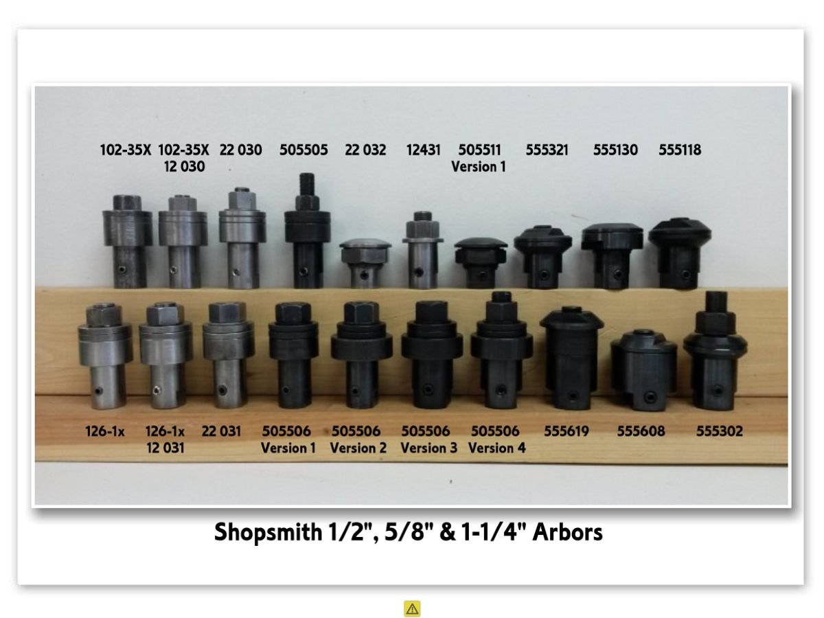

Even with around 150,000 Shopsmith Model 10's originally sold it would not be cost effective for a company to still be making replacement parts and accessories for 70 plus year old tools. The Table Riser Arm does come up for sale from time to time at online auction sites like eBay. One thing that does help is expendable items like the 3" Sanding Drum Sleeves and 12" paper for the Sanding Disk are the same size as the first ones made for the Model 10E. The Quill's Spindle has always been a 5/8" diameter reverse taper so most new accessories that attach to the Spindle can be used. As an example, I can take the Lathe Drive that came originally with my oldest Model 10E (S/N 1033) and use it on my Mark 7 and vice versa. Some current Arbors should not be used on a Model 10.
The Model 10's had 2 basic Arbors, the 5/8" and the 1/2" which were universal Arbors used for the 8" saw blades, Dado stack blades, grinding wheel, etc. It is the reason they have a machined wide spacer and two thick machined washers. The spacer and a washer are used for thin items like a saw blade and the two washers are used for wide items like a grinding wheel. The machined side of the Spacer and Washers face the item mounted on the Arbor. The current version of the 5/8" Arbor is now called the Molder/Dado Arbor. The 1/2 Arbor is now sold as the Shaper Arbor with the shaper collars instead of the spacer and 2 washers. There was a separate Shaper Spindle in the past.
The picture below shows a lot of the Arbors made over the years. The first two from the left on each row are the Arbors made for the Model 10's. The third on each row is the Arbors made for the Mark 5 beginning in 1954 and into the early 1960's. The top row is 1/2" and 1-1/4" Arbors and the bottom row is 5/8" Arbors.
_
Arbors Labeled - inc.jpg (101.71 KiB) Viewed 2158 times
This is the best picture I have for those early arbors all together. Most of those other Arbors can be used on a Model 10E or 10ER.
As for the 0.015 play in the Spindle that may be corrected, as JPG suggested, by replacing the two bearings. I would also consider replacing the two Drive Sleeve Bearings. It is possible, but not as likely, that the Spindle is bent. One of my Model 10 restorations had a bent Spindle which I replaced. Its runout was much worse.
The 3L-370 belt is skinnier than the 4L-380 normally used and would sit lower in the pulley grooves. It may slip more than the normal 4L-380 belt.

chapmanruss wrote: Tue Oct 01, 2024 1:51 pm ................As for the 0.015 play in the Spindle that may be corrected, as JPG suggested, by replacing the two bearings. I would also consider replacing the two Drive Sleeve Bearings. It is possible, but not as likely, that the Spindle is bent. One of my Model 10 restorations had a bent Spindle which I replaced. Its runout was much worse.............
I was under the impression that these older machines had only one spindle bearing. If I've got two, that's twice as good! ;) Where could a person get new bearings, and is there a video that shows how to replace them?
Where are the drive sleeve bearings in the machine? If they're in the drawings and parts lists in the Owner's Manual, I've missed them.
