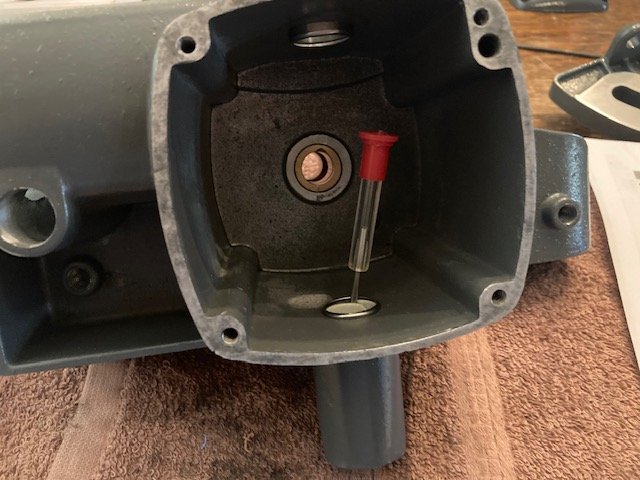

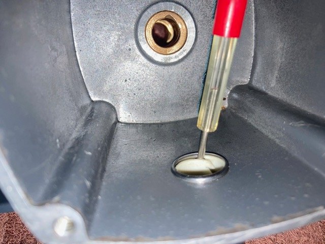

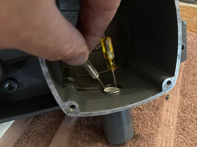

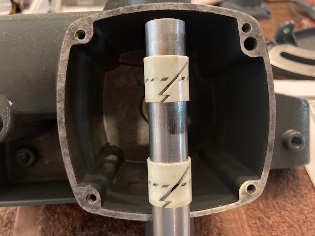

Here's some pictures of removal of the inner plastic or nylon inner sleeves. I used a couple of small eyeglass screw drivers to get behind the plastic sleeve then used a pair of needle nose pliers to grab onto the edge of the sleeve to remove it from the bushing. It might be helpful to use two pairs of needle nose pliers because if you have to reposition your grip with one pair the sleeve has a tendency to snap back into position in the bushing.
- positioning of screw driver behind inner sleeve
- Jig Saw 1.jpg (66.77 KiB) Viewed 5839 times
- Close up

- Using two screw drivers

- picture of plastic inner sleeve removed from bushings
