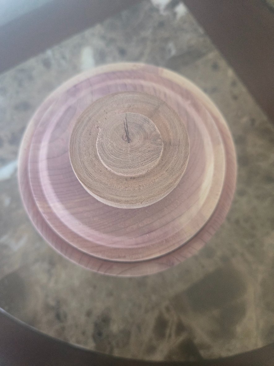

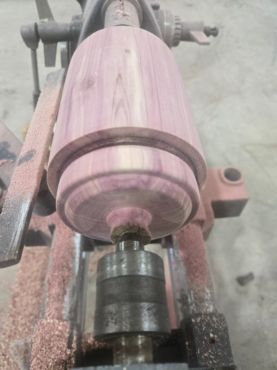

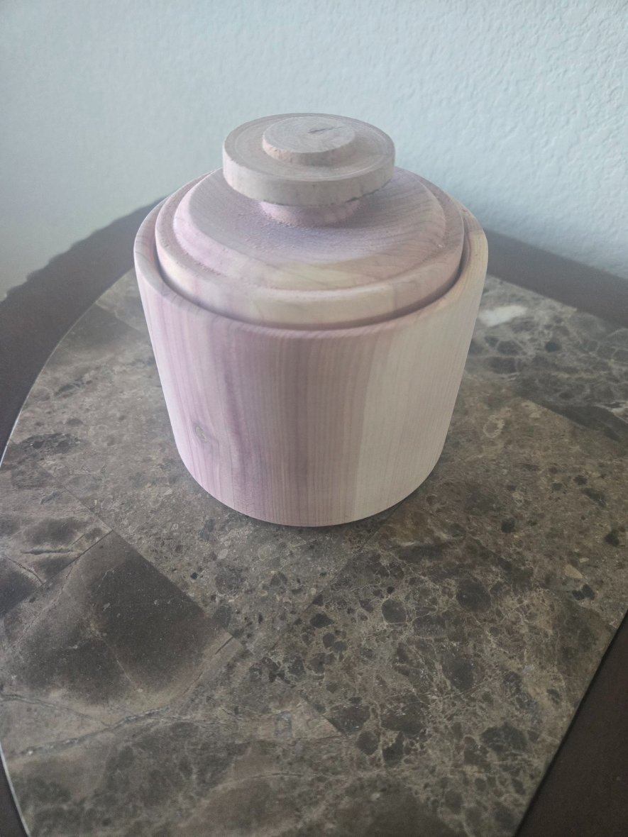

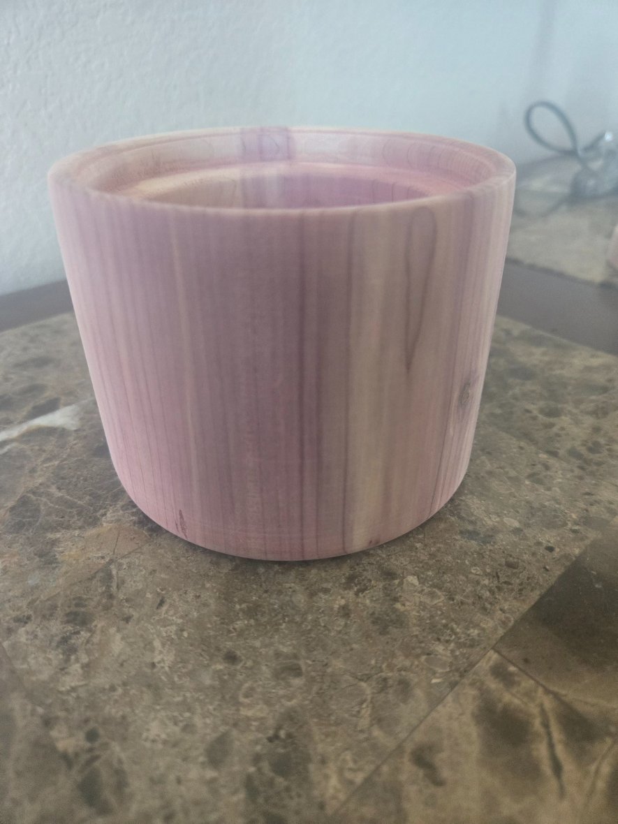

Project #2 cedar round bowl with drop-in lid (no tenon). Made this for Mrs.B. Still needs some sanding work and stain. It's amazing how 6 hours in the shop can whiz by!

Very nice ! That material looks like what we in the PNW would call "Tennessee Cedar" or "Aromatic Cedar", to distinguish from Western Red Cedar. Will look great when you oil it..

I just stained it. Boy, what a difference.

It does look really good; you did a nice job turning it.

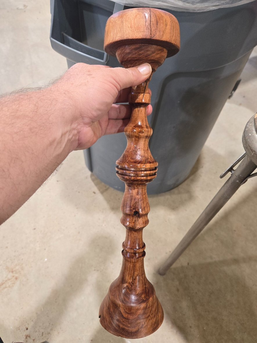

Latest project: Tabletop Hat Rest (cowboy hats, fedora, wigs etc)
Made from a trunk of mesquite tree on my land. Sanded out to 600 and stained with natural colored high gloss sealer...
