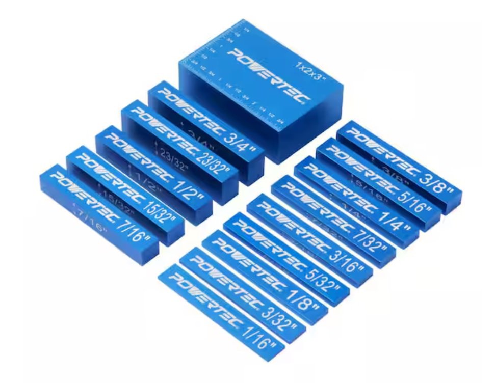

P.S. Whenever a known standard is available, I am going to use it. There are even purpose built standards for woodworking, often called "setup blocks". I use these in my shop often and this is the set that I have:

Nice set of blocks. How much did they set you back?

Re: ZCI material
Post by RFGuy »
dusty wrote: Tue Dec 10, 2024 7:04 am Nice set of blocks. How much did they set you back?
Dusty,
Thanks. It was around $100 for this Veritas set, but there are cheaper sets on the market. I just really like Veritas & Lee Valley tools. I don't have many of them, but those that I do, I love to use them in the shop. There is a very similar set that Home Depot has for around $50 shown below:
https://www.homedepot.com/p/POWERTEC-15 ... 49pZyOwZfc
📶RF Guy
