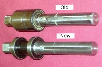

Due to the changes to the Eccentric Bushing over the years a new one is included with the new Idler Shaft Assembly in the upgrade kit. Some of the older Eccentric Bushings will not work with the newer Idler Shaft Bearing arrangement.

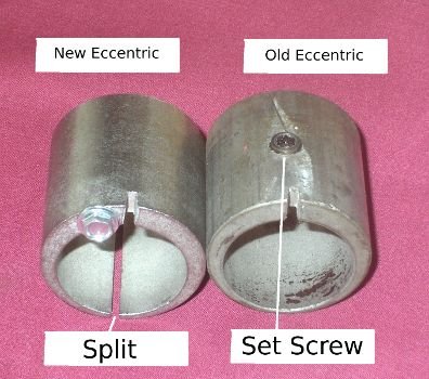

All of those eccentrics that do not have the 'split' feature. But the spit eccentric, IIUC, has been around much longer than the 'new' (non- water pump bearing) Idler shaft bearings.
The 'old' SS web site had a very clear explanation of this with pictures. I can't find that now on the new web site. In essence the split eccentric will work on any Idler but the new Idler bearings require it. All PowerPros require a split eccentric because all PowerPro Idlers lack the sealed water pump bearing.
If the OP has an eccentric with the split, my advice would be to ask SS to ship your kit short this part unless the have a good ship date.

Posts: 4209
Re: DIY PowerPro Upgrade Kit SKU: 557002
For reference the picture below shows the main difference between the new and old Idler Shafts and Bearing(s).
_

The Eccentrics below show the new/current split type and one of the old type Eccentrics.
_
eccentric old and new.jpg (35.2 KiB) Viewed 2349 times
There have been some variations to the Eccentrics over the years.
All SPT's & 2 Power Stations
