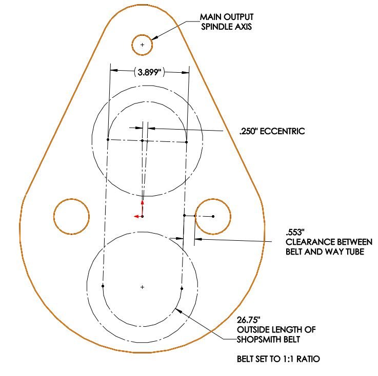

I still cannot see how, even in the worst case, that a Shopsmith Mark V drive belt could contact a way tube.
Even when the eccentric is set to the 3 or 9 o'clock positions, the closest the belt comes to the way tube is 1/2".
Could the motor mounting position be off?

Re: Belt hitting way tube
I agree, I'm sure that the engineers designed the machine so that in the worst case the drive belt would not contact the way tubes. My eccentric is positioned close to worst case, which I suspect is also pretty close to nominal, and I measured ~3/32" clearance. So the first difference I see between my machine and your model is I measured at speed "R" and you are modeling two speeds, very fast and very slow. So I measured again at the Slow stop and clearance was ~11/32". I have no reason to think "R" is the worst case speed for belt proximity to way tubes, but it is ~1/4" worse than Slow. My untested hypothesis is that worst case speed occurs when the belt is vertical, I think that is around "L".SteveMaryland wrote: Tue Dec 31, 2024 3:02 pm I still cannot see how, even in the worst case, that a Shopsmith Mark V drive belt could contact a way tube.
Conclusions from that: 1) Speed matters, so real world worst case is different than the model shown. 2) Besides speed, there is an unexplained difference of about 5/32" between my machine and your model at Slow. 3) There is an unexplained difference of about 3/32" (or more) between my machine and the OP's machine.
Looking at your earlier images I am suspicious of your motor mounting location. If the sheaves are all properly positioned there is no way that the belt can contact the Ways.

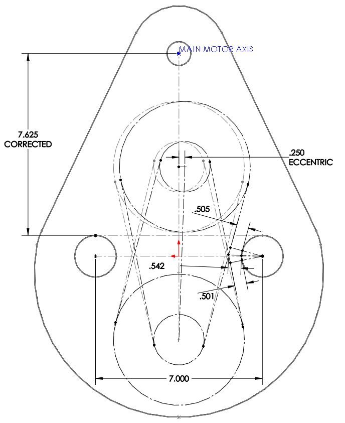

Let's look at the belt position when the sheave ratio is 1:1 (the "mid-range" speed):
The above layout shows the Shopsmith at the midrange speed + we have added the eccentric effect. Still looks like we have at least half an inch of clearance.
If the belt were too long, this would result in the belt coming closer to the way tubes - at all speeds. I think the OP's belt is stretched, plus the OP's pictures show the belt riding above the sheave OD. Those things, plus some slop in the motor mounting location - these might account for some of it. And maybe we are seeing evidence of some small (unintentional) unit-to-unit mfg variations in Mark V's over the years.
