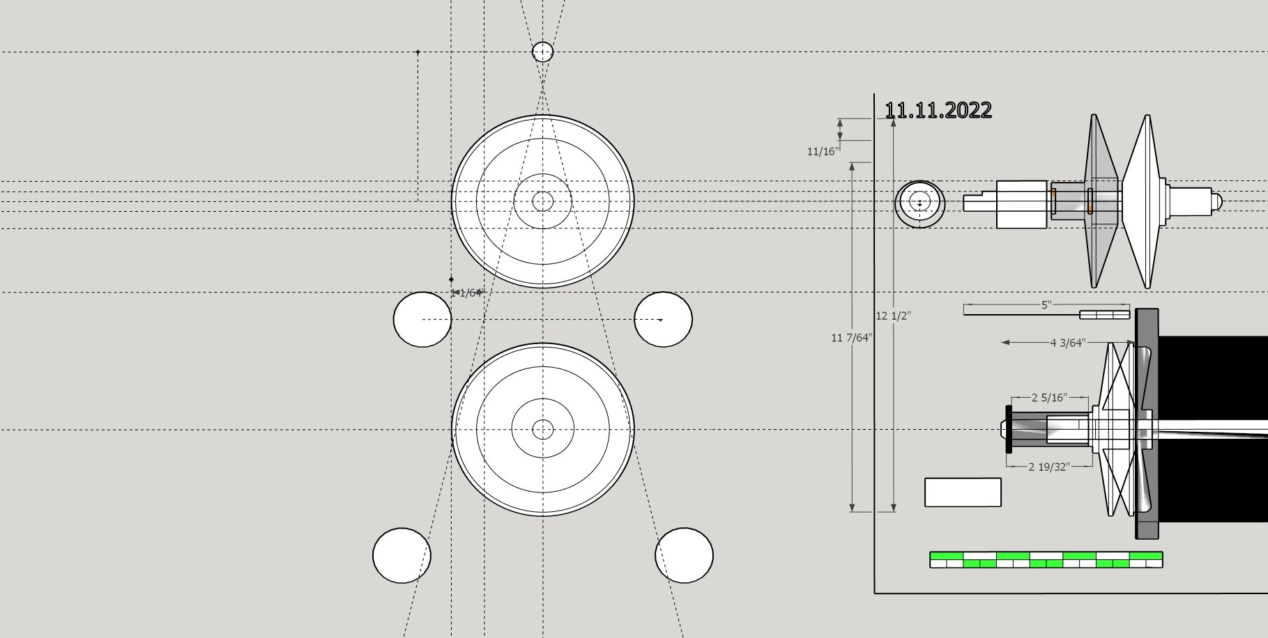

I am unable (at this moment) to do this in the shop (on a machine) but I have modeled this in Sketchup,
Using the Sketchup model I I can see that if the drive belt does not move properly (smoothly and equally) within the sheaves during speed change the belt could certainly rub the tubes but NOT on a proper;y assembled and operating machine.
I'll work on this some more and maybe I can get a sketchup model to work here on the forum.

Re: Belt hitting way tube
This has been interesting for me. Just wish I could get hands on the machine in question.
After dwelling on the issue (using a Sketchup model) I can see only one possible cause (assuming the machine is assembled properly).
TYhe second image in this thread got me thinking about this. I conclude from the image that the machine is at high speed (belt position in motor sheave). Then looking at Idler Sheave. Belt appears to be too high in the sheave.
If the idler sheave was not closing properly causing the belt to ride too high in the sheave with respect to where the belt is in the motor sheave the belt would be closer to the way tube than it should be.
Just my two pennies worth. Thanks for the challenge.

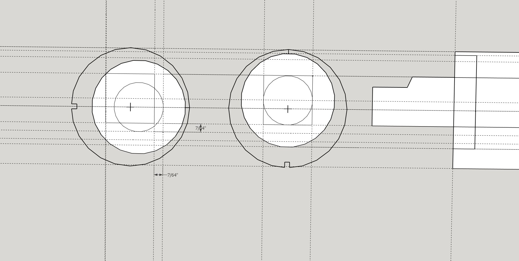

I have modeled the shafts, sheaves and tubes and I find thart my resulting dimensions are very very close to your measurements (stated in this thread). My model depicts the 3 shafts in question as being aligned on the vertical plane (center of rotation of the upper shaft). The differences that I see would not create the problem that we are discussing.
What I wish I had was clarification of where a plumb bob dropped off the rear edge of the idler sheave would be with respect to the inside circumference of the upper, rear way tube.
IIdler Shadt Bearings Eccentric.jpg (148.42 KiB) Viewed 4313 times
Sheave and Tube Relastionship.jpg (160.45 KiB) Viewed 4313 times
